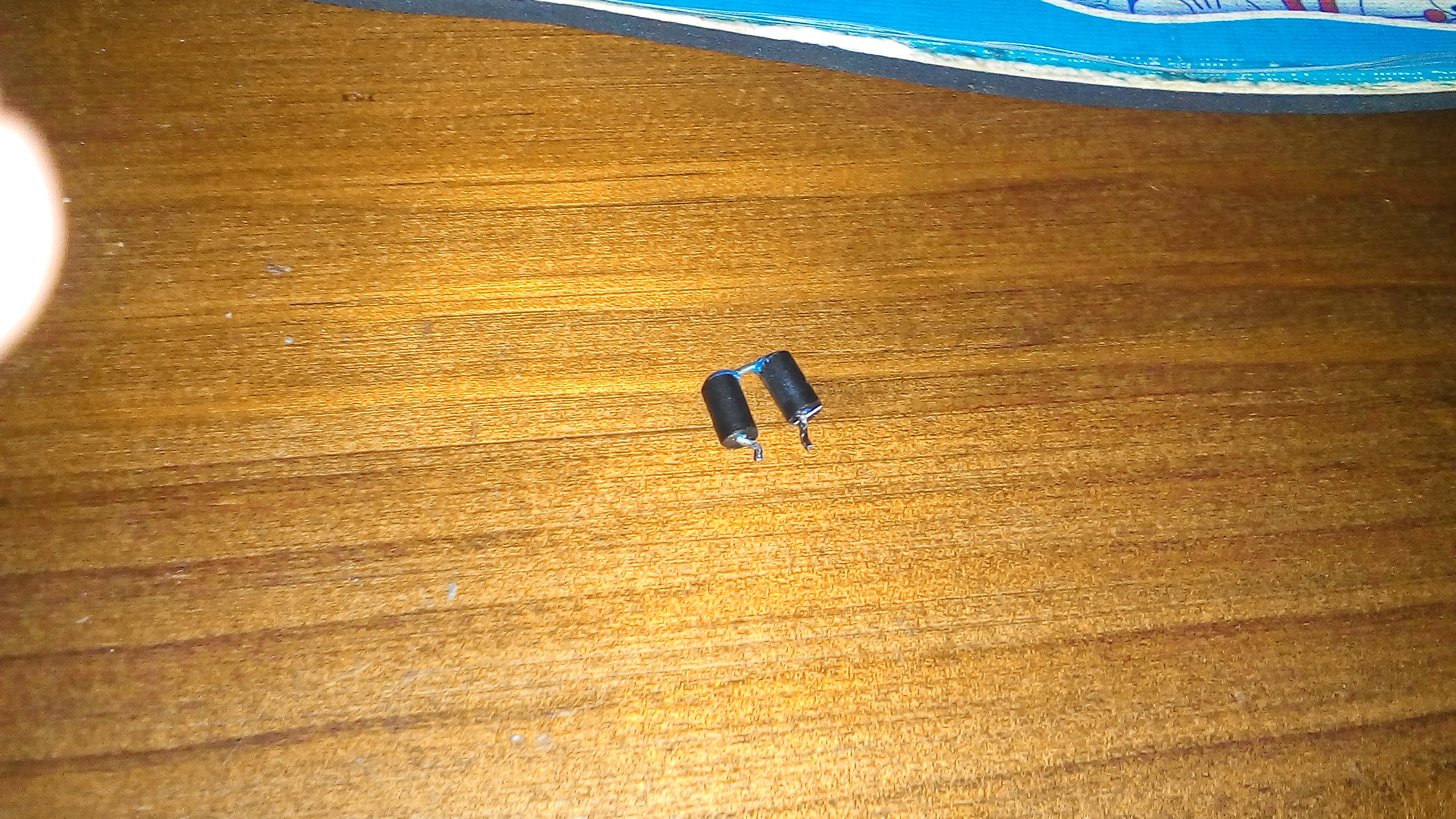

    What device is it ?
    Everyone,
    I'm wondering,
    What device is it ?
    Please have a look on the photo.
    On my meter it's 0.31 ohm...
    Is it a balun or miliohm resistor ?
    Re: What device is it ?
    Just a very small inductor made by putting the wire through two FERRITE beads.
      ferrite bead core, ok, thanks, similar like on power supply charger bead...
