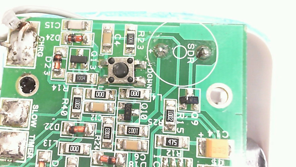

help needed to identify this part
  • tonytiger
    • Jan 2010
    • 163
    • canada

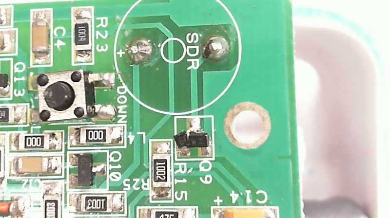

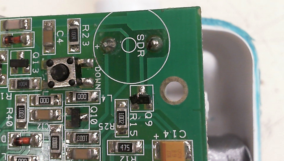

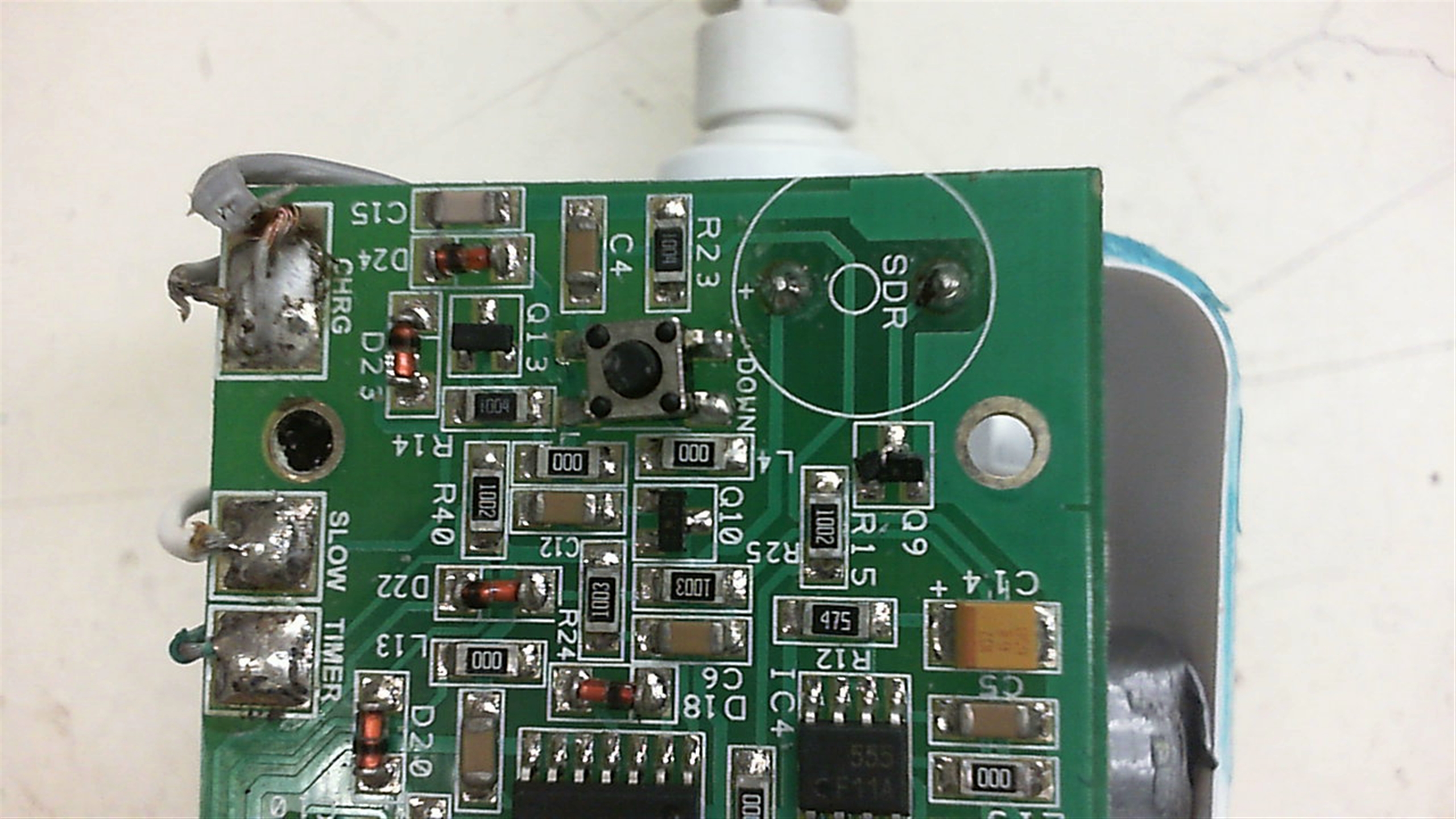

    it is on a bathmaster hand remote 2006 ver 3c
    this part was burn when my small pico fuse burn...
    it is located q9 and these are the best photo i did before loosing top part.

    Re: help needed to identify this part
    It could be a BC817-40W, Marking 6C (W) = made in China. 45V NPN SMALL SIGNAL TRANSISTOR IN SOT323
    Looks like the same markings as Q10
    Digikey http://www.digikey.com/product-searc...=0&pageSize=25
      • 31278
      all it drives is a buzzer,
      either the buzzer is shorted or the transistor is not up to the job.
