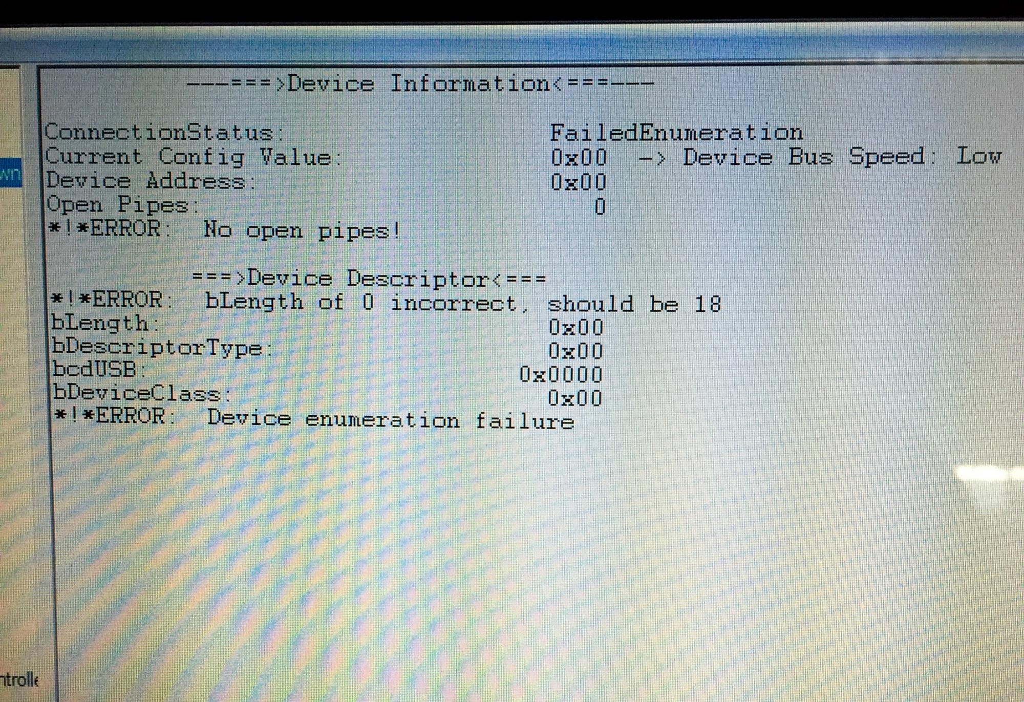

        I used a program called UVCView and got this information
          • 31007
          Re: Which ic generally used for software updates?
          is it giving a vid & pid to the o.s.?
          • caphair
            • Nov 2011
            • 1249
            Shows 0000 for both pid and vid. What are those anyway?
              • 31007
              vid = vendor ID, pid = product ID
              those 2 numbers tell the o.s. what it is, and what driver to use.

                  Thanks actually used that same link to try getting into DFU. It blinks as it should but computer/iTunes still doesn't recognize it.
                  Even tried changing the driver to an Apple DFU one when the Apple TV is plugged in and still nothing.
                  Does this mean the ic responsible for all that info is bad?
                    • 31007
                    well the fact that it responds at all means the cpu is at least partly working.
                    maybe the vid & pid are stored in an eeprom.
                    try looking for a schematic.
