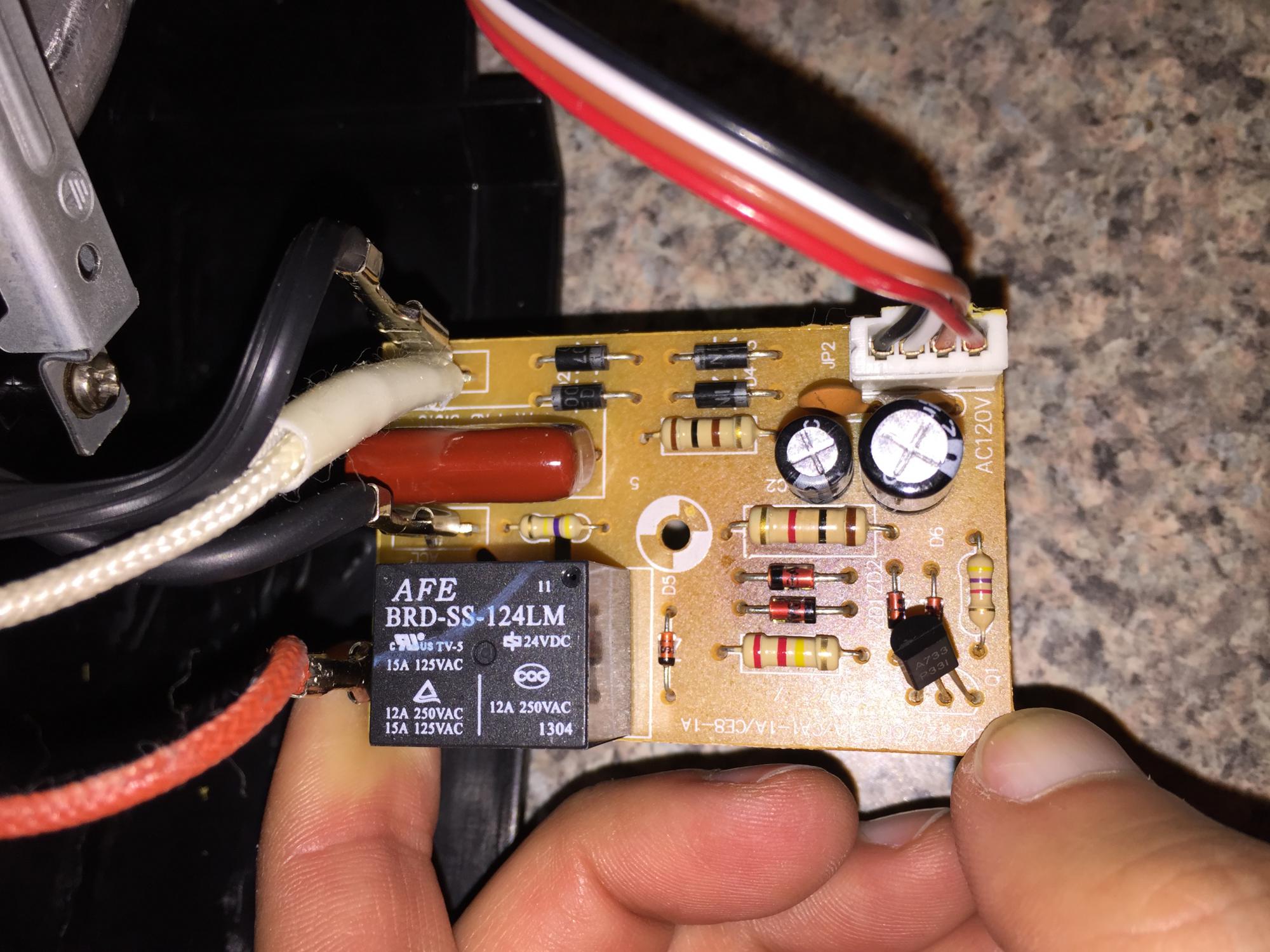

    So the transistor that drive the relay has 1V feeding the Base of the transistor, so you do have 0.6~0.7VDC between the Base and Emitter legs of the transistor? How is the relay coil connected to the Transistor and the Voltage source (VCC) for the relay coil?
    Pictures of the board and transistor/relay section?

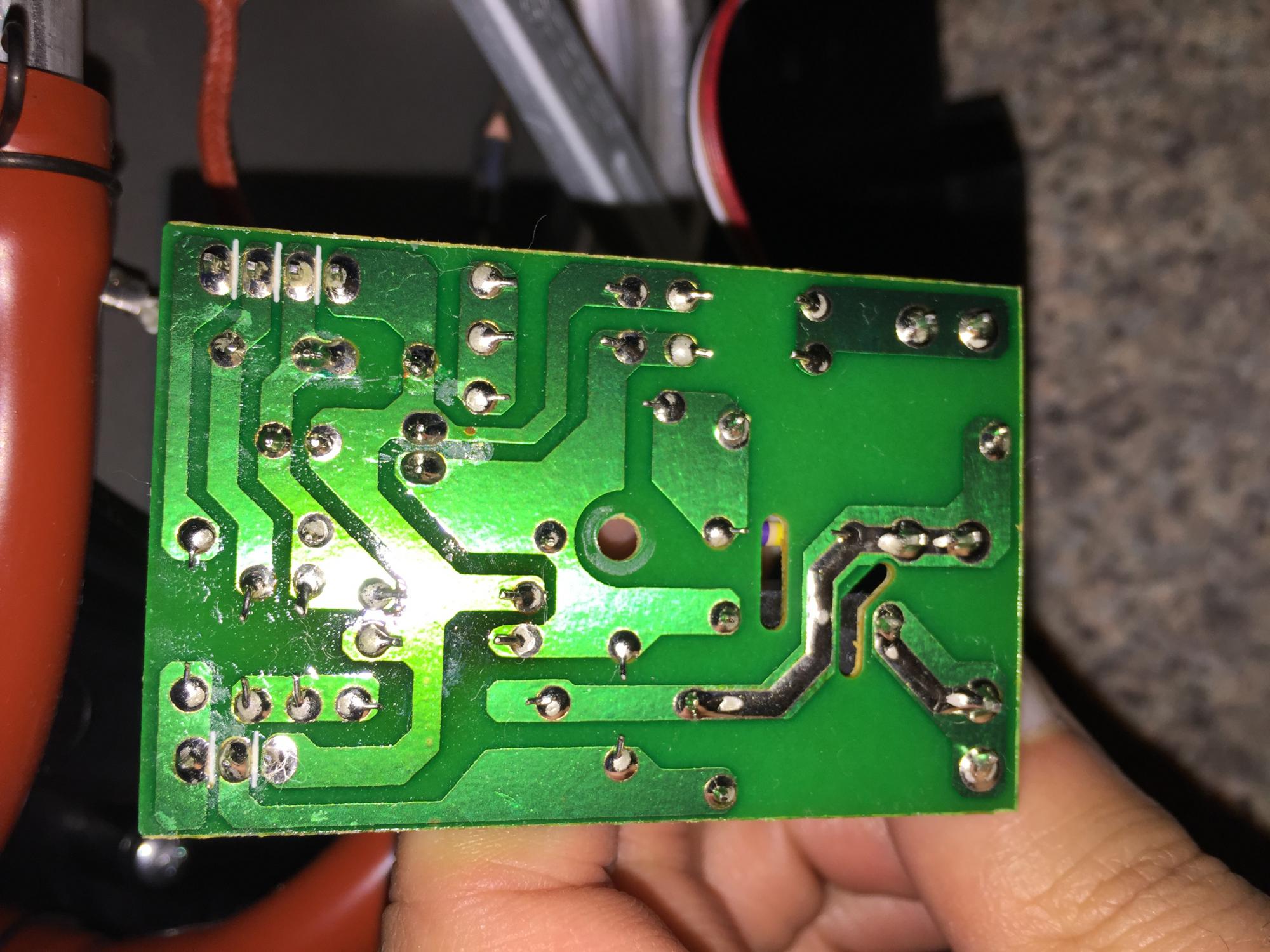

          Here's a pic of the power section. Unfortunately don't have access to a computer and my phone only uploads one pic at a time so excuse my posts just for pics
          • caphair
            • Nov 2011
            • 1249
            Re: Couple questions about a Coffe Maker - No Power
            The top side
              • 31044
              resolder that 4pin connector.
                Not just that. Look at the solder joints for the two zener diodes (ZD1 and ZD2) too - they look quite bad. And that's not surprising, because you can see they darkened the board a little. It's possible that the film cap could have gone leaky, letting more current in that necessary. Therefore, I would suggest to check all diodes for short-circuit and check all resistors for open-circuit. Those (probably no-name) electrolytic caps could be letting too much ripple too, if they have gone high-ESR or O/C.
                  Yes those two zener diodes did darken the board around them. They tested fine in circuit, but one of the mains diodes outputs the low voltage 1.52v leading to the microcontroller VDD. I'm guessing this board uses zeners as voltage regulators?
                    ZD2 regulates the supply for the microcontroller. I believe you should measure 5V across it.
                    ZD1 is the 24V supply for the relay.
                    I will upload a circuit diagram if you can first measure the resistors.
                      All of the resistors? Btw I measure 28v at ZD1 and 1.52 at ZD2
                          Actually the resistor above ZD2 with color band of 1k measures open in circuit
                            That 1K resistor must be the culprit.
