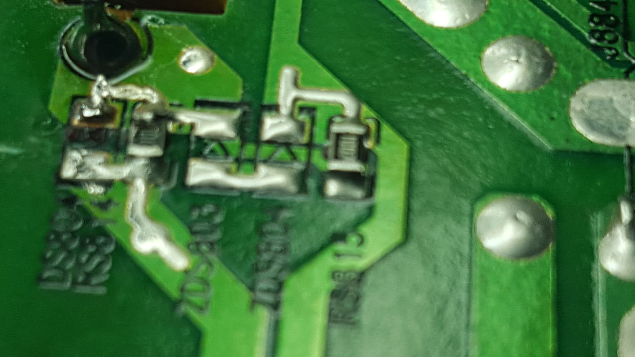

    I have a power supply repair kit to install today, i can do the IC and the mosfets no problem but im trying to sus out which way round the diodes go in place (1SS355)
    these are very small and even under my magnifying glass i cant see any writing on them to show which way round they go..
    any help wiht this would be great .

    Use your meter.

      i can do that but which round does it go on the board as it looks like the marks hace gone ... here is a pic

        diodes are facing up in the foto - anode down, cathode up.
