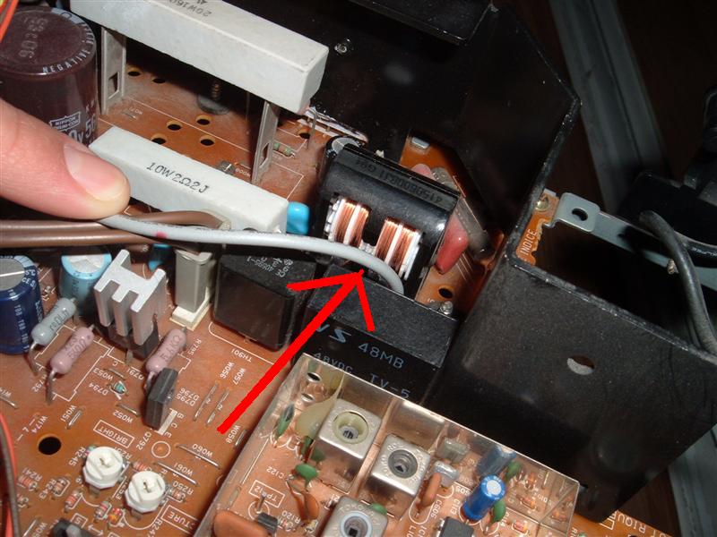

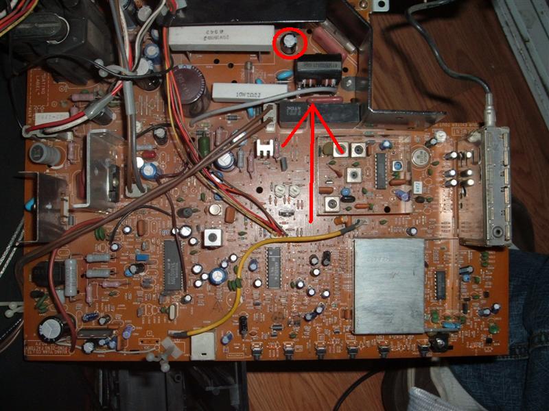

    Someone gave me a very nice 1989 20" JVC TV a month ago. It's a very nice little set, the picture tube is very strong and the picture quality is amazing. Beats the living shit out of any tube TV you can buy nowadays, hard to believe it's still banging out great PQ after almost 20 years.
    Anyway, when I was given this TV, it worked but it was making a very, very loud buzzing sound whenever it was on, it sounded like a small electric motor. Turns out it was a bad cap that was making a relay buzz like that. I swapped it and now the TV works great.
    This TV is loaded with quality lytics, some Rubycon and Chemicon. However, after 20 years the lytics aren't doing so great. The screen regulation is terrible, bright objects bulge out and distort the rest of the picture. I want to swap out all the lytics in there (there aren't many), so I have 2 questions:
    Should I only swap lytics with vents, or can the little ones go bad after 20 years too?
    and
    Can you guys recommend the best Panasonic series for this?
    Pics of TV and chassis attached. The red arrow on the third pic shows the relay that was buzzing (the arrow is a little off, it's the relay marked 48MB).

        Well red does seem a little oversaturated, but it's definitely not that. A commercial for Gamefly that used to play pretty often showed an LCD screen displaying it's website as part of the commercial. The border on the LCD bulged a ton, instead of being straight it bulged out in about 5 different spots. I'll open the set and get the list of large lytics in there.
        I have an ESR/Capacitance meter but I'd rather just swap all the caps, breathe some new life into the set. It's very sturdy and well made, I'm sure with new caps I could get a few more years out of it.

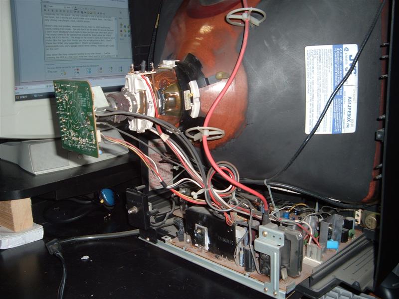

        Anyone know if the tube in it was actually made by JVC or was it rebadged? This is the only JVC I've seen with a JVC tube in it. The other two JVC's I saw had Hitachi and RCA tubes in them.
        Set was made in USA, July 1989
