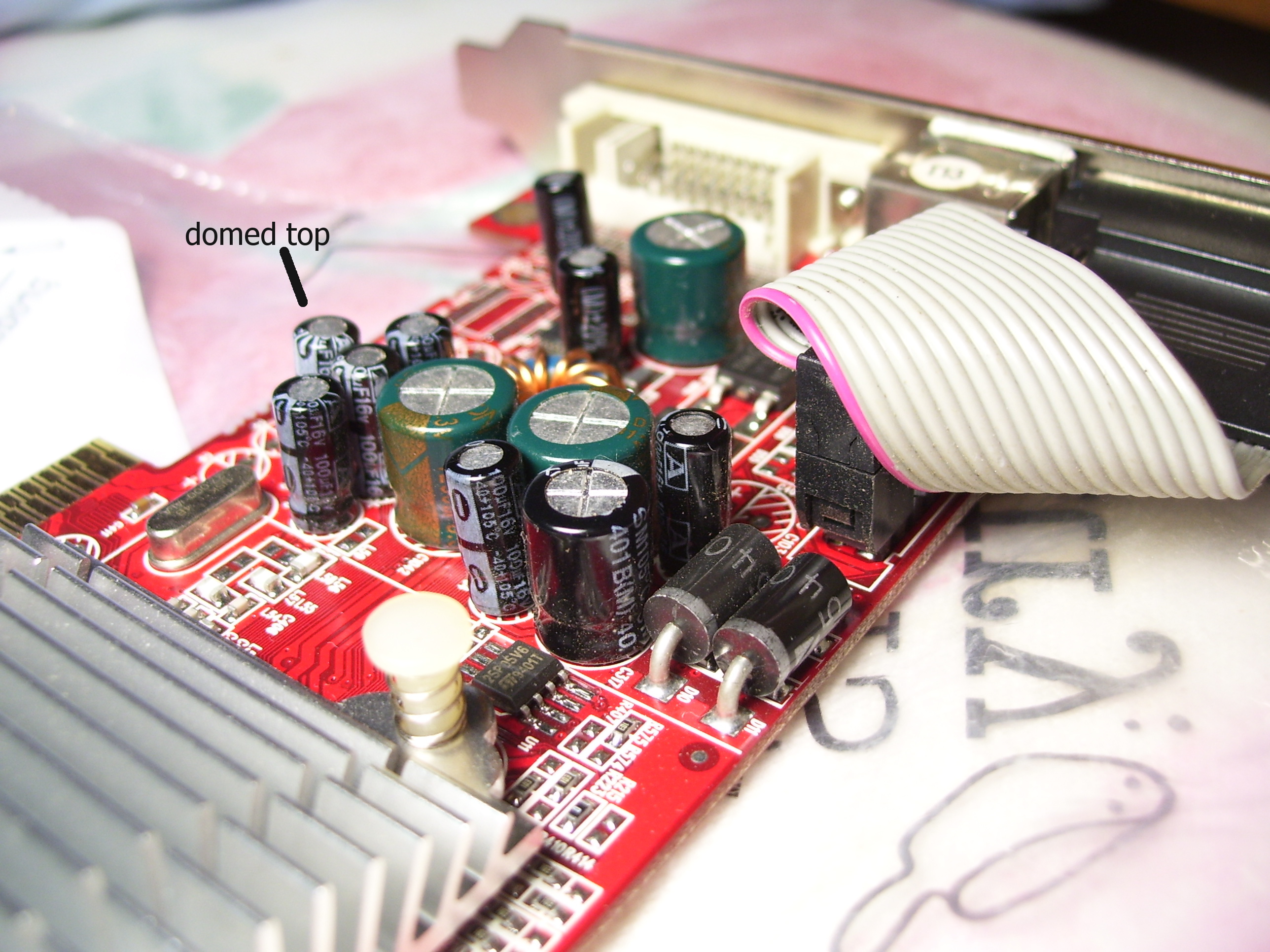

    Got an AGP card that just started ghosting on the boot screens.
    On the card is 8 100uf 16v 5mmX10mm aluminium electrolytic caps.
    They appear to be Ark caps (after looking up the symbol A that is printed on the caps)
    One of them is definitely bulging on the top, and another has a dent in the top.
    There is no marking for series except for perhaps (M)
    What would be a suitable replacement for these?

    Re: ATI R9600L cap ID
    got a foto?
      https://www.badcaps.net/forum/attach...1&d=1431898864
        Here is their site:
        http://www.arktwn.com.tw/table.htm
        But I wouldn't worry about the series. Just replace all the caps on the card.
        For the three big green G-Luxon 6.3V 1200uF caps, use Nichicon HM/HN/HZ class capacitors. I can't identify the value on the 8mm black cap, but that should also be Ultra-Low ESR.
        For the 5x10 caps, use Nichicon PW class or better.
          Thankyou,
          Will use Rubycon ZLH for the 5X10 caps, and update thread with result when done.
            The 8mm black cap is a General purpose G-Luxon SM 470uf 16v, rated at 315mA ripple.
            What would be the best replacement? :
            Nichicon HN rated at 1800mA
            Rubycon ZLJ rated at 1200mA
            ZLH rated at 945mA
            or
            should i look for something nearer to 315mA, and if so, why?
              ZLH should be enough. The others might be too low ESR and disrupt the functionality of the circuit in some way, although that's not very likely.
              The higher the ripple current, the better. It's ESR that needs to be somewhat matched, but variations of +/-50% are perfectly acceptable for ESR as well.
