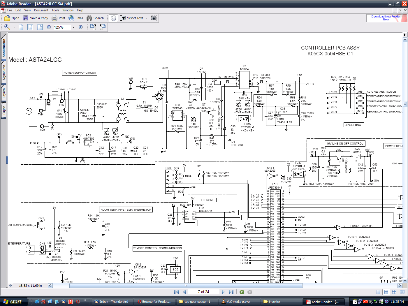

    Hi all.
    I'm going above and beyond here to help a guy out.
    I work in a/c where the usual tech just replaces the whole circuit boards if anything goes wrong. Thanks to sites like this I'm trying to learn electronics to get the things fixed on site and straight away, and at the same time save them some cash.
    I met this awesome guy today, he's an 82 yo pensioner now, and used to be an electronics specialist himself.
    boring background:
    His background story is growing up in lithuania, learning electronics in hamburg germany before ww2, moving to australia working in radio and film. Then he started a current major home/car hifi chain here in perth australia which still is big today. But he sold it 30+ years ago when it was clear people wanted retail cheap new stuff, rather than using his knowledge to build/repair.
    After selling that he spent 20 years working for the railways in the U.S. and canada, before coming back here to retire.
    Anyway, my situation is here we get a lot of power surges, normally that means a blown fuse and varistor. But in this case the main capacitor had blown as well. It was a rubicon 100uF, 450V.
    I'm trying to help this guy out and fix it cheaply, but I'm quite the amateur in electronics and don't know quite what this capacitor does. I assume it's to smooth it out prior to the recifier, but I can't even see it on the diagram.
    Anyone good at tracking down a components purpose or what the decent replacement parts are, because I couldn't find an identicle part from my retailers either.

    Most probably it's C6 (right behind the bridge rectifier). Looks like someone else didn't strictly go with the specs before and used a lower value.
    If you have access to the underside of the PCB, that should be quite easy to verify.
    Replacing it with a cap with the intended 150µ (or even higher) won't hurt, and if you have lots of power surges as you say, you should stick with a 400 or 450V type.
    I guess I don't have to say much about the brand....

      Thanks, it makes sense that this capacitor is across the DC side of the bridge rectifier, so I guess thats the one.
      Though I do wonder why theyv'e used a 100uF when their specs are 150uF.
      I'll keep my eye out on any others I come across to see if they're all 100uF. Maybe they've changed from the specs on purpose for this country.
      I guess it's another bunch of parts to buy out of my own pocket to carry around just so I can do this job. I might grab a few 4A 600V bridge rectifiers too.
      Ordering parts like whole new PCBs takes 2-3 weeks, then it's a struggle to book them in again with new jobs coming in everyday that demand attention.
      It costs too much capital to carry PCBs when there's so many models and they constantly change. But at the same time it sucks to tell people they've got to wait 3-4 weeks, and with this being summer and holiday season down here, the wait could be longer.
      This is why I'm learning electronics and buying the parts out of my own pocket. To get the jobs done first time and not have to book them back in with a rip-off PCB change ($200-500) weeks later.

        If that diagram is of the circuit you got
        its a switcher psu of some type description and if the 100 uf 450 Volt cap blew.
        I would go along with kikkoman its probably C6. (regardless of what the schematic says value wise)
        As to why it maybe 100 uf rather the 150uf, the tolerance capacitance wise is like 50 % (if I remember correctly, might be 20%)
        So its a wide margin...voltage wise it will have about *320V DC across it so you couldn't use a 315 Volt (ditto what he said above 450V in your case)
        (*direct rectification of the mains voltage 1.414 X 230Vac nom, less Voltage drops across other components on the mains side, like diode drops etc)
        A 100 or 150uf (or a bit more) 450V is what I would put it that position for mains in OZ,
        WA use to have higher voltages in reality then east coast not sure if this still applies ...it was nominal 240VAC but we have now reduced to 230AC inline with the rest of the world that runs at that mains voltage.
        (so maybe the regulation is tighter now, I don't know)
        if mains transits are a problem I would possibly look into beefing up the components used in the front end and possibly more protection of some kind
        I would use a 1000 PIV bridge myself

          yeah, the lowest I've seen our mains in 237Vac, a lot of places have 250vac mains, most still have 240vac on average, we haven't dropped to the standard.
          In a way I'm glad, there would be more problems with a 230V supply here, when there's some dodgy electricians running an undersized cable 20m so there's already a 10Vac drop.
          I already do a fair bit of refurbishment for older stuff, this is my first inverter a/c electronics repair. Most inverters are still under 5 y/o, so still under warranty and I don't have to worry about them so much, hence I don't have any spares or parts scavenged. When repairs are done in warranty, all defective boards must be sent back to the manufacturer, or you don't get paid anything.
          So I've got no inverter boards to look at or scavenge from.
          Because of the voltage rating of this cap, and what kikkoman said, that's when I realised that c6 must be the blown cap myself, because of where it is.
          This being an inverter system, the mains would be recified at 320Vdc to power the whole system.
