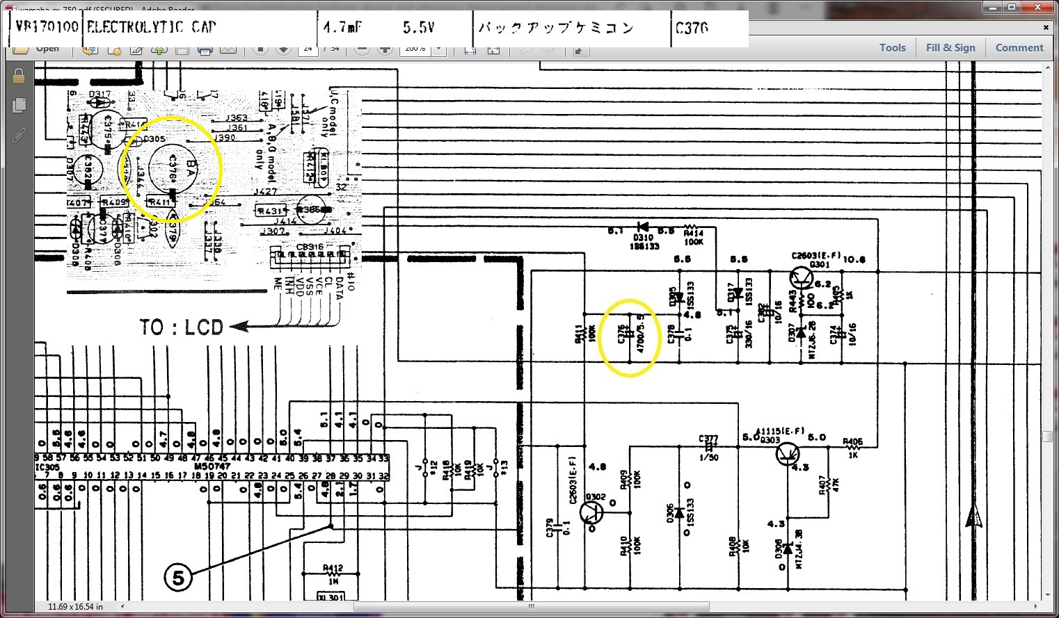

    rx-750 pioneer stereo memory
    I have rx-750 pioneer stereo and the stored radio stations in the memory does not stay in the memory very long.
    Does anyone know where the memory is located in this stereo and how it is powered up?
    It does not have a battery backup.
    Does the memory use a capacitor for its power supply?
    thank you

      How long does it hold its memory, how long is not very long? if its less than a couple weeks then try replacing C376

          memory loss is overnight
          thank you for your help
          terrible schematic
          but it will help

            I can't seem to find C376
            on the schematic
            or on the parts list
