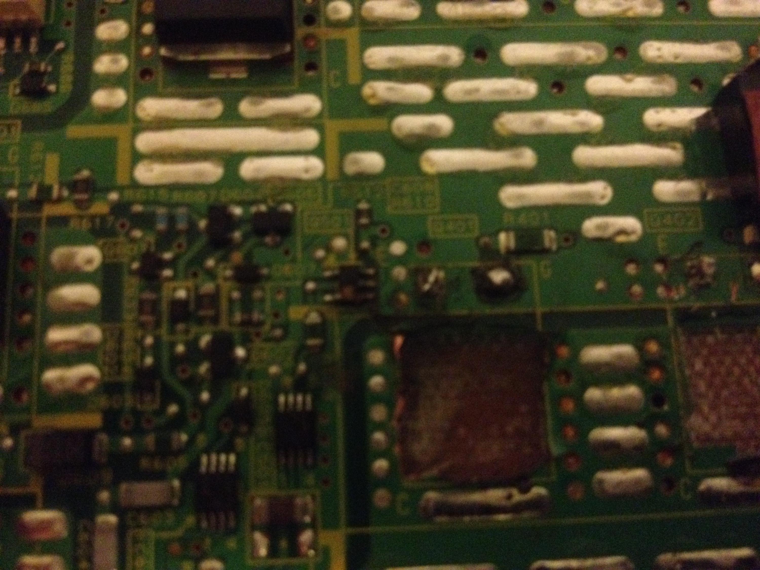

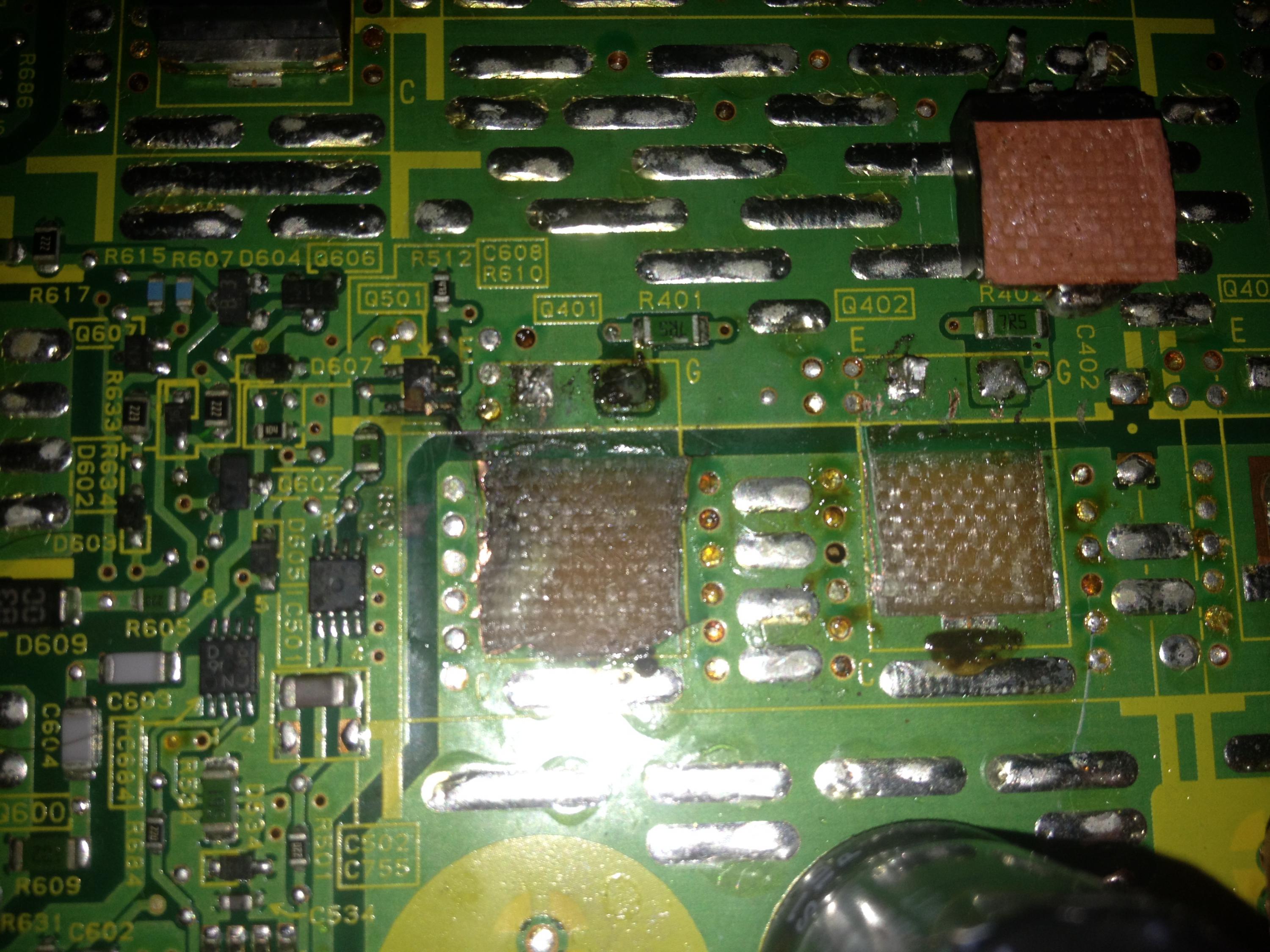

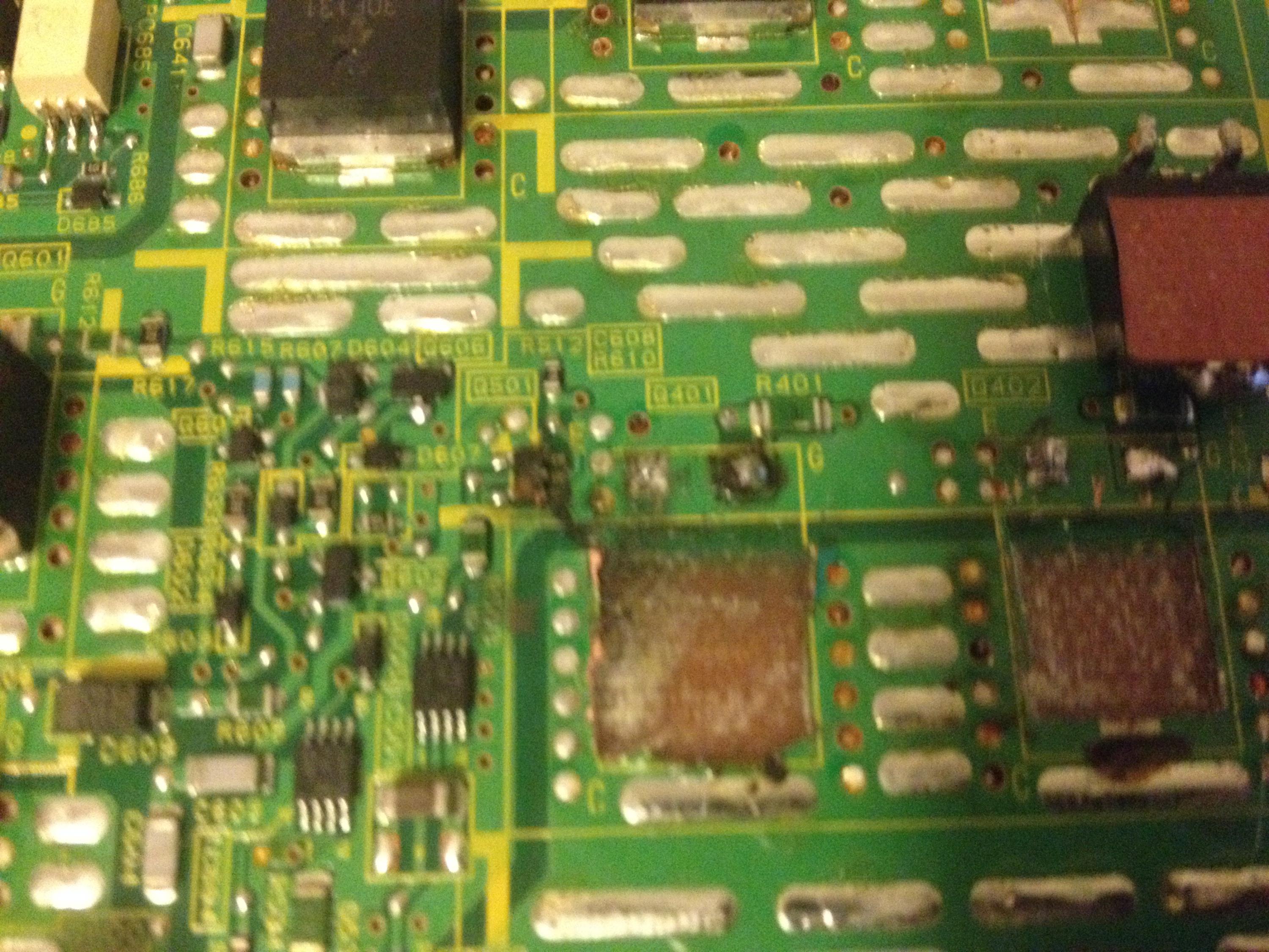

    Newbie here. I'm trying to replace some transistors on a tv and now that I have them off I think I have made a huge mistake.
    I was thinking the solder strip along the top of the transistor was the point these would seat on but now I see that there's a pad on the bottom.
    Game over?

    Oh what a mistake
    I I were you I would try to find 1mm thick copper and solder it in place of missing pad, and then you can solder those transistors back
    Traces of Q501 are OK?

      Re: Game over?
      That's actually exactly what i did! I'll upload some picks when i get a chance.
      Trying to debug other areas atm.
      Thanks for the advice!
        I'm interested in seeing that!
        Don't worry, we all have pulled up traces/pads on numerous occasions before!
