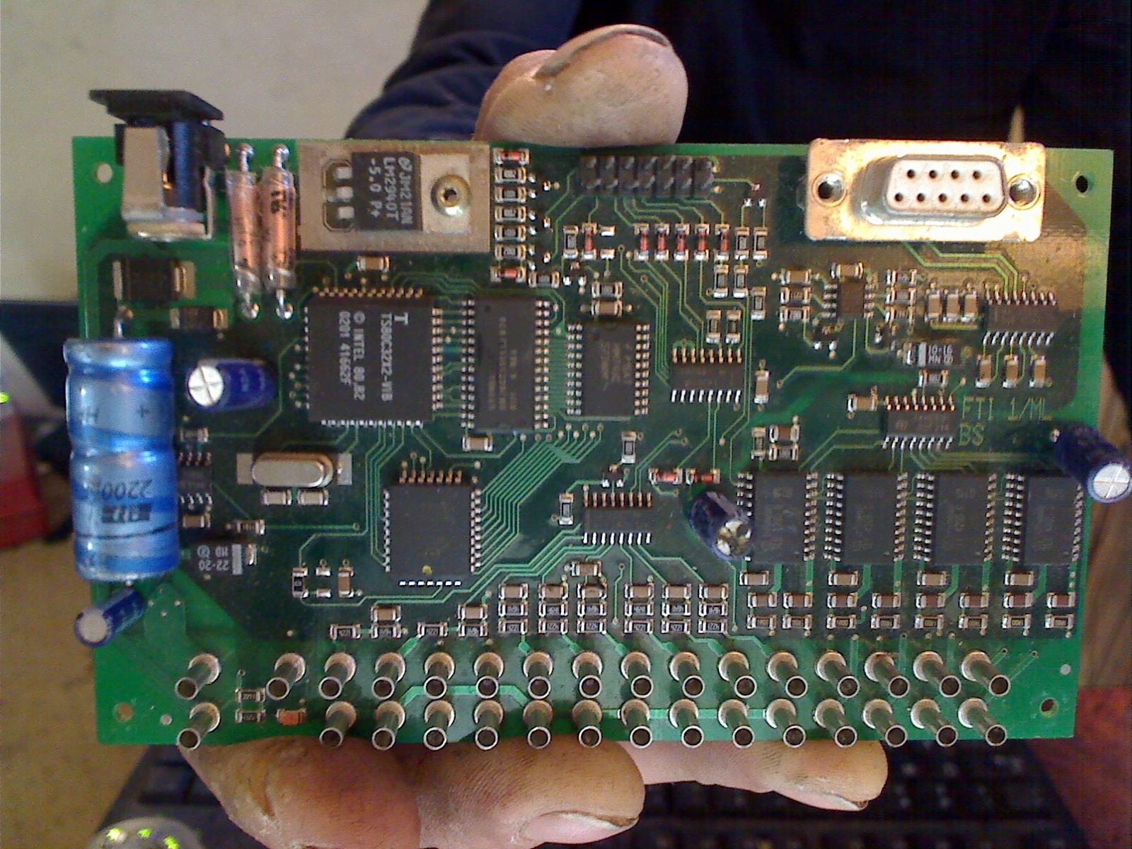

Can Someone help me id this board
  • Cass Neal
    • May 2014
    • 7
    • usa
    there is very little written on the board if you need more info or pictures I will post them.

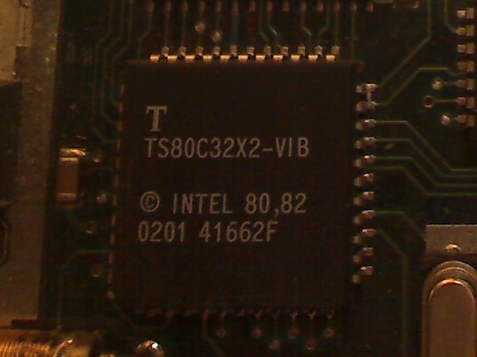

    Not a clue - are those led lights in the tubes? at the bottom?
    IC is TS80C32X2-VIB ATMEL Corporation
    8-bit Microcontroller 8 Kbytes ROM/OTP, ROMless

      Re: Can Someone help me id this board
      My initial guess is some sort of data acquisition board. I've worked with old 8-bit PC ISA data acquisition boards and perhaps it is an RS232 version of something similar.

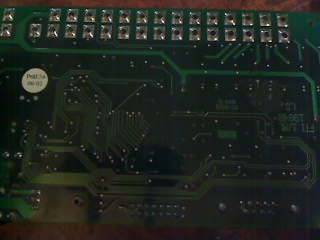

      May help to post a pic of the other side of the board too.
        serial attached i/o
        hook it up to a serial port,
        set a coms program to something standard like 9600 8n1
        and power it up - it may start with a copywrite message or something.
        do you have the tools to lift and dump the rom chip?
          I figured it to be some type of serial board. I have a pace system I could lift the chip but I don't have anything to dump the chip. I was hoping it may be a rs432 board I could use it for a ptz camera. no leds. I will post a pic of the back side of the board
            i think the tubes are for 4mm banana jacks.
            so it's probably some "educational" thing for schools.
