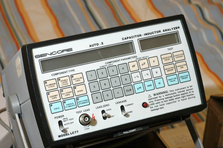

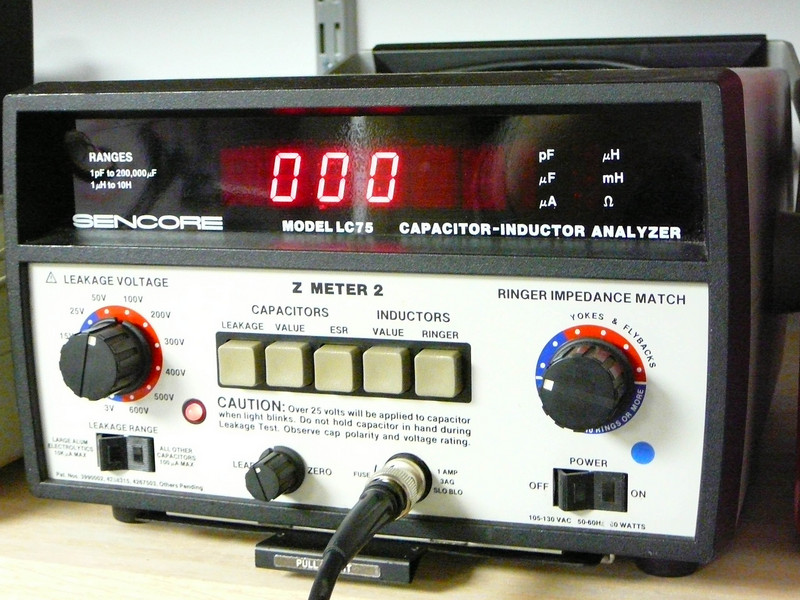

              Re: Smart Tweezers (ST5) or Blue Ring Tester
              At certain point I'm talking about LC 77.
              But you have an LC75 ~ LC 53 with some extras.
              And my questions ( Manual, page numbers ) related LC77.

                I do not have LC77 manual and never use LC77 so I cannot tell what it says in the manual.
                "BTW you have any analog meter or no use in your bench?" Yes, I have SIMSON 260 that have not been using for years.
                    Originally posted by budm
                    "In LC77 pag. 26 for ex. 330 uF, 35 V ESR is 1,01 Ohm
                    But I have a EVB ESR and the val. is 0,1 Ohm
                    The freq. is different?" I do not see how you can compare the example to what you are reading without actually measure the actual same cap with two instrument. The LC automatically adjust the frequency apply to the cap being test.
                    In a Tec. Paper from Sencore:
                    " ... The Z METERS simply charge the
                    capacitor, while measuring the rise in
                    voltage during the first microsecond after
                    applying the voltage. The instantaneous
                    v o l t a g e s t e p c a l c u l a t e s d i r e c t l y t o
                    resistance using normal voltage-dividing
                    formulas. Sencore has been granted a
                    patent on this test. ..."
                    They don't use freq. ... only charge.
                    In your test you can test ESR in Circuit?
                    Best Regards,
                    Neuron

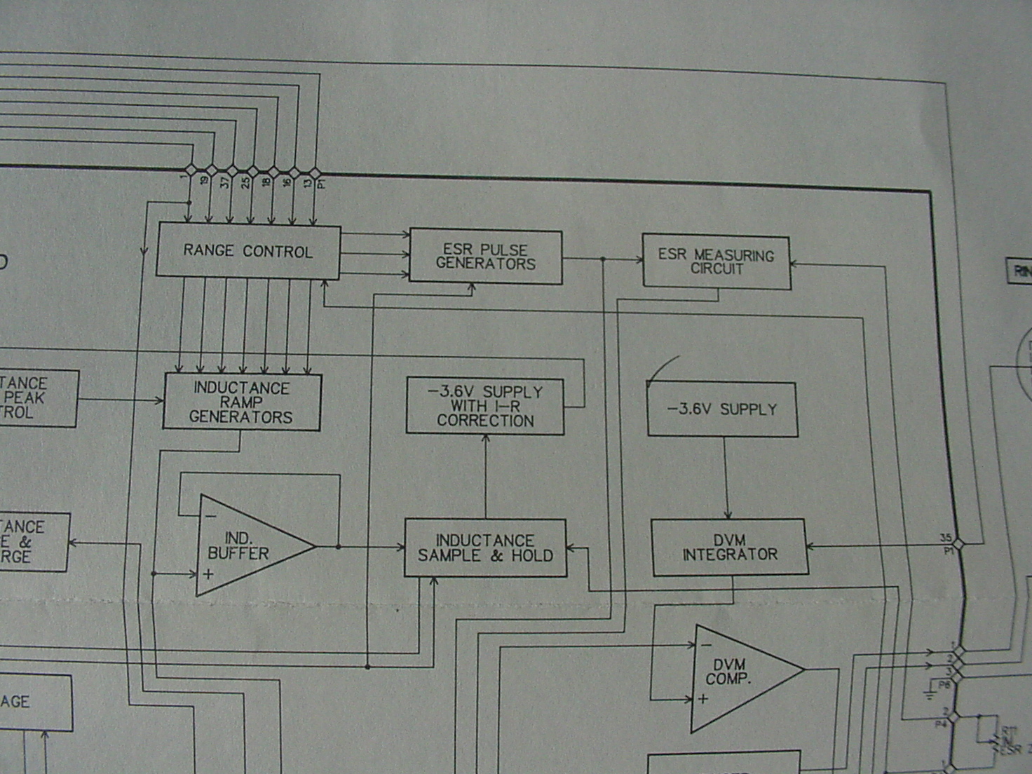

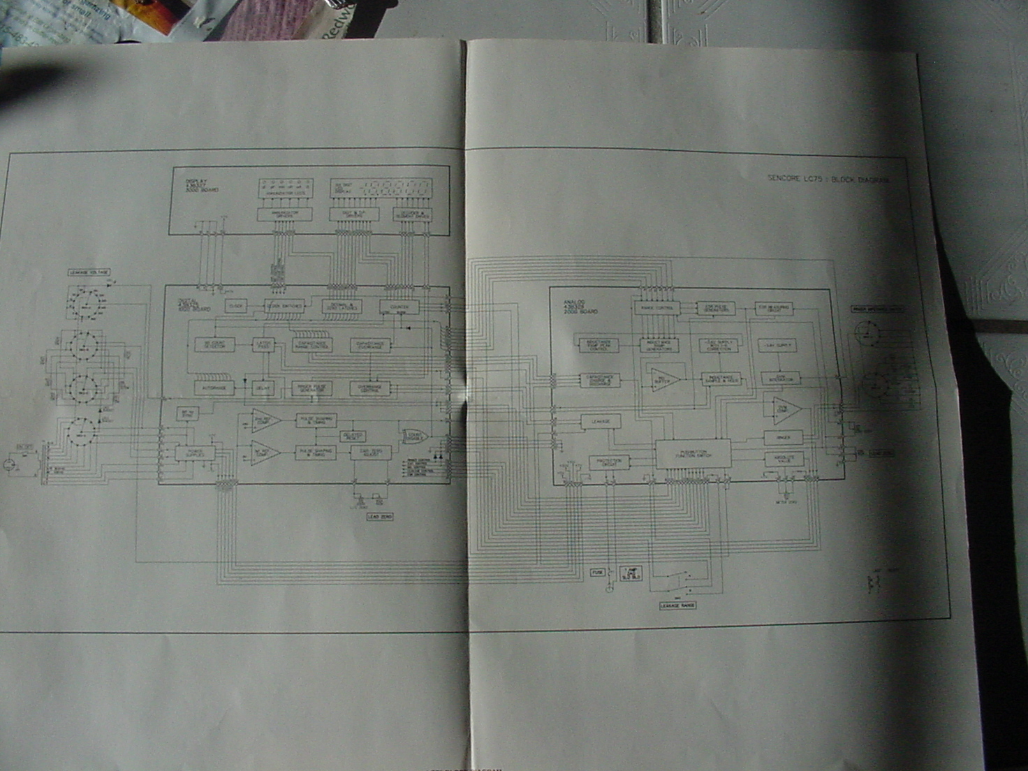

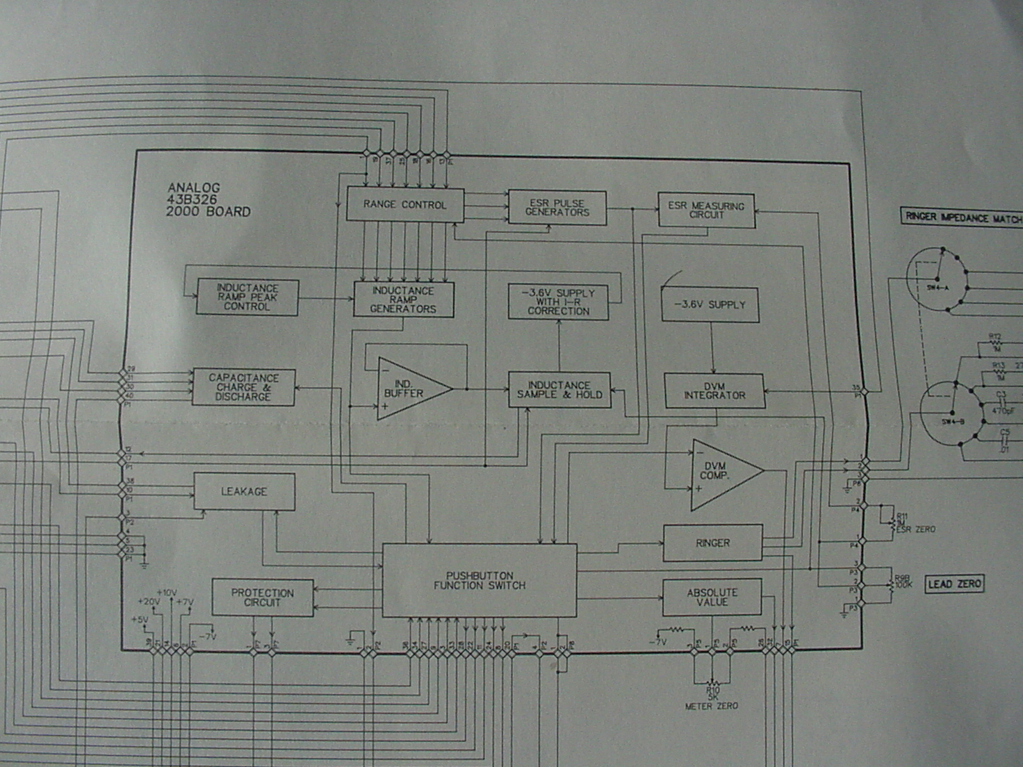

                            BTW, here is the block diagram of the LC-75 in my service manual, as you can see, there are PULSE GENERATORS (3) for the ESR measurement circuits.
                            May be you should see if they will provide you with the service manual for your Super Tweezer if it needs to be calibrated as needed.

                                        The tec. paper:
                                        "" ... The Z METERS simply charge the
                                        formulas.
                                        They also comment in this paper,
                                        the Questions from users about freq. and they explain they don't use.

                                          We are going in circle here. Are you going to use your tools to troubleshoot the problems or just want to have tools but really do not know how to use them properly.
                                          Like I asked, which model is this applied too, the newer version? you already see the block diagram of my LC75 showing PULSE GENERATORS.
