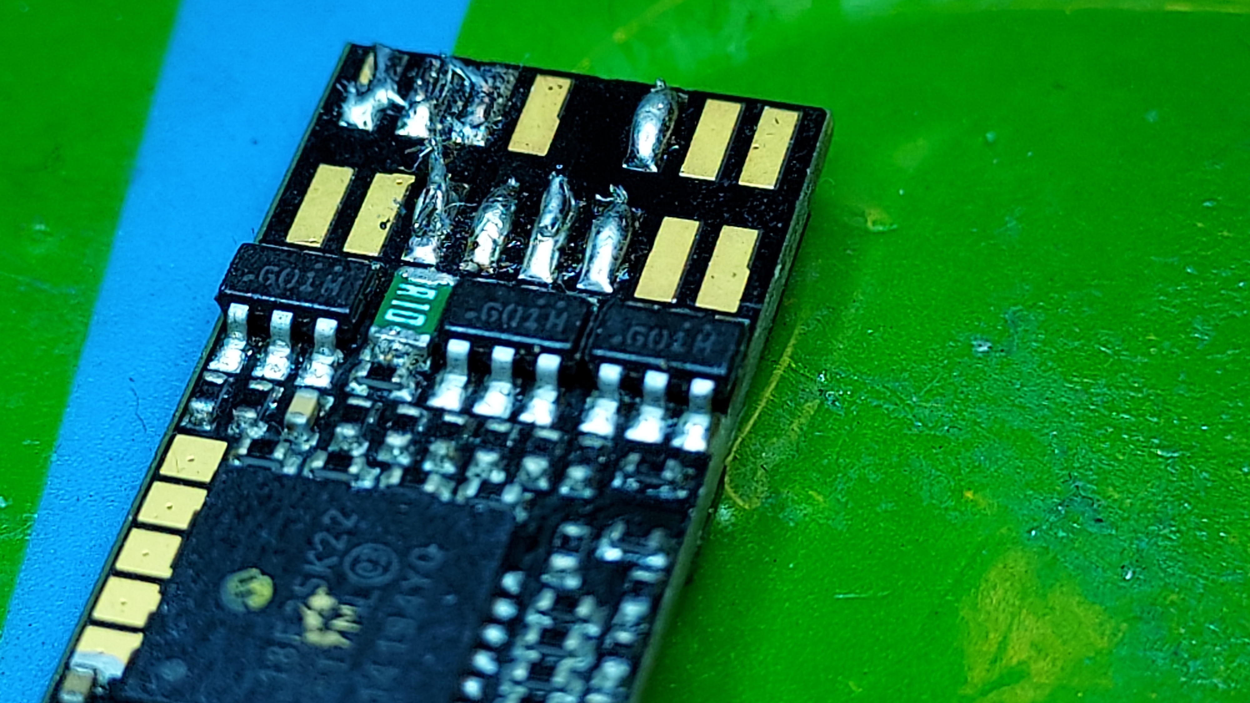

    There are 3 chips marked as "G01H". Any idea what they might be?
    Regards,
    Francesc.

    "G0" is a digital PNP transistor pair. Does it fit the application?
    https://www.digchip.info/datasheets/...umber=DMA56602
    PIC18F25K22
    https://ww1.microchip.com/downloads/.../40001412G.pdf

      Yes,,,,,,other DCC decoders use similar chips. I'll measure them out of the PCB.........I wasn't able to get 44k ohms between base-emiter. It might be faulty. Thanks for the feedback.
