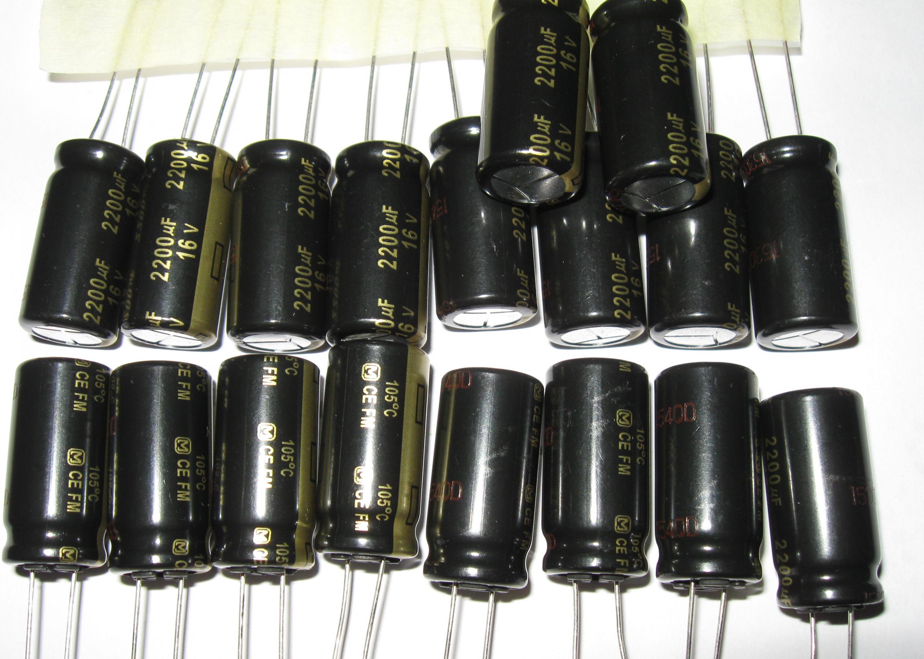

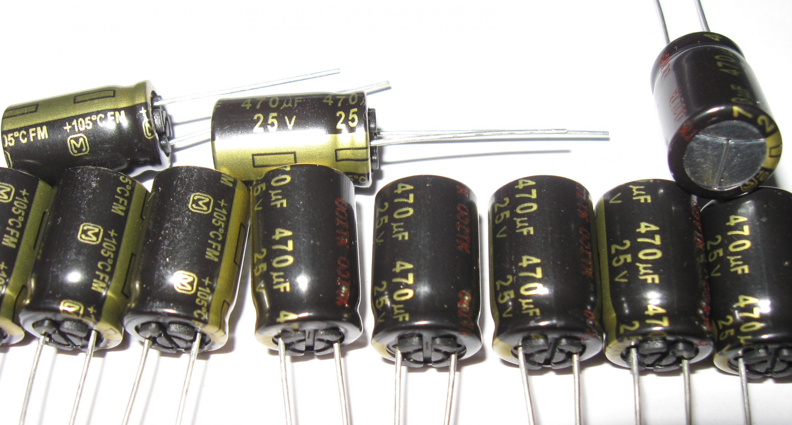

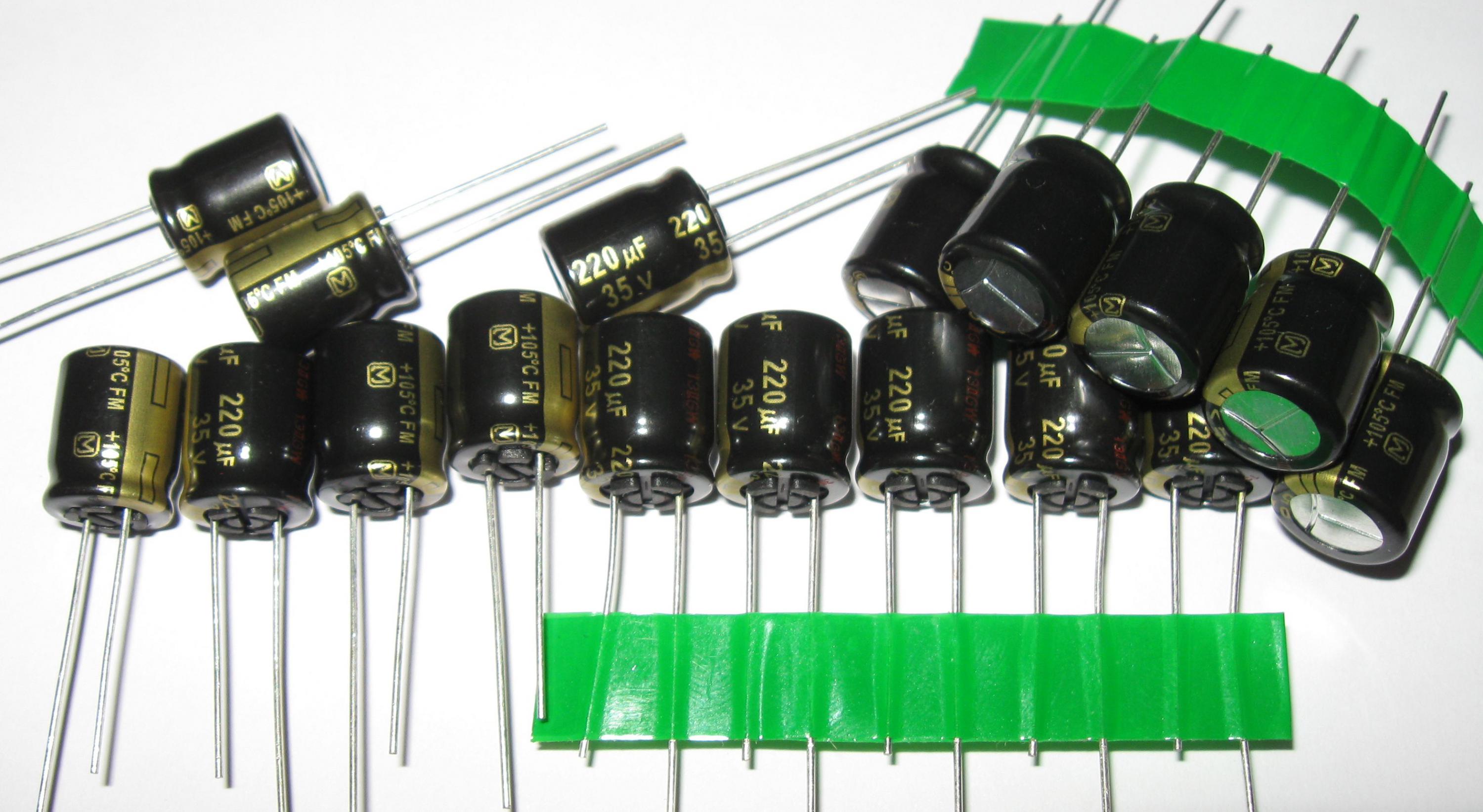

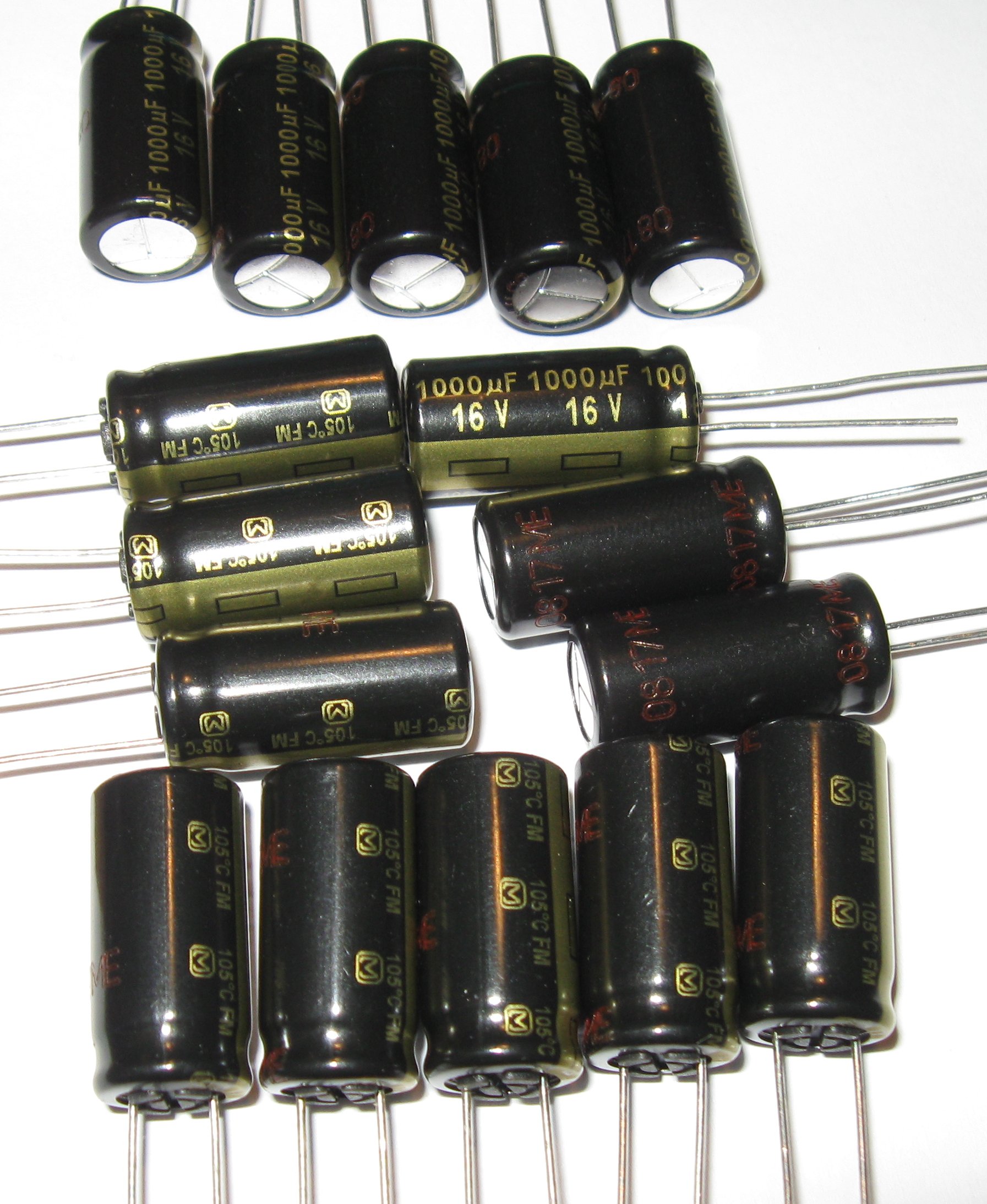

                    Here's a few other pictures I have of capacitors in the FM series, made them myself at the beginning of 2012 . They don't have CE:
                    click to zoom
                    But this one DOES have CE on them ... 2200uF 16v, still from early 2012
                    click to zoom
                    Everything bought from Digikey or Farnell. Ignore the paper/scotch tape on all of them, it's just my way of keeping the capacitors sorted and organized. They come in bulk normally.

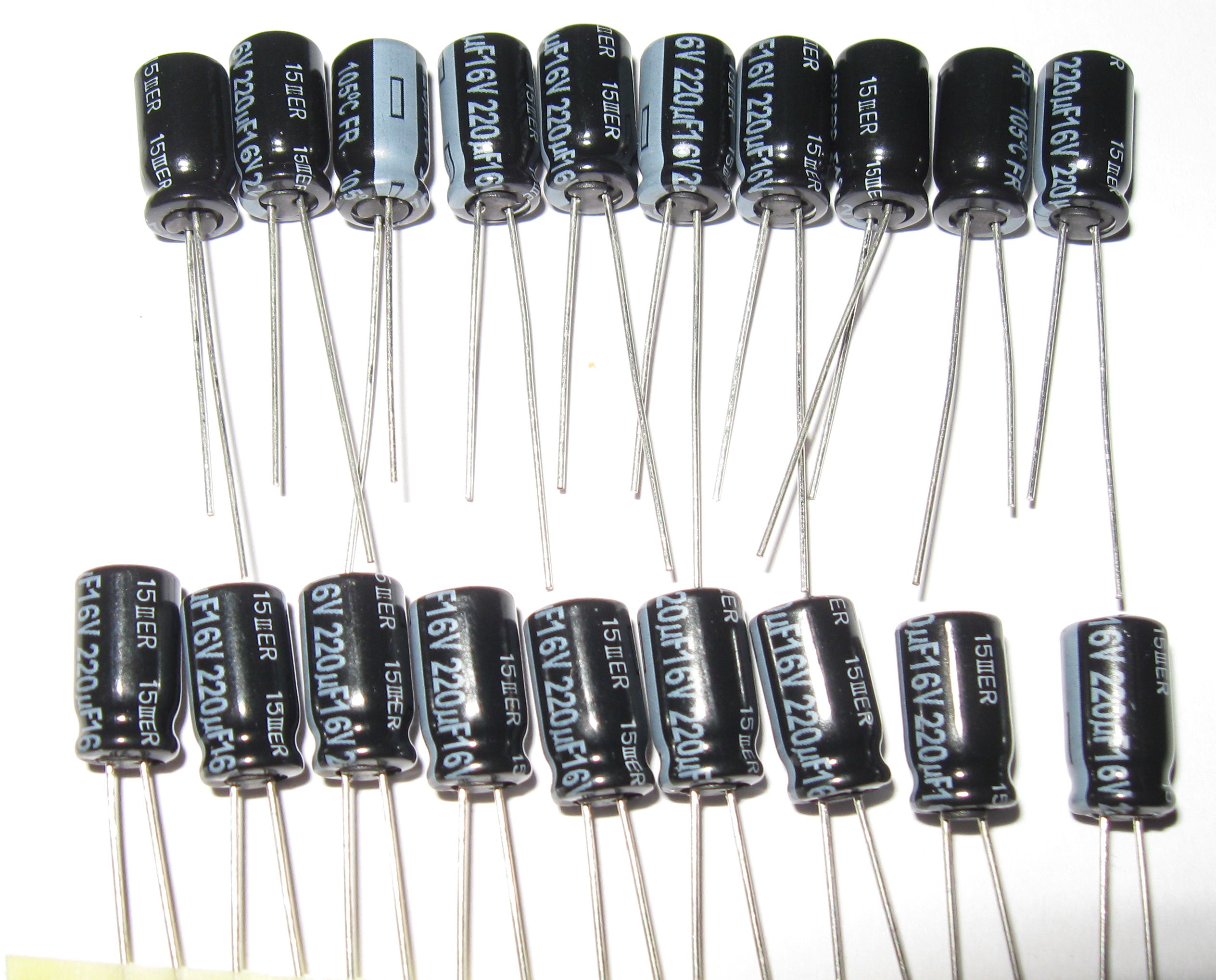

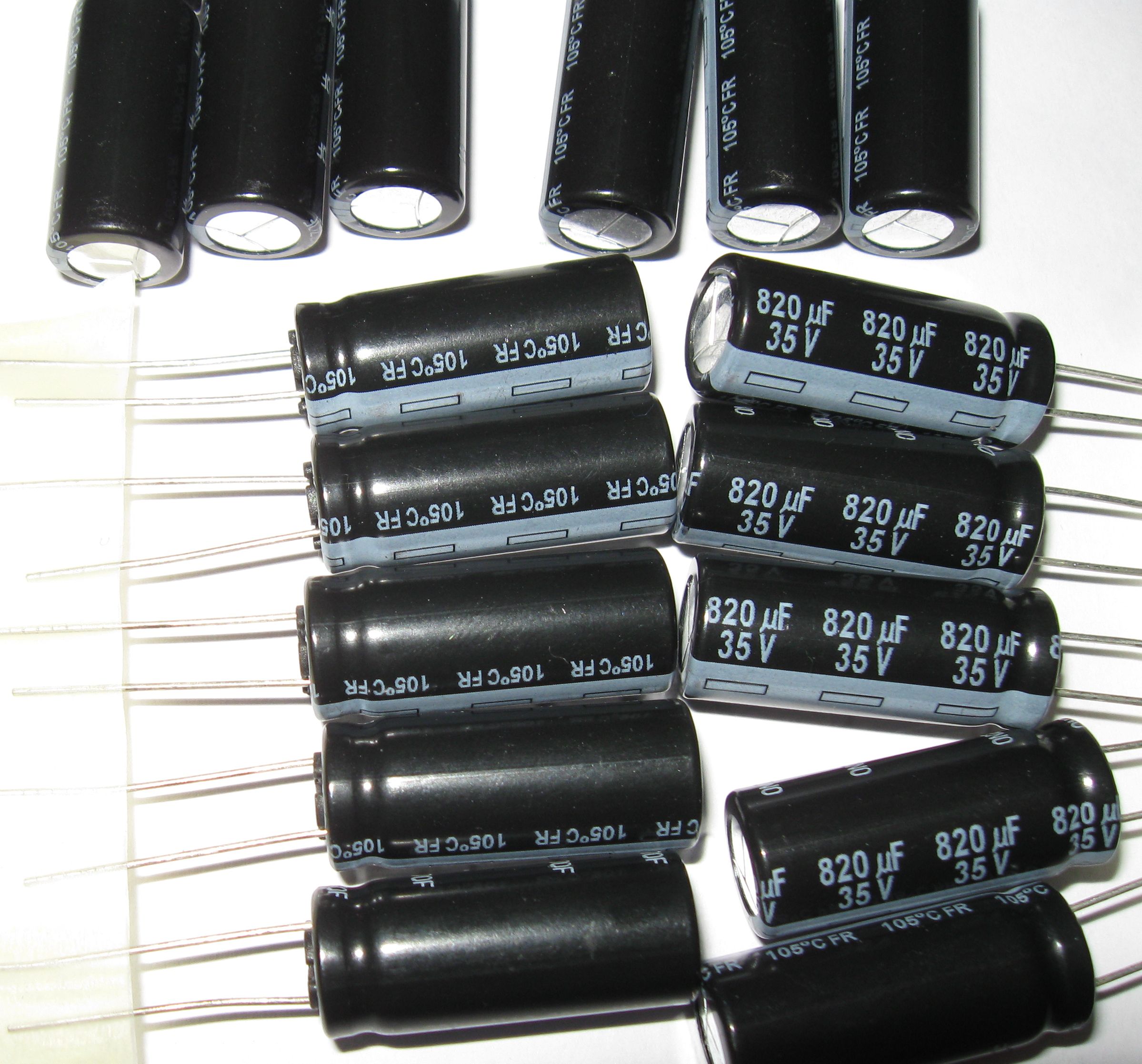

                    FR series comes without the M logo and with plain white/silver color:
                    click to zoom
