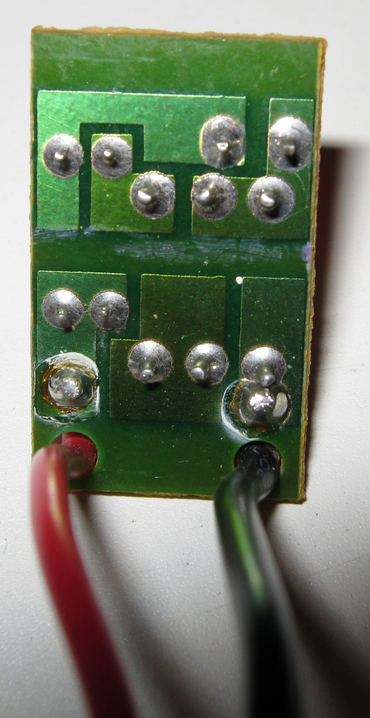

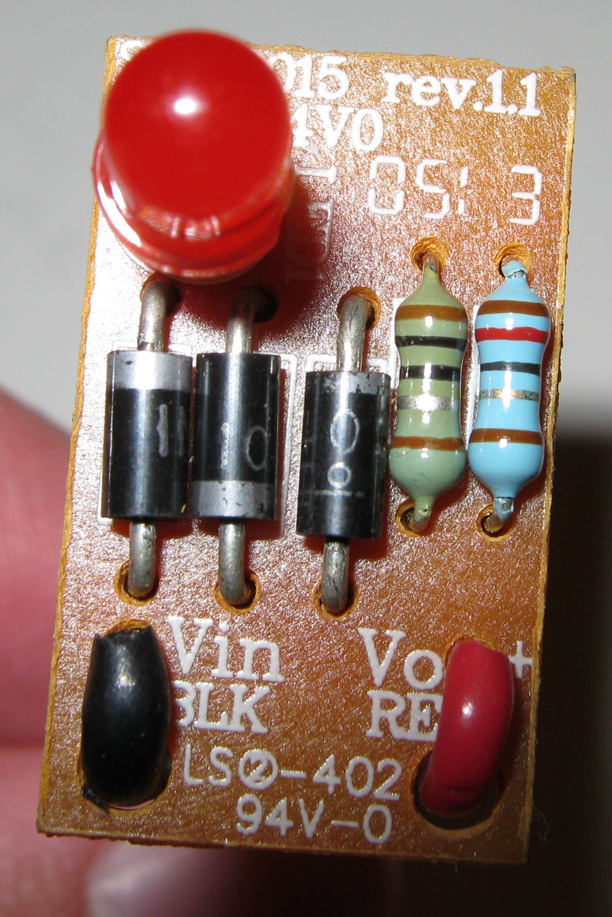

    This is the charging circuit from an old handheld vacuum. There is a green component in series with the battery that looks like a 1/4W resistor, but it is not (its resistance is one ohm, but the color bands would indicate a 10 ohm resistor). I know inductors exist in this package, but I don't know why there would be one in this application. The input of this board (black wire) is connected to a 15V transformer, and the red wire went directly to the positive end of the 9.6V NiCd battery pack. What could it be? The blue component next to it really is a 12 ohm resistor, and the three diodes in series are all 1N4001s.

    It's a 1 ohm resistor. 1 0 0 x .01 = 1
    5 bands , value,value,value,multiplier,tolerance
    Brown = 1
    Black = 0
    black = 0
    silver (multiplier) x.01 =1 ohm
    Brown(tolerance) @ 1% tolerance
    The other 1 2 0 x 0.1 = 12 ohm 1 % assuming that's a gold band not silver which i can't quite distinguish.

      What tw said! That's how I read it as well. Multiplier color code:
      Black = x 10^0
      Gold = x 10^-1
      Silver = x 10^-2

        I've never seen that color code before. Yes, that is a gold band on the blue resistor.
        Why would 1% resistors be used in a battery charger, especially in series with the LED?
