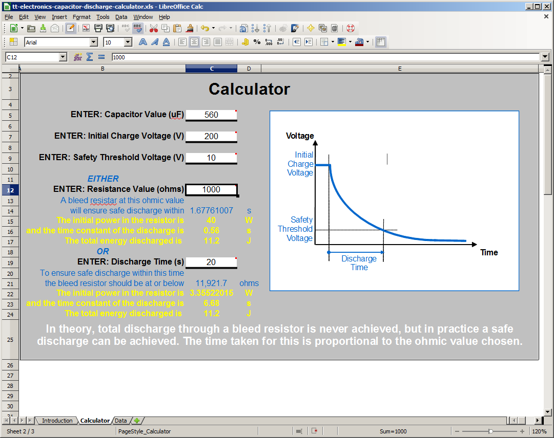

        Oh, it turns out Digikey has a nifty Discharge calculator made in an Excel spreadsheet:
        http://www.digikey.com/Web%20Export/...s?redirected=1
        and looks like I have to correct myself, seems that the discharge time matters quite more than I estimated.
        Doing the math for that 560uF 200v capacitor, turns out a 10k resistor will discharge the capacitor to 10v within 17 seconds.
        A 4.7k ohm one would do it in eight seconds but the power would be 8.5w so a 7w resistor might not like it that much (but the resistor may see more than 7w for half a second or so)

            Once I saw that calculator, I noticed how steep the discharge curve is and I can see how the resistor would tolerate such initial power dissipation.

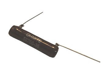

              For example, I have an Ohmite 10 ohm, 25 watt tubular ceramic resistor, of the type seen here:
              This would be more than adequate for discharging caps, but we use a highish resistance to reduce sparking and peak currents while clipping it across the caps. One of these, 500 to 2500 ohms would be perfect. An easy way to determine discharge currents is with Ohm's law. (I=V/R)
