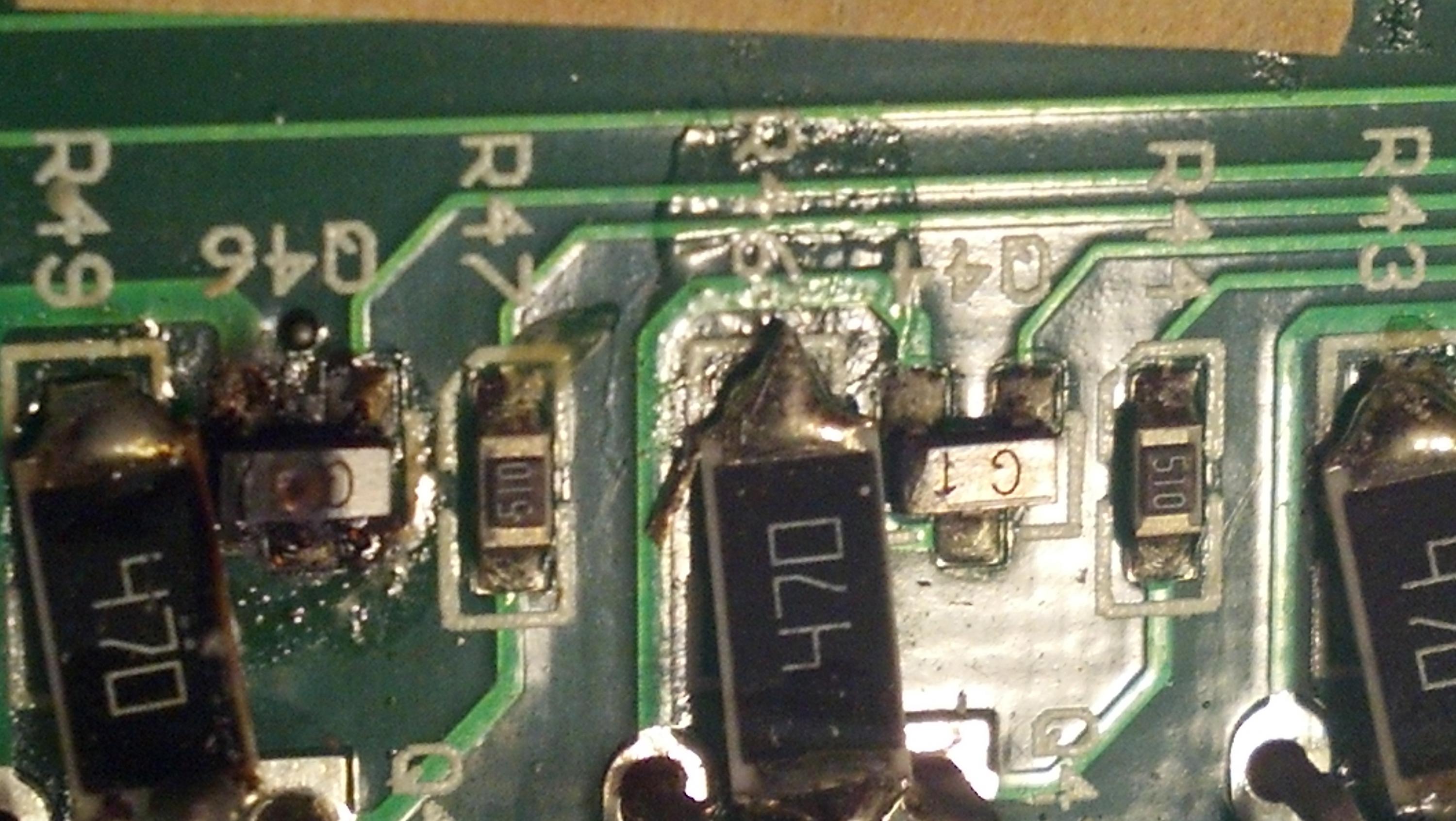

I have a Cricut art cutting machine. it sometimes works but now won't work at all. I have opened it up and looked at the main board and this picture of Q46 is what I think could be causing the problem. do you know where I could get this part. thanks for your help
CriCut Art Cutting Machine won't turn on
Re: CriCut Art Cutting Machine won't turn on
Yes Q46 had a bad day. It looks like some kind of current-limiting circuit, in triplicate, so you can compare ohmmeter readings between the 3 sections.
Taking the SMD marking code from neighbor Q44, it's a general purpose high-voltage NPN transistor in a SOT-23 package, MMBT5551 (2N5551 family)
I would keep digging, as these little guys don't roast unless there is a problem somewhere nearby. Check the bigger transistor below (Q47?), it prob. shorted, thus overloading Q46. This art cutter uses a heater or motors? -

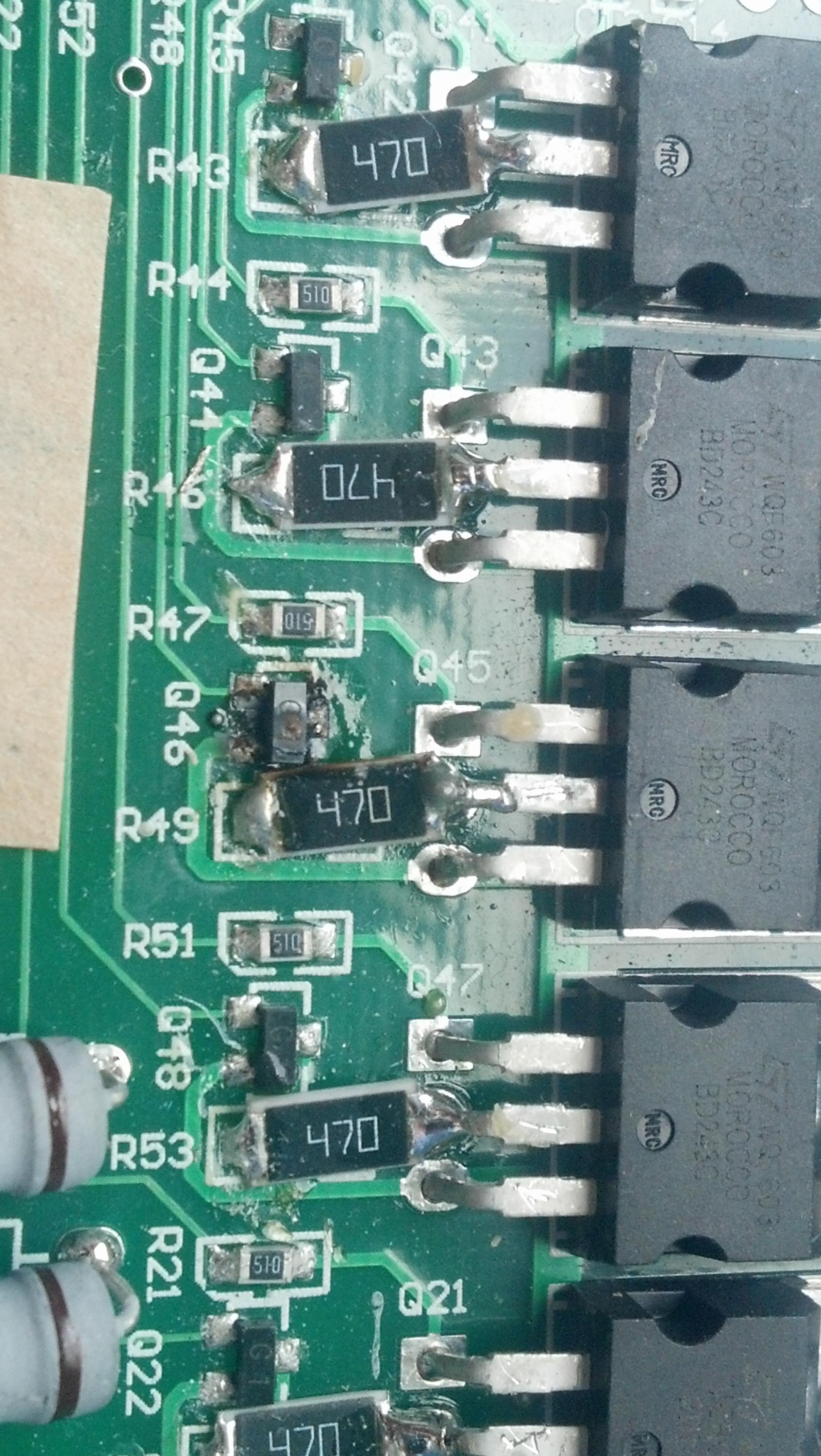

I have a better picture of the area. I have tested r49 and r47 and compared them with all the other same resistors and they test the same as the others. I am not sure how to test Q45. but I have compared readings with the others around it and they appear to all test the same. so I thought of just replacing the Q46.Attached Filesif you find these attachements useful please consider making a small donation to the site
To test Q45 for a short: set your meter to 200 ohms, label each pin of Q45 1,2 and 3. Measure across pins 1-2, 2-3 and 1-3. Something in the range of approx. 0-30 ohms indicates a short. Since you have similar circuits (Q43 and Q47) on the left and right of Q45, measure those also and compare your results.Comment
