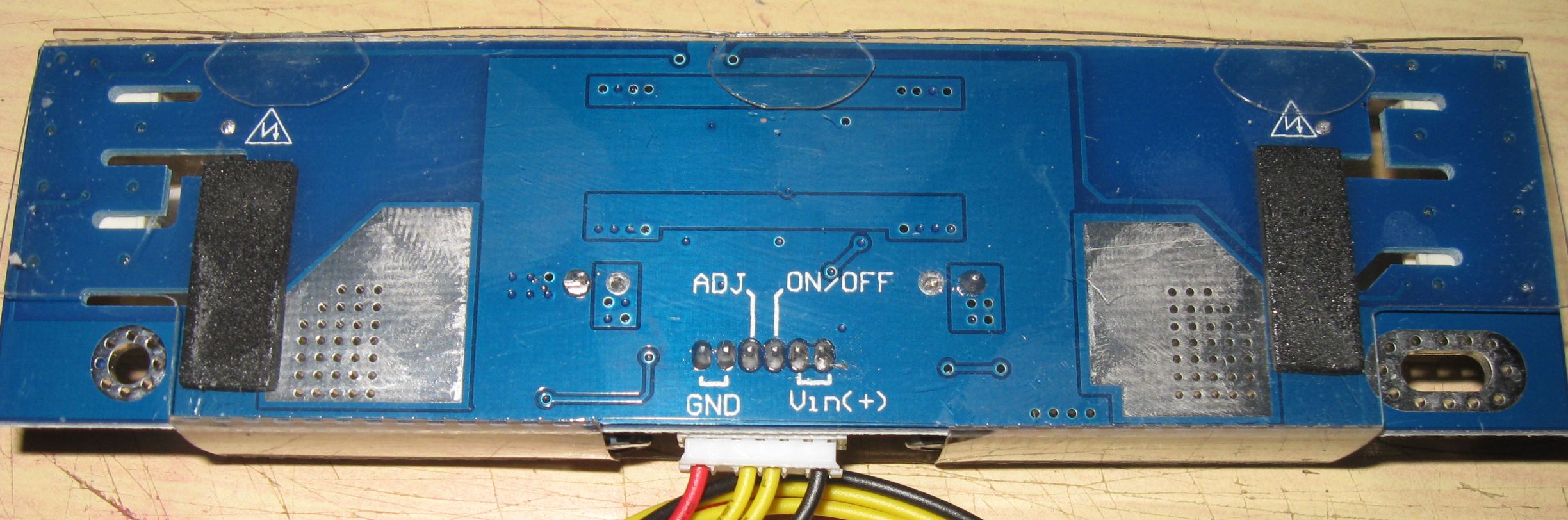

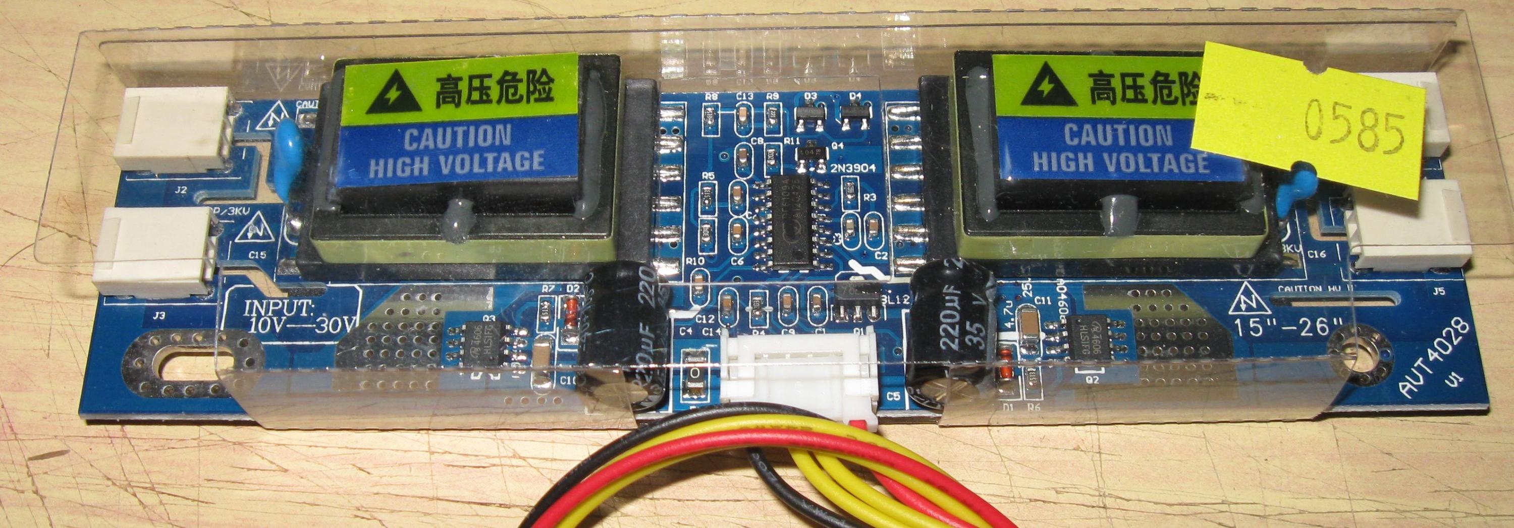

          You have four wires coming from the small inverter board. Turn it on its back and you have there the text saying which wire does what.
          Mine looks like this:
          But the colors might be different on your inverter.
          One wire will be on/off , one will be adjust ... those two wires you tie to the first two pins on the small display board.
          One wire will be Vin which accepts anything above 10v, so that goes to your 12v or 14v
          The GND wires goes to ground.
          As you can see on my inverter, the colors don't make sense - normally black signifies ground, red signifies 5v, yellow 12v... on my inverter are exactly opposite.
          Yes, if you remove the power supply board from the back, you need to create the 12v and 5v voltages for the display board through some other method. Easiest way would be to get a 12v laptop/monitor dc adapter and then use a 7805 or something compatible to get 5v.
          You can feed the inverter with around 12v with no problems and you should connect 12v to the pin on the display board that acccepted 12-14v previously.
          As the power supply is no longer used, not connected to the display board, you will need to create those 5v for the display board, and this is where the circuit with 7805 comes in play on the previous page.
          You can use however LM317 or whatever you have, fixed version for 5v or with adjustment resistors - you said you did an adjustable supply with something like this before so it should be easy for you.

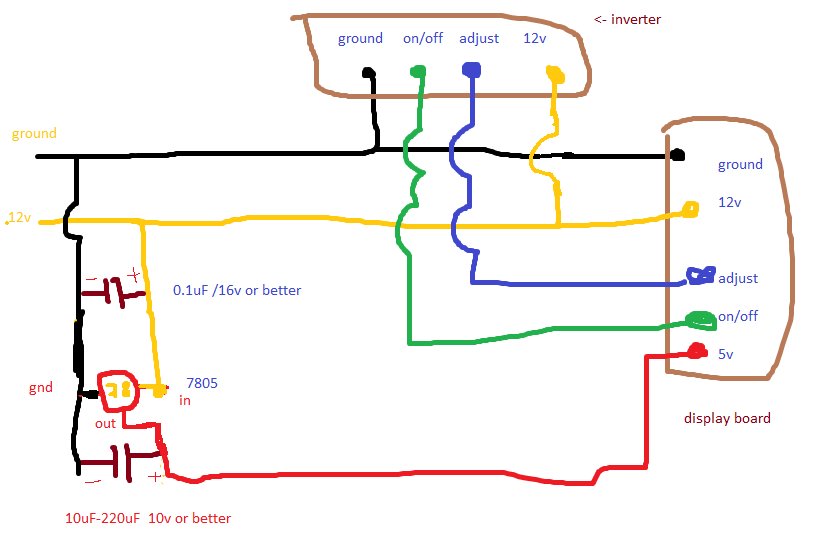

              Re: Computer Monitor Conversion AC to DC
              On computer power supplies, orange is 3.3v, red is usually 5v, yellow is 12v .. ground is always black.
              There's usually one exception, where the connector has just two wires... then black is almost always ground, the other color is voltage... ex 2 wire fans have black ground, red is 12v
              You don't need 2 x 7805, you can connect both 5v pins in that connector to one 7805. A single 7805 should be quite capable of delivering enough power to that display board.
              The inverter needs ground, 12v
              The display board needs ground, 12v , 5 v
              So both the display board and the inverter will share 12v and 5v.
              Inverter needs to receive on/off signal and adjust from the display board, so there's the two wires between inverter and display board for that.
              Here's a really poorly drawn schematic... I barely passed the technical design exam at university that's how bad i suck at drawing but should still be easy to understand
              In theory both of those capacitors are optional, but it's really safer to have them around.
                I'm back again after being away. Thanks for the drawing it's fine and I'm sure I will make sense of it as soon as I get a moment to revise all the info.

                  I've all but wired up the Inverter, Displayboard, the 12volt supply
                  with only the 5 volt positive supply to put in place.
                  In your drawing the 5v at the display board goes into which pin?
                  "My guess is the two pins at the top are the ADJUST and ON/OFF pins."
                  So would it therefore mean the 5 volts goes to pin 5 or 6 ?
                  My Display top row is..1= 0volts, 2=5volts, 3=grd, 4= 14volts,
                  bottom row... 5= -0.12volts, 6= 5 volts, 7=grd, 8= 14 volts
