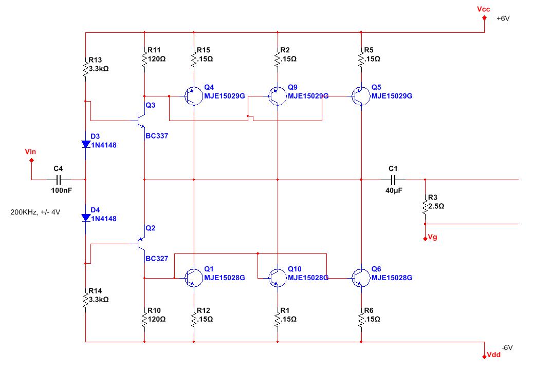

      Hello
      I want to couple the output of a push-pull power amplifier (sinusoidal 4V peak, 200KHz) into a transformer and want to make sure there is no DC so I used a capacitor. Because the "load" maybe as low or lower than 4R the capacitor should not add to that, and at 200 KHz a 20uF capacitor is roughly 1/10 of 4R [ Zc = 1 / (2 * pi * F * C) ] - hence the 20uF.
      As I did not have a ceramic 20uF, while testing on the prototype, I used 2 * 1000 uF cans, and it works OK under load, although I feel I am mis-using the electrolytics for this application, and should be using a non-electrolytic capacitor.

                      Re: Capacitor choice for 200KHz
                      The circuit is an op-amp oscillator at 200KHz pure sinusoidal at +/-4V. This is then fed to a current amplification stage to drive a transformer. The current amplification stage is push-pull using complementary pairs at the output. The output of this stage, which is +/-4V, is fed to the transformer, whose primary resistance is expected to be as low as 2.5R. I have used a capacitor to isolate the transformer's primary from the output. I started by using 2 * 680nF capacitors, but then I got slightly better output with 2 * 1000 uF and 2 * 470uF all in parallel.
                        This is the prototype which I am using, except the capacitor I used is as I said a combination of 2 * 1000uF and 2*470u
                          Very simple Complementary pair output with no bias adjustment or temperature compensation circuits to take care of any drift in components and to reduce cross-over distortion or DC offset adjustment to set the center point to be at 0V. Distortion is not any concern? Not sure what the receiving end input signal (generated by this circuits) requirements are. It may do its job just find.
                            As you suggested I am looking to buy MLCC 10uF/25V and 20uF/25V X7R from Mouser and try them to see how they look on the scope. They are not that expensive at 25V.
                            Regarding biasing and overheating, the circuit works well at +/-6V which is the expected rail voltage. On the test circuit the transistors have tiny local heatsinks and they do not even get warm. The final device will have a proper larger heat sink.
                            From the theory that I know I can increase the 0.15R to something larger, maybe even 1R, to stop any single transistors from getting too hot, as long as I do not see a reduction of the amplitude of the output.
                            As an experiment, at +/- 7 V, individual transistors do get hot, reach 45-50C, and they stabilise there, while some others are at 30C. This is because of the fixed biasing as you said.
                              You should mount the 2 Bias Diode on the heat sink (just have the bodies touch the heat sink and use heat sink compound) to help reduce the thermal run away and at least maintain the bias current when the output transistors get heat up.
