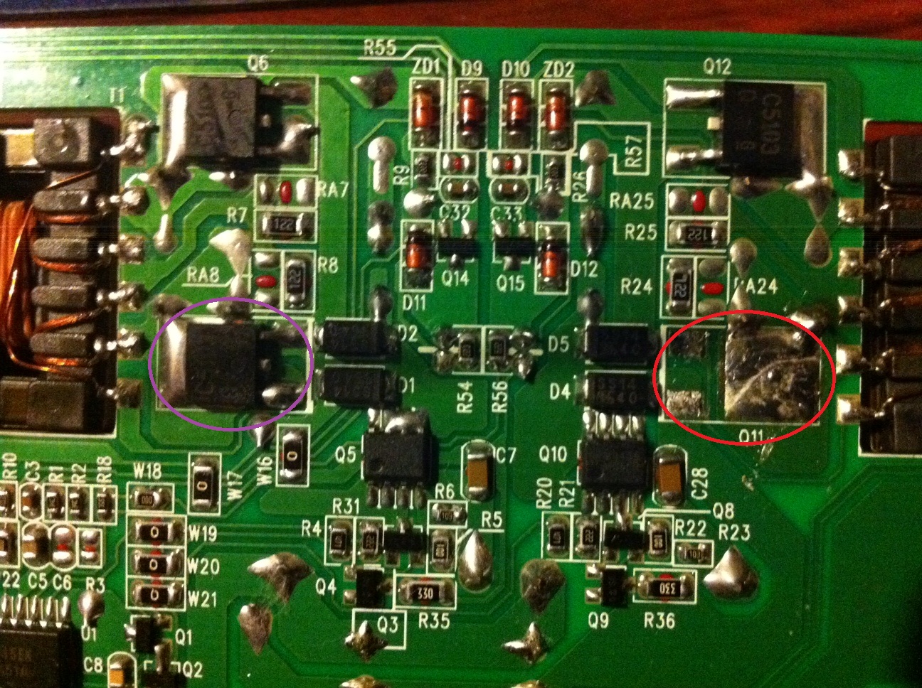

    Bad Transistor
    Hello, I was needing some help trying to find a replacement part for a transistor any help would be appreciated the markings on transistor are (C5103) it also has a symbol "G" I have attached 2 pics one of the board with the transistor removed, the red circle is where it was located. The purple circle is another transistor different location. but they are the same part. The second pic is the transistor that was removed. This transistor came off of a PSB from a Montitor Sceptre X20G-Naga II the number on the board is EPP007 REV:4 hope this is enough info.

    Re: Bad Transistor
    Originally posted by aftonr
    (C5103)
    They might be
    http://www.findchips.com/avail?part=2sC5103

      Re: Bad Transistor
      Thanks for the reply! I was leaning towards Mouser Part #: 755-2SC5103TLQ
      but I didnt know for sure if that was the right part is there anyway to check to make sure. the measurements match up to my part I doubled checked the info with my caliper. But as far as the (V) I'm not sure. any suggestions?

        Re: Bad Transistor
        Total cost (part + S&H) would be cheaper from Digikey.
        http://search.digikey.com/scripts/Dk...53828701656026
        Various datasheets show same specs.
