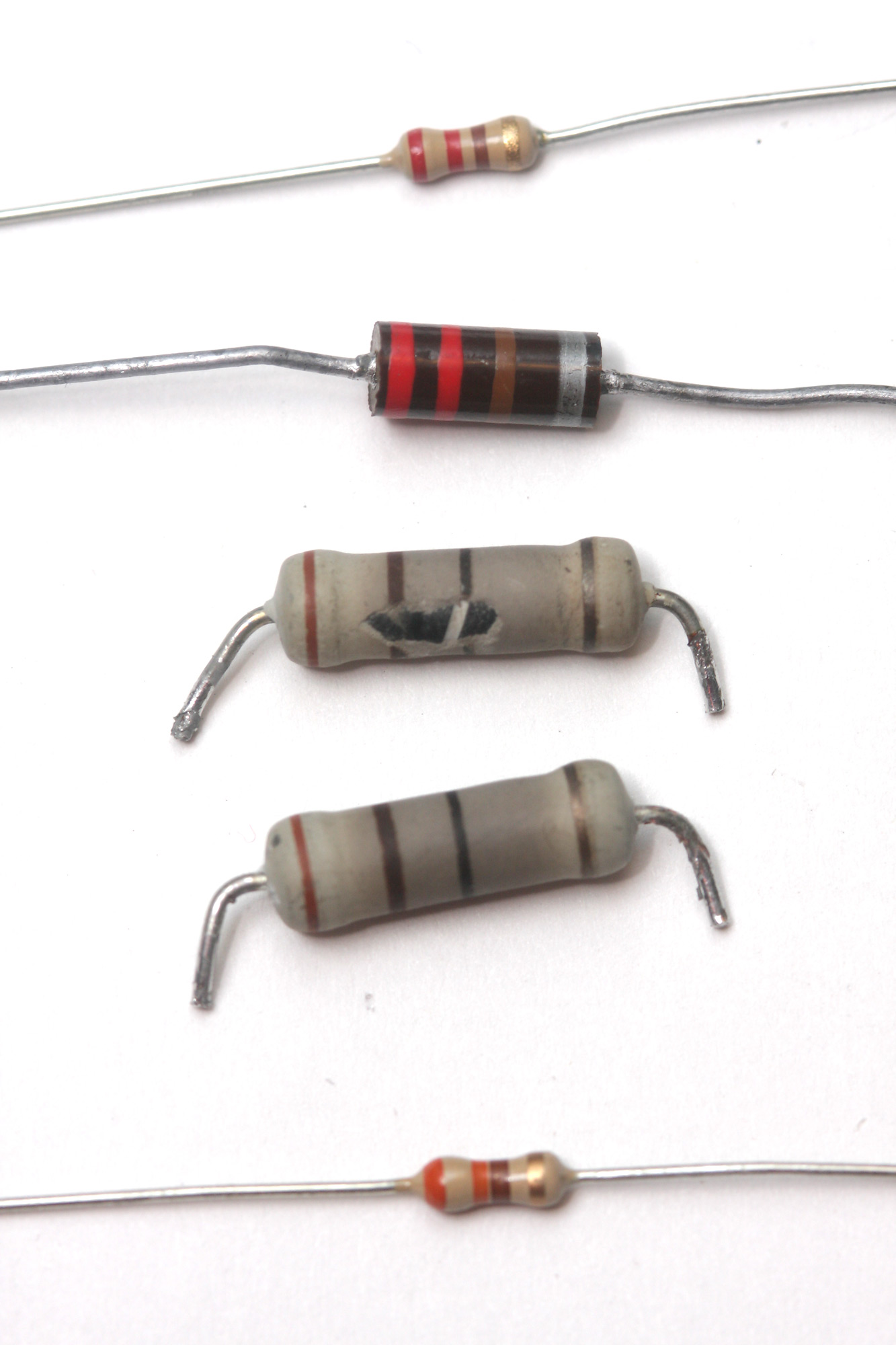

    I think it's just 2 bad transistors and these 2 overheated resistors, but my old eyes are failing me.
    These could be red brown black or orange brown black. Both measre 33.5 ohms. Any votes?
    shown for camera colour accuracy, above are 220, below is a 330.
    Thanks.

    I think orange brown black.

      They're not mine, but I'll second motion for Orange-Brown-Black.

        looks like brown brown black. the first band is too tan to be orange.

          I also think Orange - Brown - Black,
          That gives you 31 OHMs 10% tollerance,
          That would fit with your 33.5 OHMs as resistors go higher when failing.
          edit 3+4 resistor look like they have silver and gold tollerance bands, but you would be best judge of that

                  This.
                  ... though I doubt the resistance has drifted from failure with that reading, probably just a little residue on them plus probes and probe leads plus the 10% tolerance.
                  Probably silver 4th band that just took a tanned golden hue from running hot.

                    Thanks all. I'm going to go with 30 ohm and as soon as my transistors arrive via snail-mail, I'll fire it up and see what happens.
