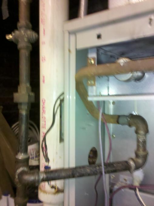

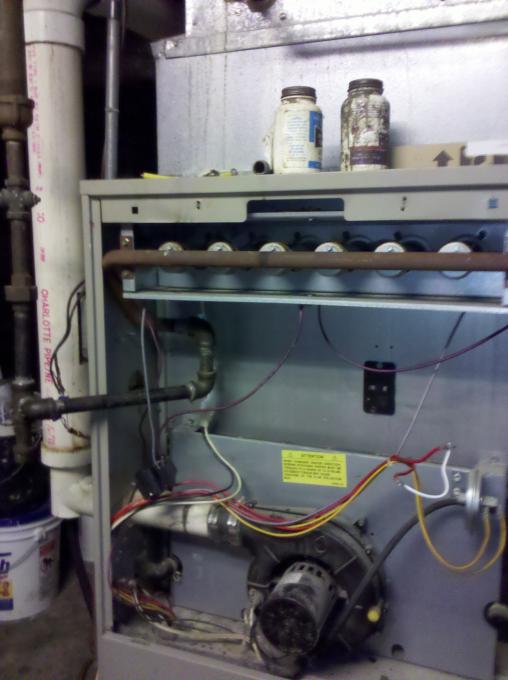

          Slightly OT...
          skystorm, I just saw that furnace video.
          What the hell is up with the landlord!? Renting out a firetrap like that! Inducer starts, ignitor heats up, you close ckt to open gas valve, ignition. Then rollout because IDM stops and restarts. You won't be ready with your '50 pound dry chem' at 2 in the morning...
          (Criminal) negligence!
          The two pix are from hvac-talk. Can anyone tell me what's missing in that 'vestibule compartment?'

                Don't brush something like that off casually.
                You better hope that thing has rollout switches on the burner box.
                Don't be ignorant and blow it off like, "Well it rolls out, but eventually the IDM stays on and the blower comes on."
                'Eventually,' all the wrongs will piss Murphy off and you'll have a fire or worse.
                For the sake of everyone in the place, FIX THE DAMN THING.

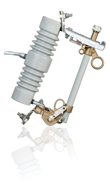

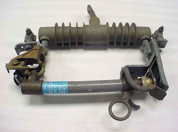

                                        Sounded like a shotgun blast, right? Cutout hanging in the breeze? The two in the pix are closed
                                        Go around the house and unplug everything. For equipment fastened in place, dump breaker. If the POCO refuses that cutout and the transformer goes pri to sec, you'll bbq your appliances and electronics, so unplug 'em now.
                                        Get a camera ready for when the POCO comes. If the tx blows its top when/if they refuse it first, you'll have a good one for youtube. Provided you dump your loads first...
