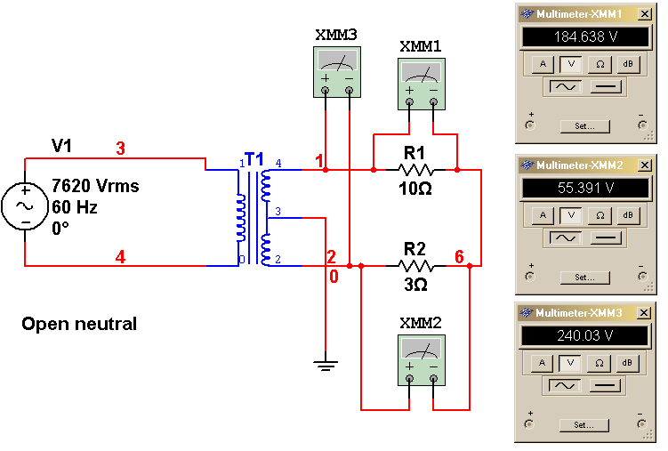

    i have bad bad bad power in my apartment midday 100v 29.24hz midnight 142v 66.23hz 6pm 124v 60.22hz 6:33 am 144v 66.02hz
    now what can this damage plz help cuse of this my will not run well in winter on this power

              How did you measure the freq? Was this a 'soft' measurement by the UPS?
              You'd have a blackout long before you ever truly had 30Hz - 66Hz.
              Those voltages make me suspect an open neutral, anywhere from the POCO TXs and the building's service to the feeder for your apartment sub panel.
              Did any other units experience voltage issues? Some bulb dimming when appliances and esp motors start may be on the edge of normal, depending on feeder sizes/imedances. But if you have bulbs that brighten as well as dim when your fridge or washer starts, do something about it before stuff gets fried.

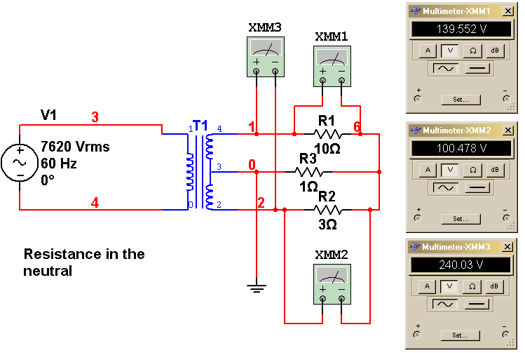

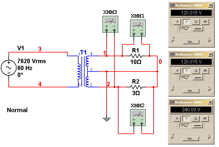

                            One of your vids was 'suggested' or 'related' when I was looking at various electrical stuff on youtube one night.
                            The diagrams are for 120/240 1ph 3w service. Your apt building probably has 208Y/120 3ph 4w service, with 120/208Y 1ph 3w "network" service to your subpanel. Network service also used in metro areas with transformer vaults in front of buildings, such as NYC.
                            Not as likely, it may have a 240D/120 3ph 4w service, with the center tap of one transformer grounded. This will be the 'lighting' transformer, the other two being 'power' transformers.
                            With Ohm's Law in mind, study why what happens in the diagrams actually does.

                                But your apt is the only thing with voltage issues?
                                This came up in your 'ground fault' thread a while ago:
                                http://www.youtube.com/watch?v=uMV1jmDn3o4
                                One thing to watch is when the L-L voltage, 240V if you have a 1ph service w/ a 120/240 tx, slowly creeps up.
                                240V, then 244, maybe 248-252 or 258 after a while. Of course, these measurements must be checked at the same times of day or similar/repeatable loading conditions.
                                If the primary of the dist tx starts getting some shorted turns, this is one of the things that will happen. The turns ratio is reduced (increasing secondary voltage) and the shorted turns overheat.
