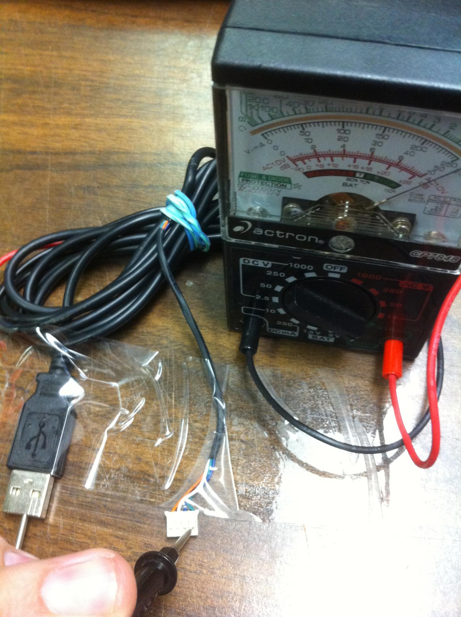

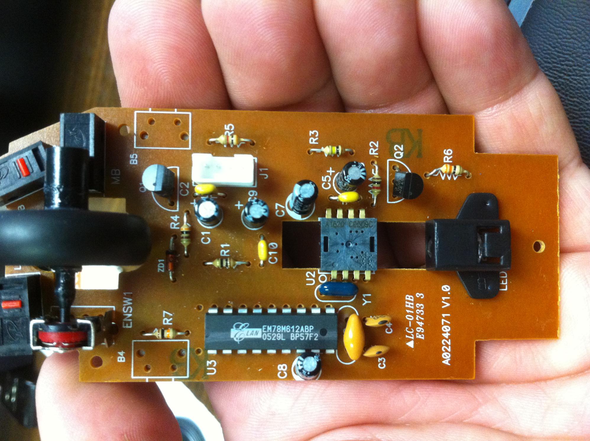

    Anyone ever repair a USB Mouse? It was working fine one day and then suddenly could not be recognized. I tried it on different computer and same thing. A diff mouse works on my computer in the same USB port just fine. Ideas?
    Pics attached.

    Re: USB Mouse suddenly not recognized
    Usually it's a broken wire in the cable.
      ok ty, I will meter test it immediately. Just to add, its a FELLOWES 98903. Ya know, just in case any wants to know. lol
        All 4 wires test good with meter set to X1K Ohms, but the blue wire only tests about 50% of the way to max Ohms when the other 3 test 100%. That normal that you know of?
          Max Ohms? Don't you mean zero ohms? A good conductor which is OK should test 0 ohms or close to it (My DMM for example says 0.02 ohms)
          I take it you are measuring from the board end to the plug end?
          Which USB pin corresponds the blue wire? There is not normally a blue wire in USB cabling (But I assume this mouse is el-cheapo and they have used whatever colour they could find)
          Why are there no wires visible in your photos?

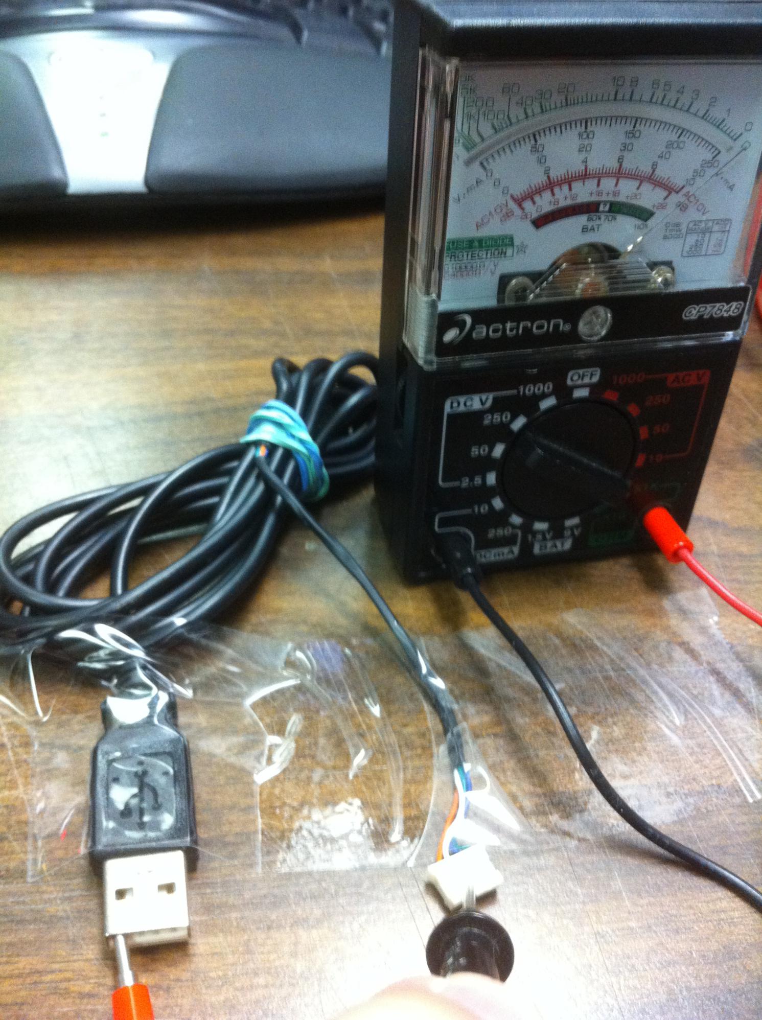

                    Ok, I taped the cable to the desk and as you see it, I call the left pin #1 and I test them all with the corresponding color. OHMS is zero for all of them. Not sure why blue was 50% the other day, I may not have been holding the test lead good enough, very hard to work with small cable and hold tester leads all at same time, lol. I test each lead against all 4 wires and none tested bad. Only 1 reading per pin with 1 wire, so no short in any wire. I moved the cable around while testing to look for shorts. See attached pics, sorry for pic quality, was best I could do under the circumstances.
                      Agent24 yes I am measuring from the board end to the plug end without the cable attached inside the mouse. As you look at the pictures above, the pin on your very left side I call Pin #1 and then next Pin #2 until Pin#4.
                      They are as follows; Pin1 = White Wire, Pin2 = Blue Wire, Pin3 = Green Wire, Pin4 = Red
                        Thank You Smason, I decided to shorten the cable by 1 inch and now its perfect. Had to be a broken wire right where the cable comes out of the mouse. LOL
                                    Actually in this case what you are looking for is open circuits, not shorts.
                                    Usually near the entry to the mouse the cable can break (as it's moving around a lot) - and in some positions the broken ends of the conductor inside the cable match together again and the thing works.
                                    Probably your blue wire (which sounds like one of the data pairs) was in a position to have a bad connection last time but this time you moved it in a position where the internal conductors were touching OK.
