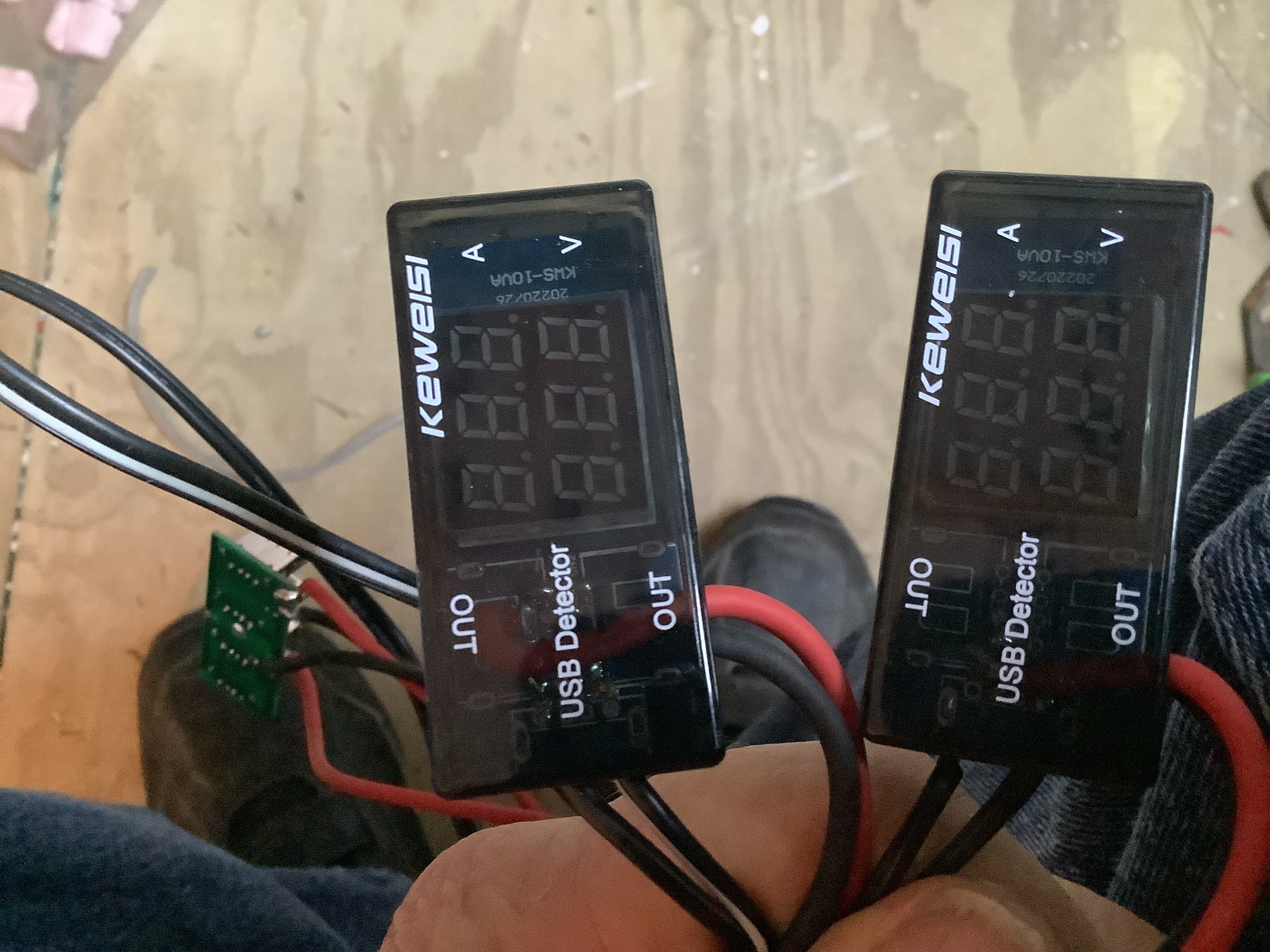

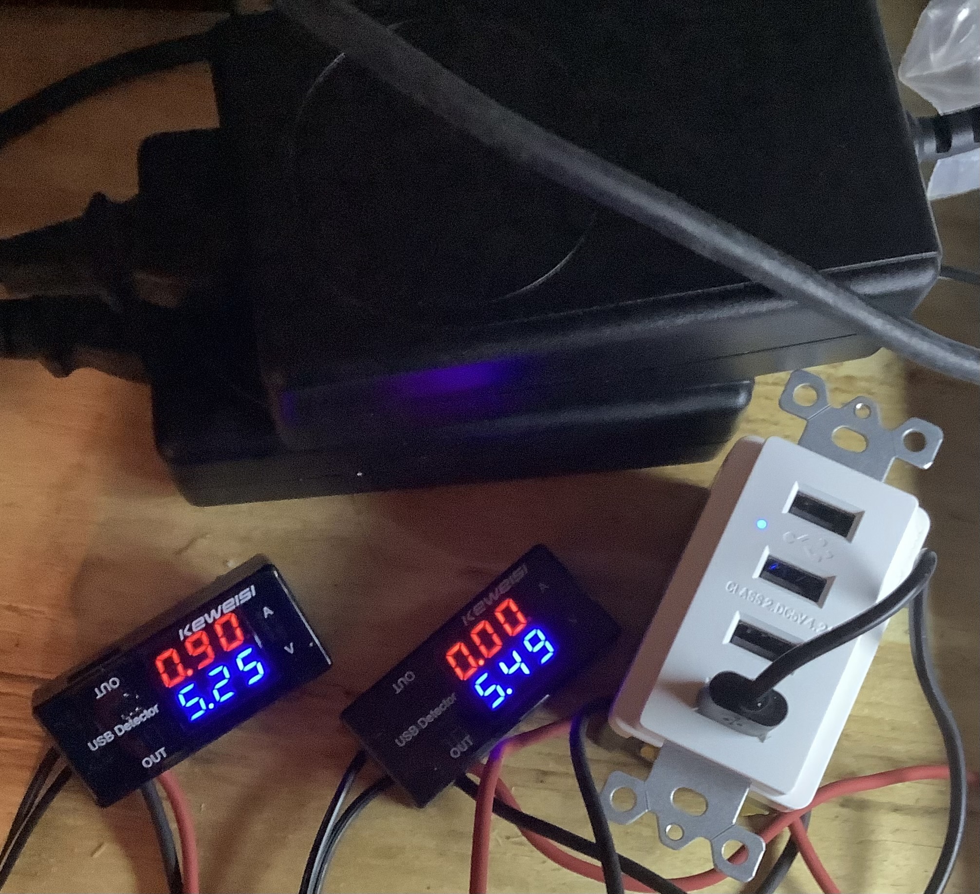

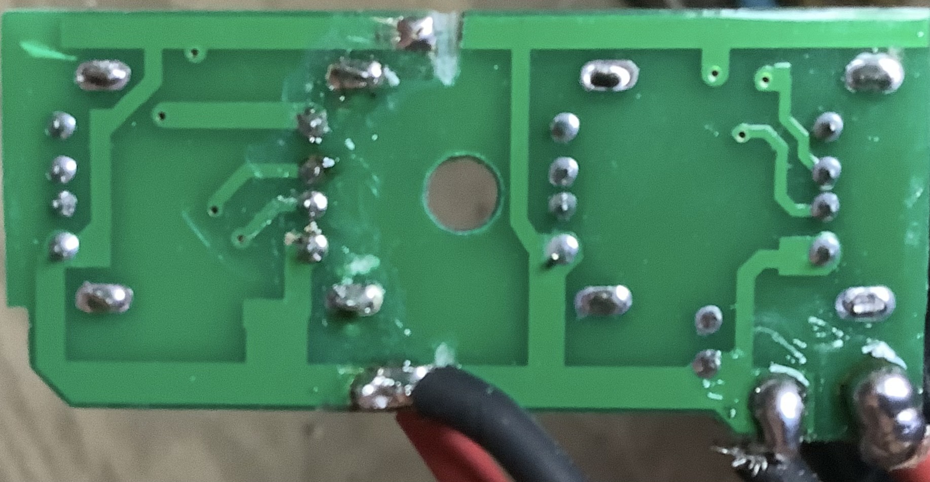

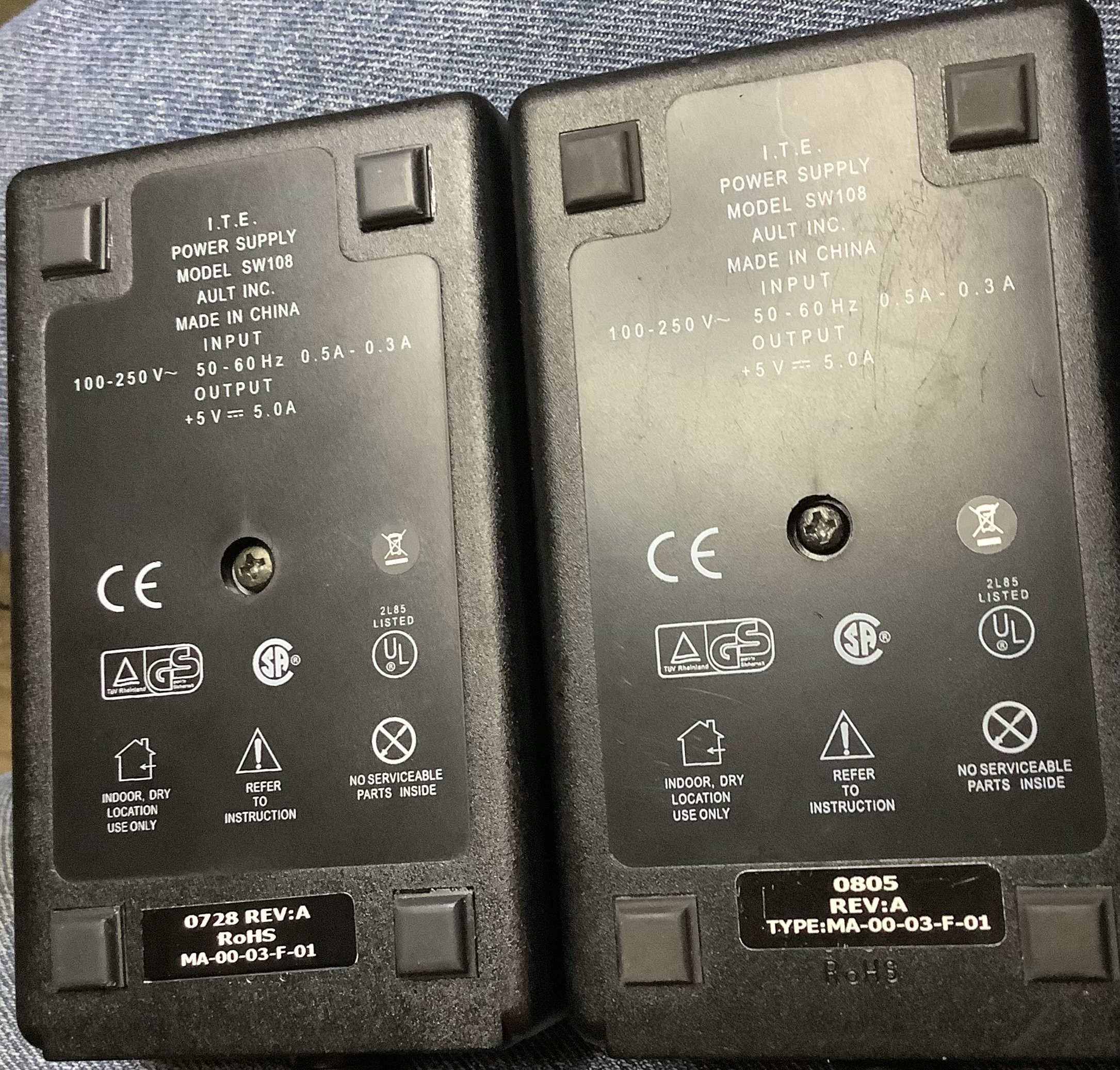

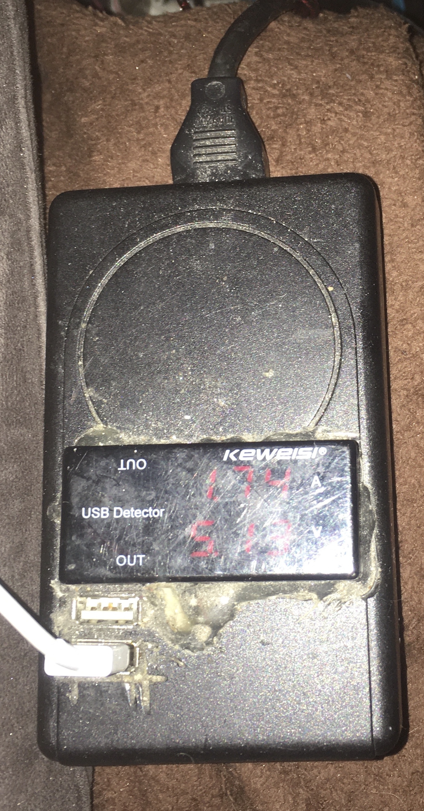

    Click image for larger version Name:	C5D150B3-BEB4-4E98-81A3-5D58C94C3281.jpg Views:	0 Size:	1.56 MB ID:	3153500 Click image for larger version Name:	IMG_0521.jpg Views:	4 Size:	1.20 MB ID:	3153477 Click image for larger version Name:	IMG_0520.jpg Views:	3 Size:	1.57 MB ID:	3153465 Click image for larger version Name:	IMG_0519.jpg Views:	0 Size:	439.6 KB ID:	3153462 Click image for larger version Name:	IMG_0517.jpg Views:	0 Size:	2.69 MB ID:	3153463
    Here are some Pictures the first one is the Original USB two USB outlet second one is the completed project the third one is the switching power supply's that I am using the fourth picture is the back of the USB outlet board the fifth picture the USB doctor voltage and current meters the sixth picture is front of the USB outlet board now I have to work on the enclosure but this might be tomorrow or the next day
    One note the reason why the voltage is higher on one switching power supply is because there is no load on it and because there is a slight voltage drop when using USB doctor voltage and current meter module
    So there are two USB outlets one that has the LED indicator light the bottom two USB outlets are on another switching power supply so that way if I have two tables or a phone that very low on charge I charge two them on one power supply or on two separate switching power supplies

    One final note this is not the battery charging station that I mentioned in the previous post above because I do not have the need to repair switching power yet I still waiting for them to get here and that is a separate project but I going to modify the USB doctor voltage and current module the same way as I did in this particular project stay tuned more to come later
    One more details to about the 5 volt @ 5 amp switching power supplies I bought quite a few of them several years ago I bought these surplus from Electronic Goldmine every time they had a sale on them until they ran out of them I also have the 12 volt @ 3.5 amp version as well but I do not have as many of them as I do of 5 volt versions ones and they get recapped before they are put into service
    These switching power supplies are very well made and they are medical grade equipment type that was the biggest reason I bought so many of them when they were available for sale
    I once ran a torcher test that I was drawing around 5 amps for over an hour and the case only got warm to the touch so I have no issues with running them at 5 amp for a period of time unattended in operation

    Well I managed to rough cut the front panel on the enclosure panel and mount the USB outlet module to the face plate but now I have to get JB weld for metal and fix the over cutting the window opening for the voltage and current meters that is next and cut out the the electrical cord outlet and screw it to the metal plate and remove the two on the switching power supply board and wire them in parallel paint the front panel black and it will be completely done maybe next weekend but we will see if I have to work Saturday morning and how late it gets it might not happen next weekend but we will see
