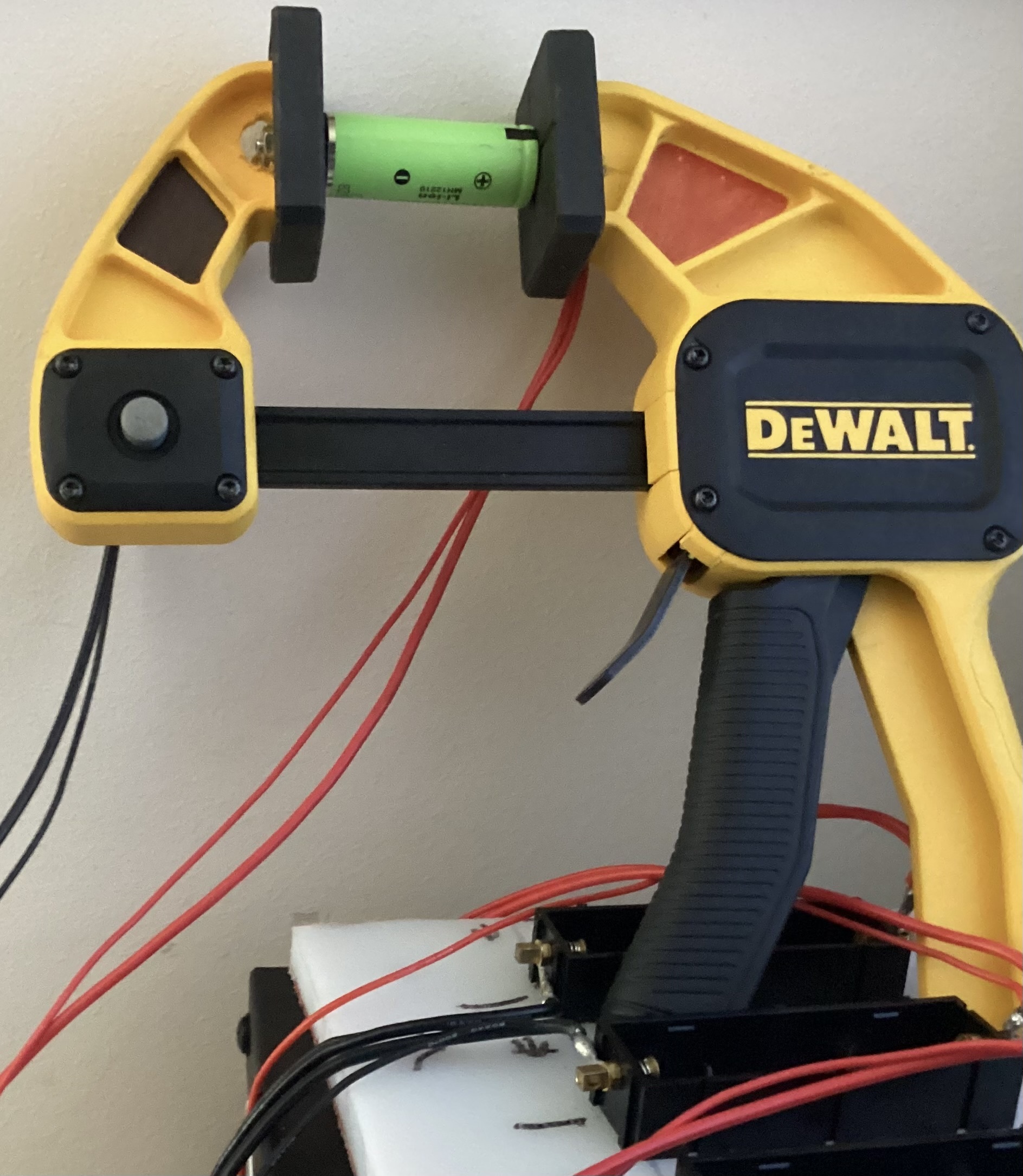

      I would only do that as a last resort but before I would do that I would modify the case of the label maker
      I do not have a battery holder for a 18500 battery size I was suffering on the internet last night looking for some 18500 battery cells when I stumbled on this website and it was about testing 18500 if you do not have a battery holder he used a sliding clamp that you can buy from Home Depot or Lowe's for clamping wood together when you need to glue two pieces together but he used a copper strip about 1/4”inch wide and about 2 or 3 inches long I personally did not like doing it that way but did it like this here is a picture of it
      It is working better than I expected it to but I like the fact that it has rubber feet I drilled a hole for a 6-32 flat head machine screws in the center of the clamp foot on both sides and used the wire harness for my battery testing machine that I had extra used one nut against the fat head screw and a crimp terminals one on each side and went through the clamp foot and another nut on each side and marked the positive side red and the negative side black
      What is nice about this this battery holding jig is that I can use any size battery cell I want to use on it up to 4.5 inches long
      Here is a website link to the clamp that I use and going buy a few more clamps for several more battery holding device jigs for testing odd ball sizes
      https://www.homedepot.com/p/DEWALT-4...3191/204987956
      Let me know what you think of creation that came up with an idea that I saw on YouTube video

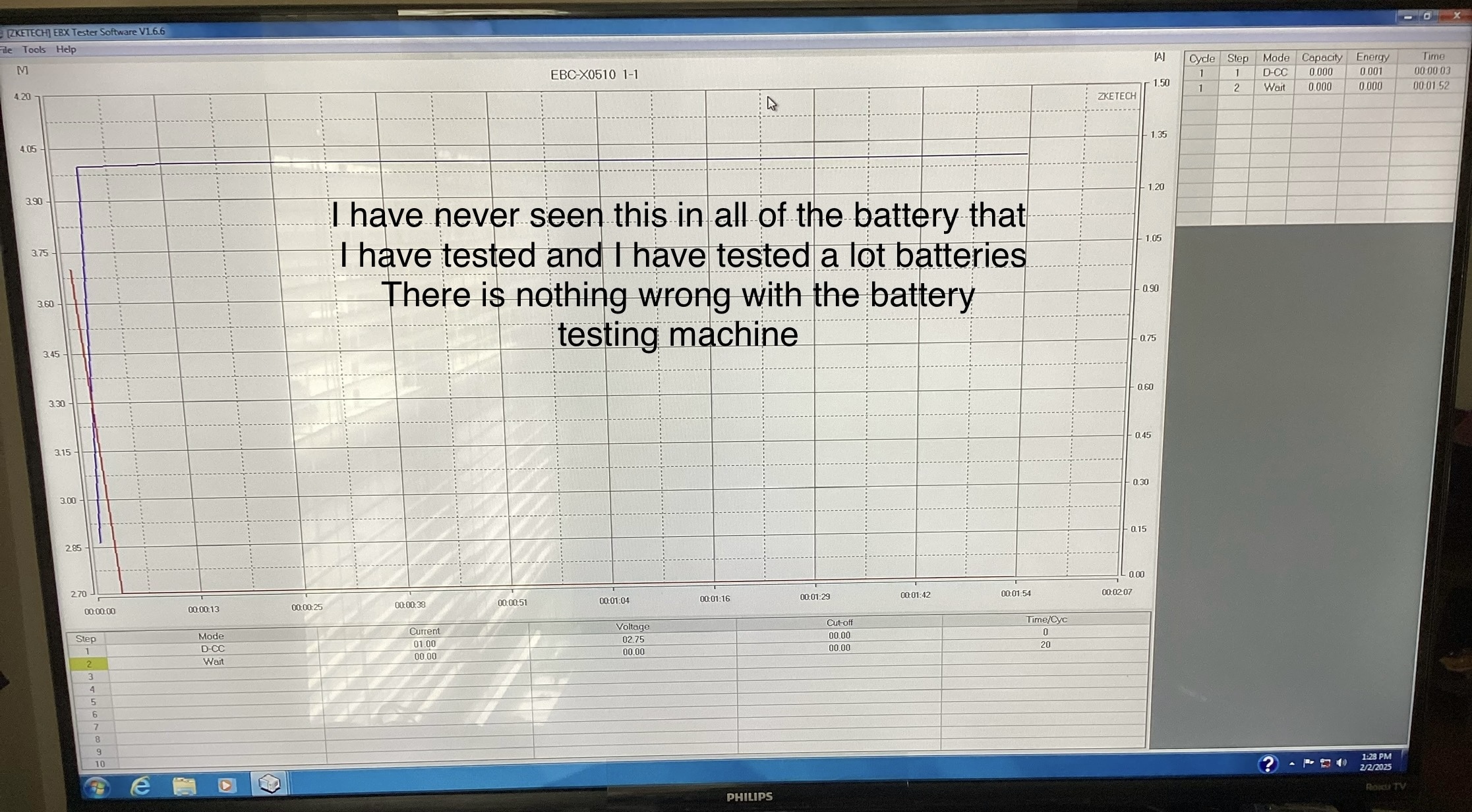

        Here is the results of best battery in the set of two in both bunch of battery cells
        This is almost the worst battery charging/discharging cycle I have seen a long while ( graph chart shows to steep of a decline and shows to steep incline I am surprised that it a little bit over 900 millimeters before it drops drastically
        This definitely not worth $12.00 a cell that is the reason I asked for a refund I thought at first that may SkyRc battery tester was having an issue with monitoring the voltage/current but I can see that this is not the case
        But this typically of poor quality Chinese made battery cells and I am surprised that Panasonic puts there name on such poor quality battery cells

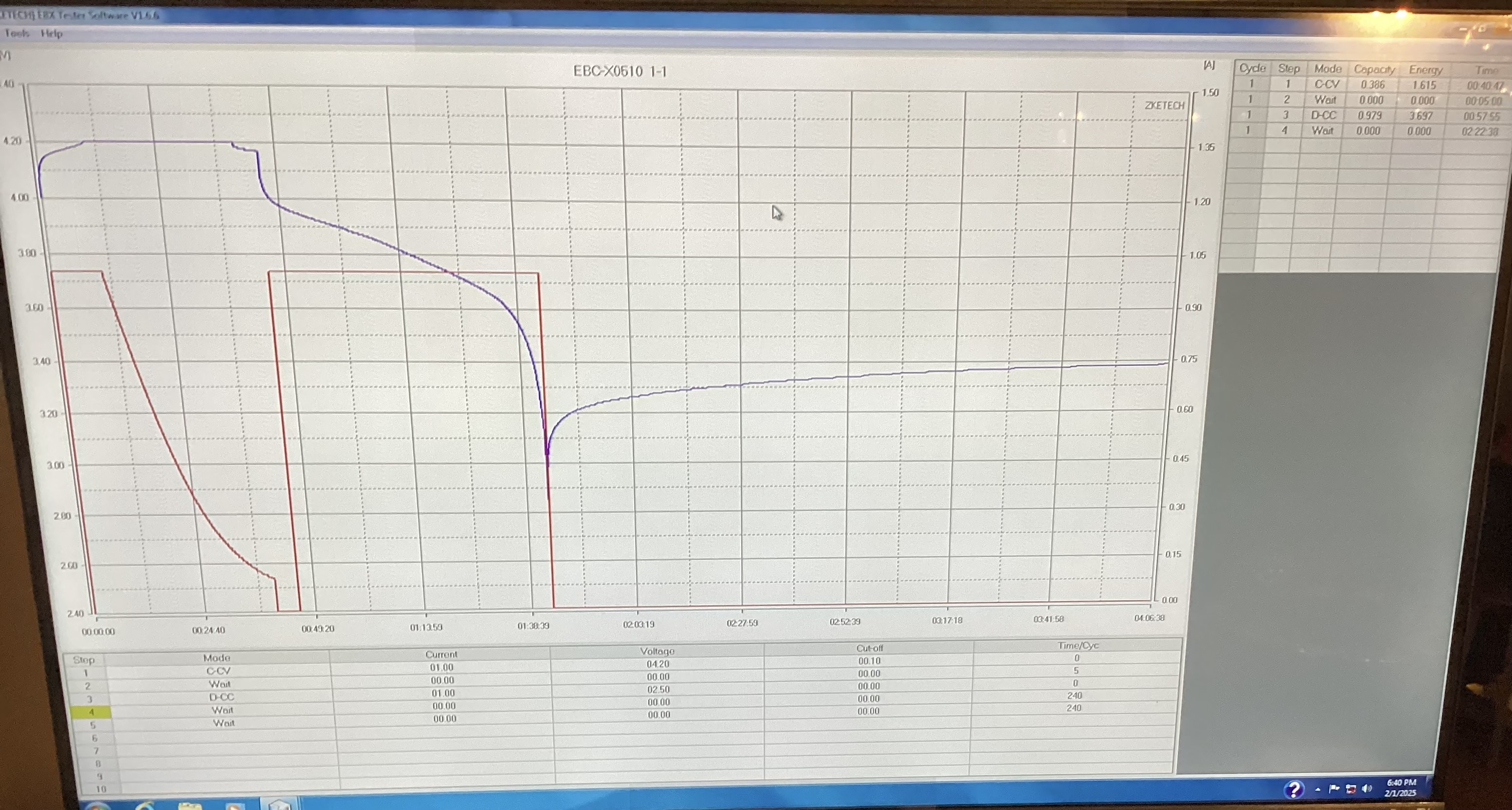

          Here is something that you might find interesting about the test on one of the battery cells in the 5200 label maker battery pack has a battery failure
          The second picture is a battery cell from one of my solar panels that I have it is also not worth a shit

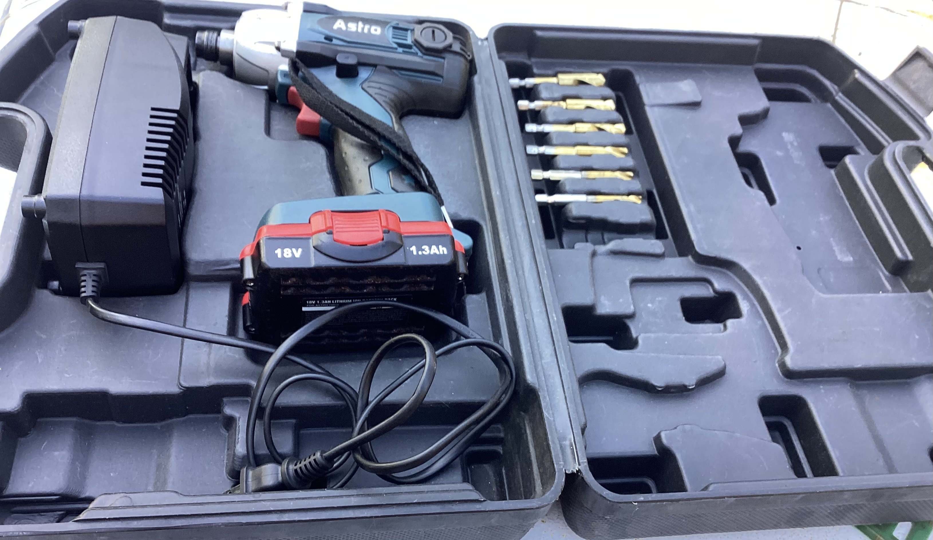

            I am testing some 18650 batteries for a tool that the rivet installation part of the tool broke but I decided to use when I need to drill out rivets that have gone bad so I change the battery holder jig from 21700 to the 18650 battery jig
            Because the original battery cell are Chinese made and everyone of them is completely dead no voltage when I was using it the running time was not great in the first place I thought about putting better battery cells and about time was about to do this riveting part of the tool went bad so it just sat in its case and I kind a forgot about it saw it the other day and because it has a set of drill bits that fit in the case so this is reason for bringing it back to life
            Unfortunately the draw back about this tool is the riveting part of tool can not be use on an in pack tool is because the riveting part of tool screws on to the power tool part of it now the inpack tool does have quite enough power to install 1/4-20 rivets with no problem now you install bigger bolts but then it strain to install them and that is how rivet part of tool broke one other issue it had was it had to much power for 8-32 and sometimes to much power for 10-32 screws it would sometimes stripping the threads right out of rivet
            When I bought a replacement tool for installing threaded rivets I bought the style that is separate from the impact tool which you can use and impact tool you want so I bought the new Milwaukee impact tool that has torque control on it and do not have the issue with it stripping out the threads unless I hold the power switch to long then it still can happen

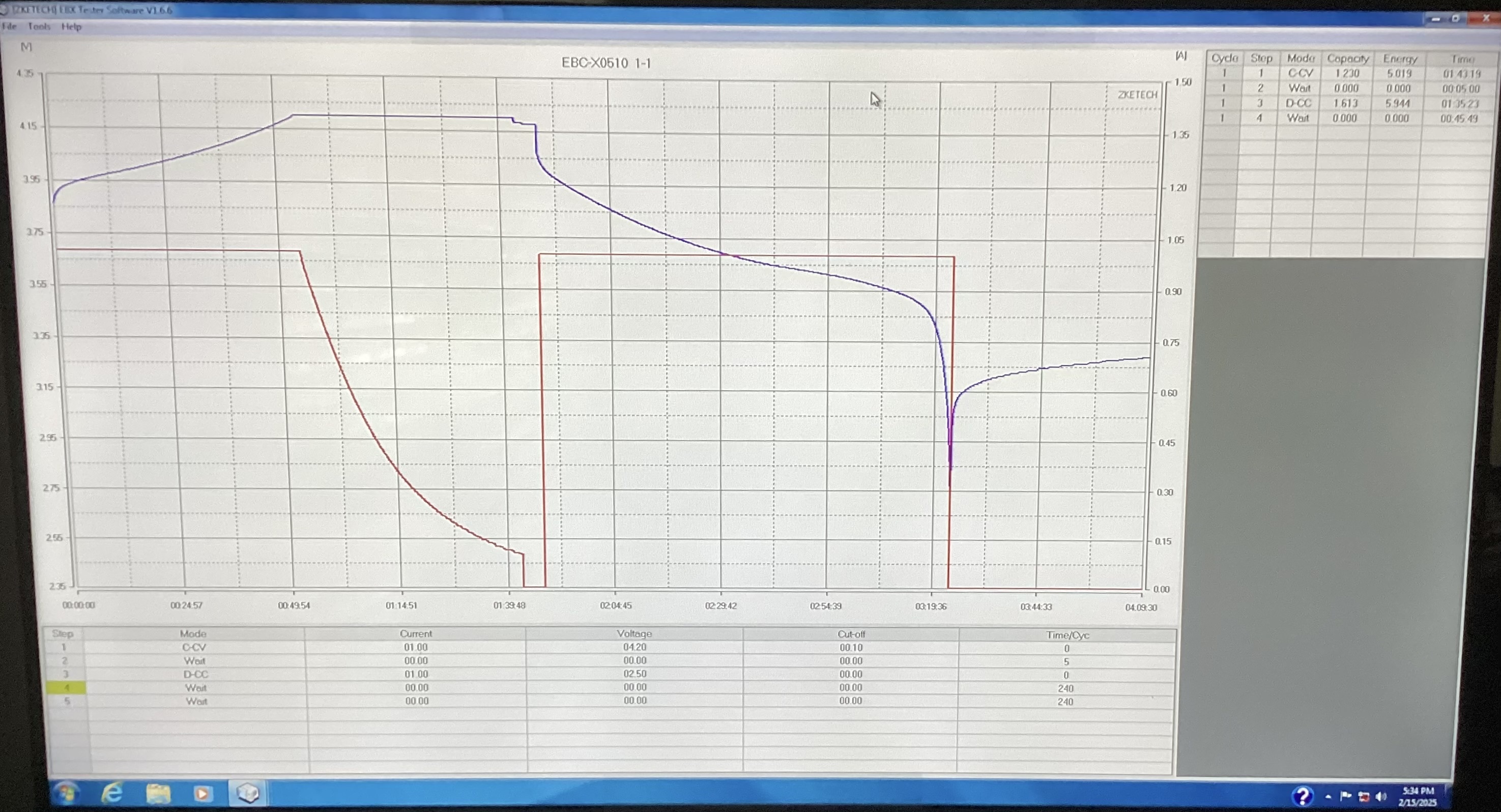

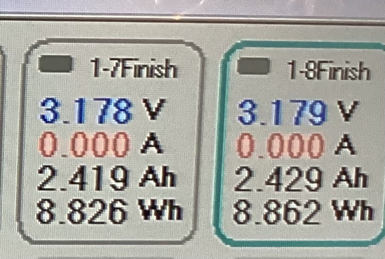

              Well I have finished testing eight 1865-30q battery cells and the test results are very good for slightly used battery cells from Battery Hookup that bought awhile back in fact I only checked the voltage on them did not even test one yeah I should have tested a couple of them but did not probably because I really did not have anything in mind other rebuild some Ryobi single cell battery packs that I still have not gotten to because I have 3 and 4 amp battery packs that I use when I need or two of when doing a project
              The test results are from 2.922 to 2.928 very close to each very good the highest one was 2.939 to 2.884 the lowest and one was 2.901

                Here is the tool that I replaced the battery cells in it works perfectly fine now maybe even better than it did new
                The only issue I had was because these battery cells are a little fatter than the original ones I had to modify the top of the battery pack enclosure so the release mechanism would work correctly but that fine
                In fact now it is a 2.9 amp hour battery pack instead 1.3 which what was in it

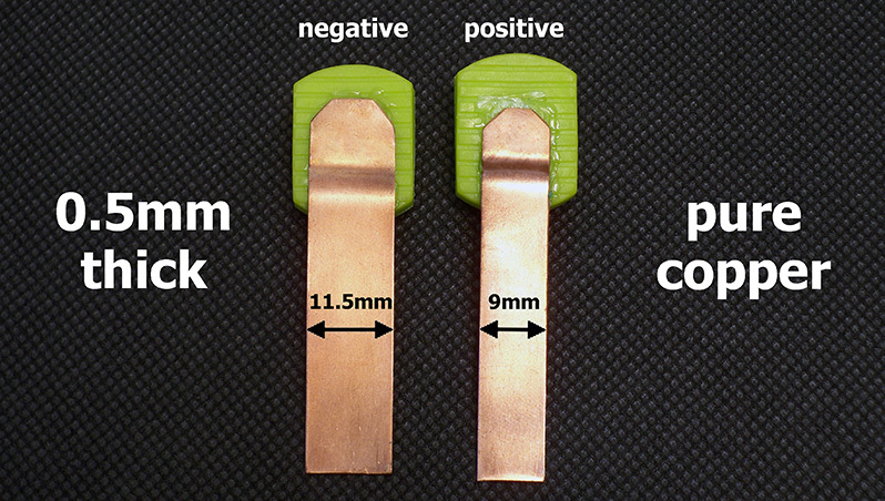

                            Now I will probably have to use tabbing strips to hook up the battery cells to the board if there is enough space between the battery cells and the enclosure if not I will have to use 18650 battery cells and they are 25 amp current capacity output type
                            One note that the two battery cells are glued together and I did not want to separate them and ruin them so I just tested together and iI have plan on using them for something else later

                                        These are the 18500 size battery cells
                                        1.615
                                        1.613
                                        1.607
                                        1.603
                                        These battery cells are very close to each other these are 1.700 milliamperes hours they did not get to over 1.7 but they are very close to though
                                        I will be putting these battery cells in the two battery packs and charge them up and start using them
