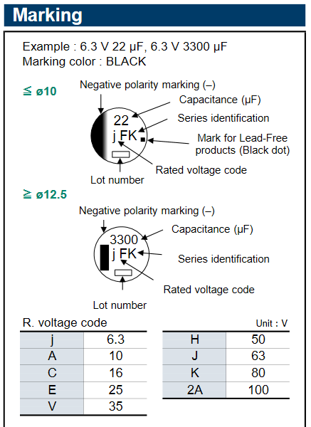

    Help identifying Aluminum Electrolytic SMD cap values
    I am trying to re-cap a Tivo unit, but am unfamiliar with how to decipher SMD Aluminium cap codes to capacitance and voltage values to swap them out. Here's what is on each cap

    Re: Help identifying Aluminum Electrolytic SMD cap values
    Markings for the Panasonic FK parts
      So I have two Tivo's and it turns out the other Tivo has all Panasonic caps, so I can read them all. the first one has a mix of manufacturers with different codes
      So in the interest of posterity in case anyone stumbles across this in the future and is looking for similar Cap values, here's what I got off the other Tivo:
      Cap #1: 22uF, 35v
      Cap #2: 15uF, 16v
      Cap #3: 220uF, 35v
      Cap #4: 220uf, 16v
      Cap #5: 47uf, 35v
      Cap #6: 1uF, 50v
