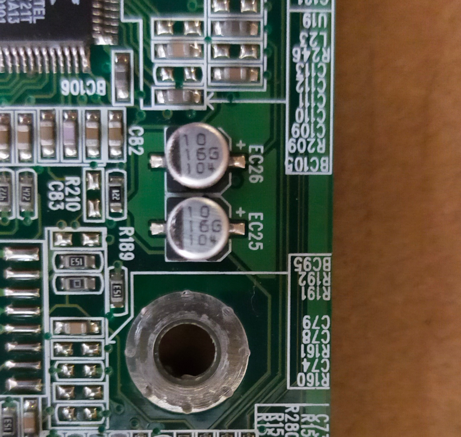

    Hi wonderful people. I have a MS-6315 P3 motherboard with very tiny Aluminium electrolytic capacitors. I've made an attempt to identify them from what ive learned so far they might be
    Aluminium Electrolytic
    G = Series
    10 uF
    16 = Volt
    104 Date code 2001 April? (not really important, but interesting)
    Please help to confirm or correct if i am wrong. Thank you

    yes 10uf 16v.
    gp leaded parts or mlcc/tantalum work as replacements.
    replaced probably 5000 of those in motorola spectra/astro spectra alone.
