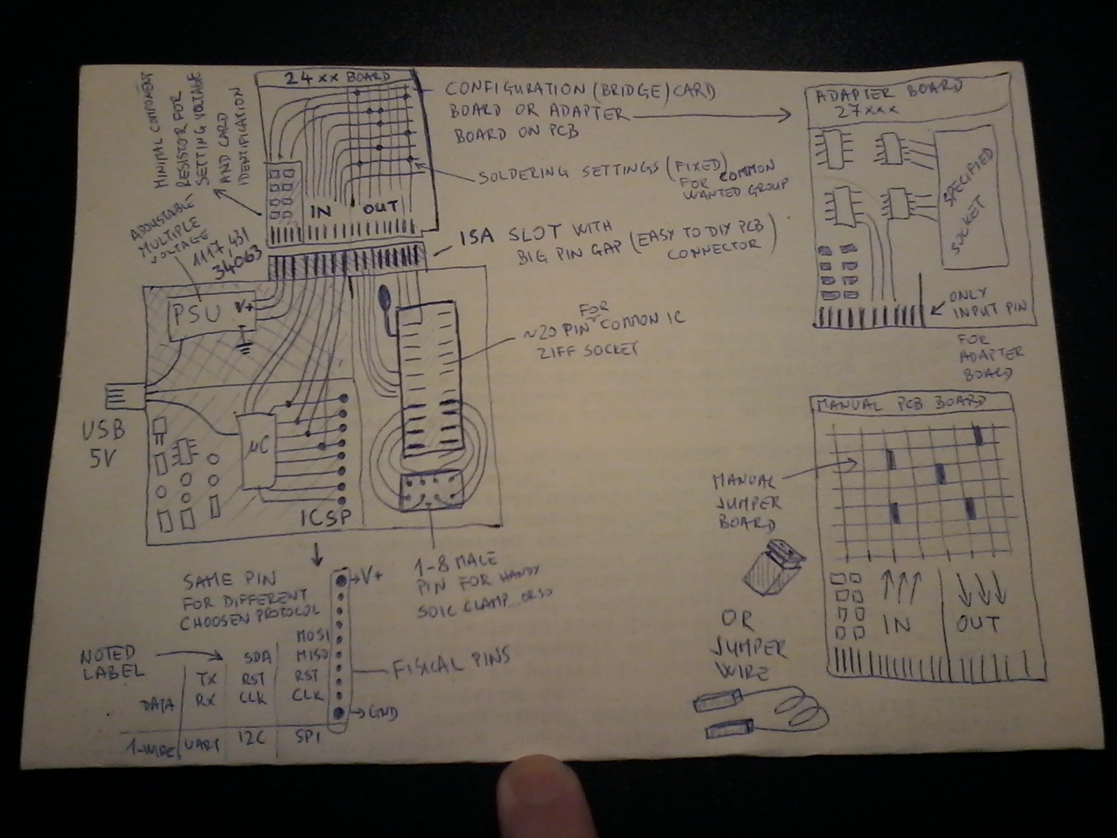

      it's completely fine that what I'm writing makes no sense - I don't have enough knowledge about this topic, but I want to get some information through the discussion and maybe give an idea to someone who has the knowledge and the ability to create a new generation of DIY programmers.
      as for the signals on the pins and the waveforms, I don't know anything about it at all and I wouldn't pay attention to that at the moment. I think that for most protocols, 8 separately controlled channels, such as cheaper DIY microcontrollers or arduino uno, nano... along with power lines, are quite enough.
      but, I think that the design itself can be improved a lot, to get a much more flexible device with which any desired chip can be programmed. my basic assumption is that if the datasheet of the chip is publicly available and if the chip is intended to be read/programmed, then there must be a way to do it without constantly buying various adapters that always fail... always needs some "specific" you dont own...
      for example, changing the clock frequency and timing would should be adjustable via programmer software, while the voltage could be adjusted by hardware - from 5v from the usb connector to any voltage using 34063, 1117 and similar.
      My original idea is that the software interface enables you to input of new data from the datasheet in order to create new conditions for communication on each channel. and it should be made as simple as possible, clear and intuitive as possible for all important parameters.
      therefore, there would not be a list of thousands of supported chips, but only groupings, categories that include the same characteristics.
      eg if the i2c protocol is created, then it doesn't matter if any chip from the 24xx series is programmed or accessing the temperature sensor or the BQ eprom of the battery.
      if an individual chip requires an additional signal in addition to the i2c protocol, it can easily be included on a free channel, as well as changing that i2c protocol as needed.
      I see the different layout of the legs as the smallest problem. first you need to come up with a basic "bare bone" model that will not change, and that can be easily modified or add an adapter as needed. here's how I imagine it right now in attach.

          forget it,
          for anything not serial your gonna need 22-42 pindriver circuits and your not gonna find decent software to run it anyway.
          best bargains are the XGecu units, if you dont need more than 40pins then T48 and if like me you get 42pin roms then T56
          and software updates are regular with new devices.
          https://www.aliexpress.com/item/1005004419266579.html
          https://www.aliexpress.com/item/4000802208288.html
          to get better than that your looking at 600+ for something like a UXP48, and even they arent great because they charge for software updates! (bastards)
