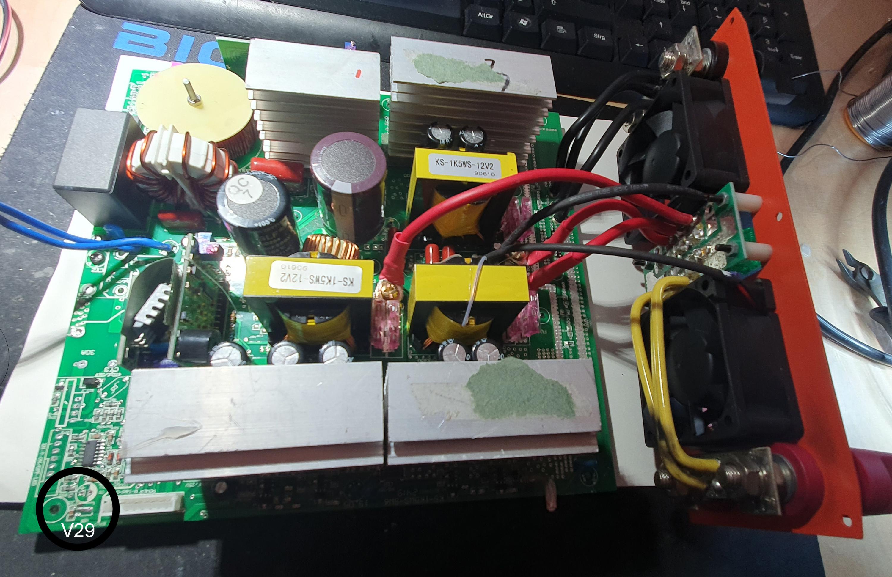

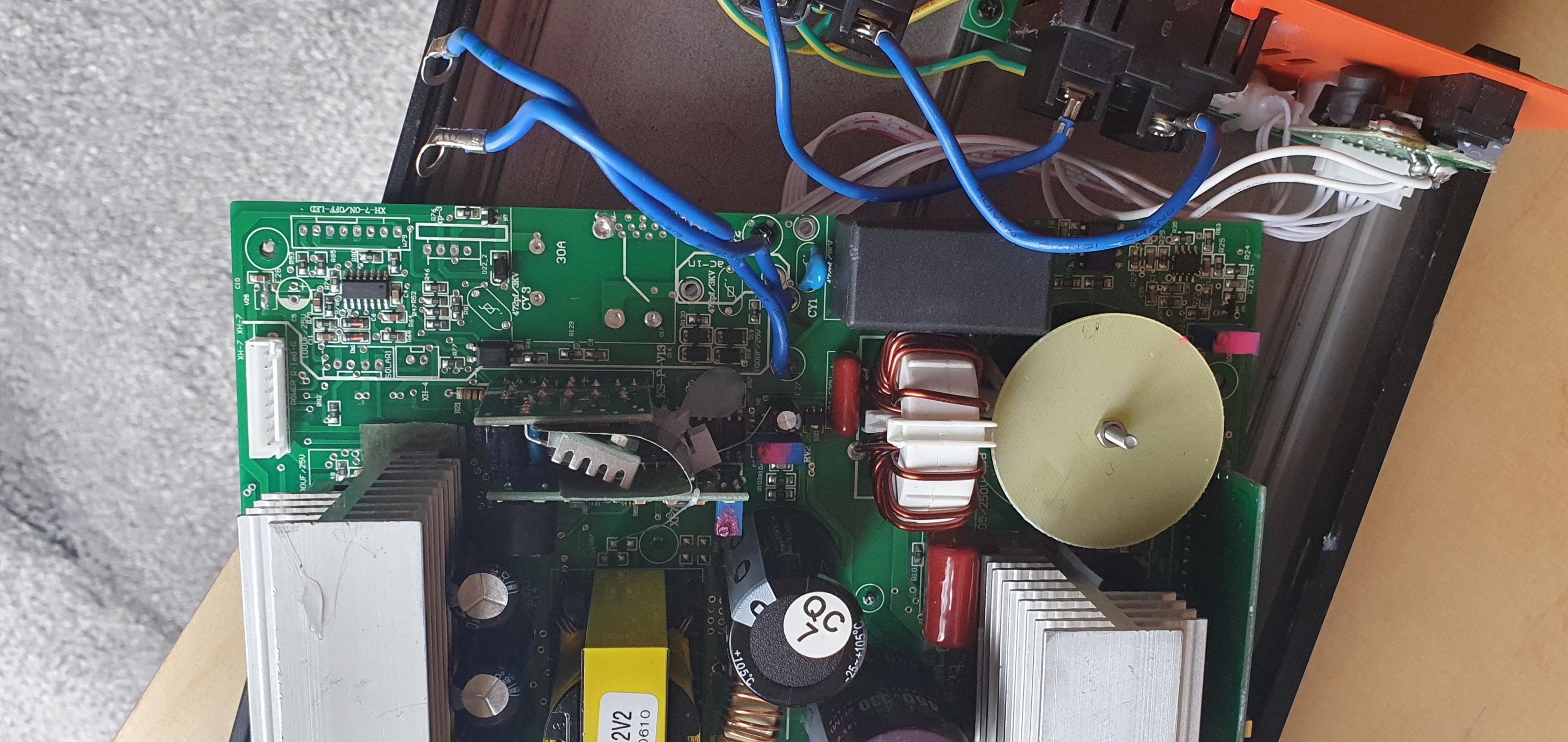

    hello,
    i hope you can help me. on Place G29 (see black circle on Foto left) there was an short circuit and i can`'t read anyone.
    at the ciruit board are some D882 and B772 but i have no idea what ist built on this place 29G . I see there is the power current input
    who can help me please
    thanks Achim

    Re: Ective Si152 fault
    D882 - 2sd882
    b772 - 2sb772
      thank you but which was on place 29G ?

          no one ? who can help me please ?

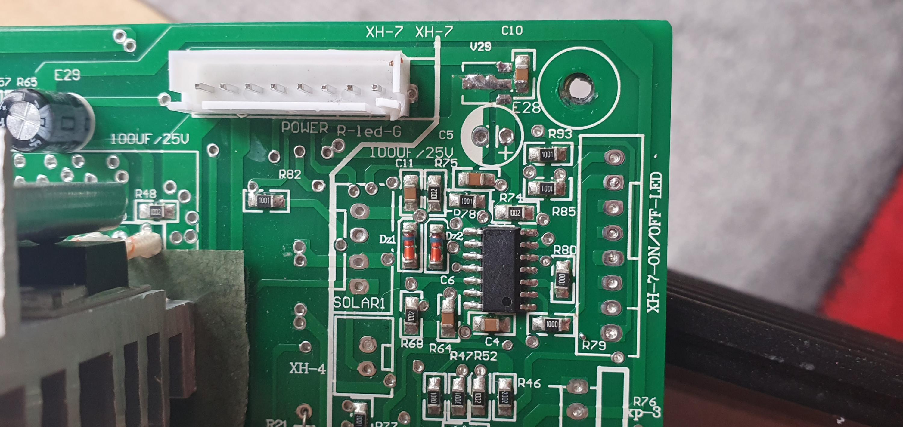

            better picture please

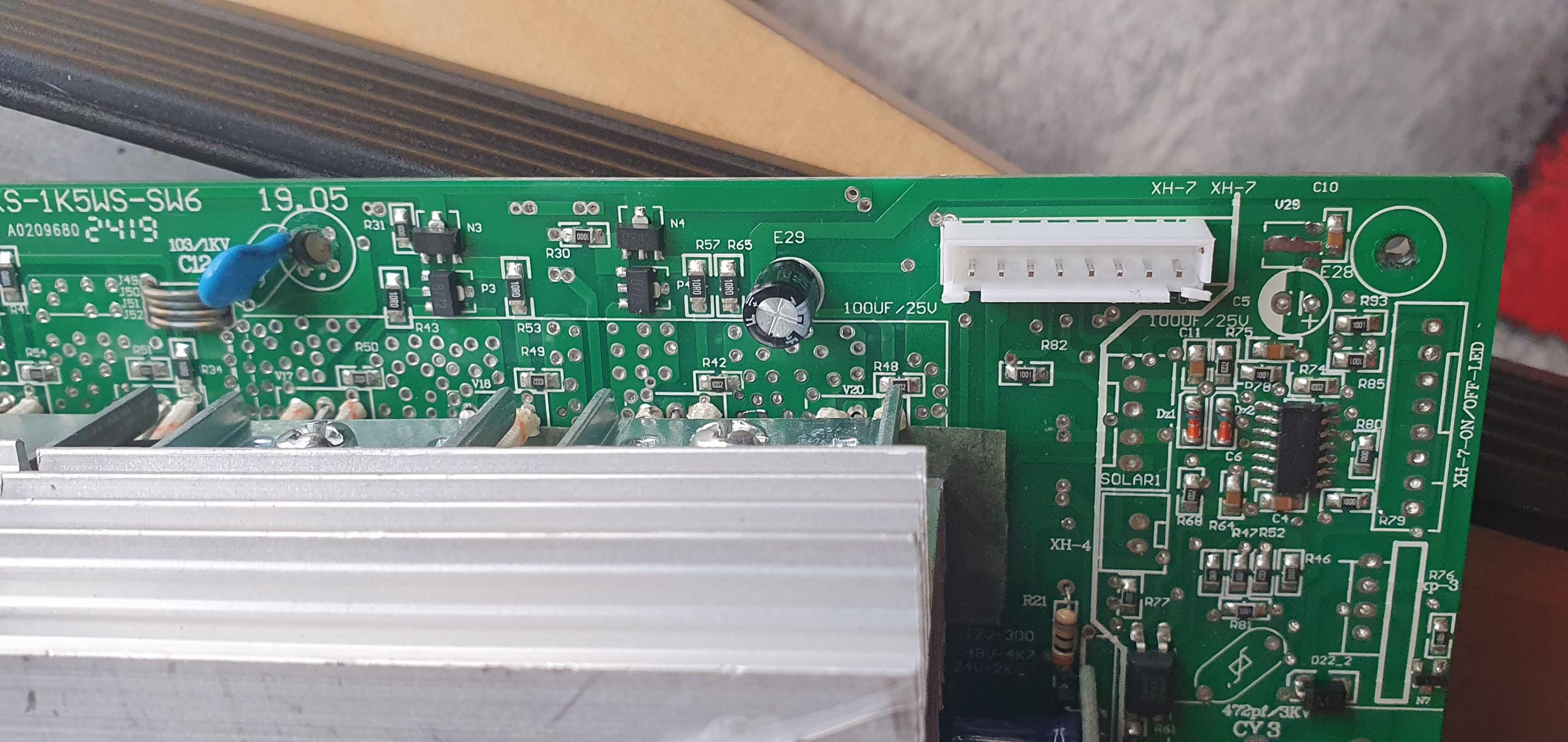

                i can't add fotos at the moment ??
                  ok now
                    Do you mean V29? Looks like a SOT-89 package, a LDO. But what voltage?
                    Looking at the pinout, out-gnd-in would be OK with a 78Lxx. Not A1117.
                    You have to figure out the voltage of that regulator IC.
                    The SOIC below has no markings on it. Is it a MCU? Then wild guess, 78L05.

                      thank you , i wood looking at this
                        hello its a bc946.
                        Who knows the smd code ??
                        i didn't find it online.
                            Originally posted by Achim64Germany
                            hello its a bc946.
                            sorry this is BD946
