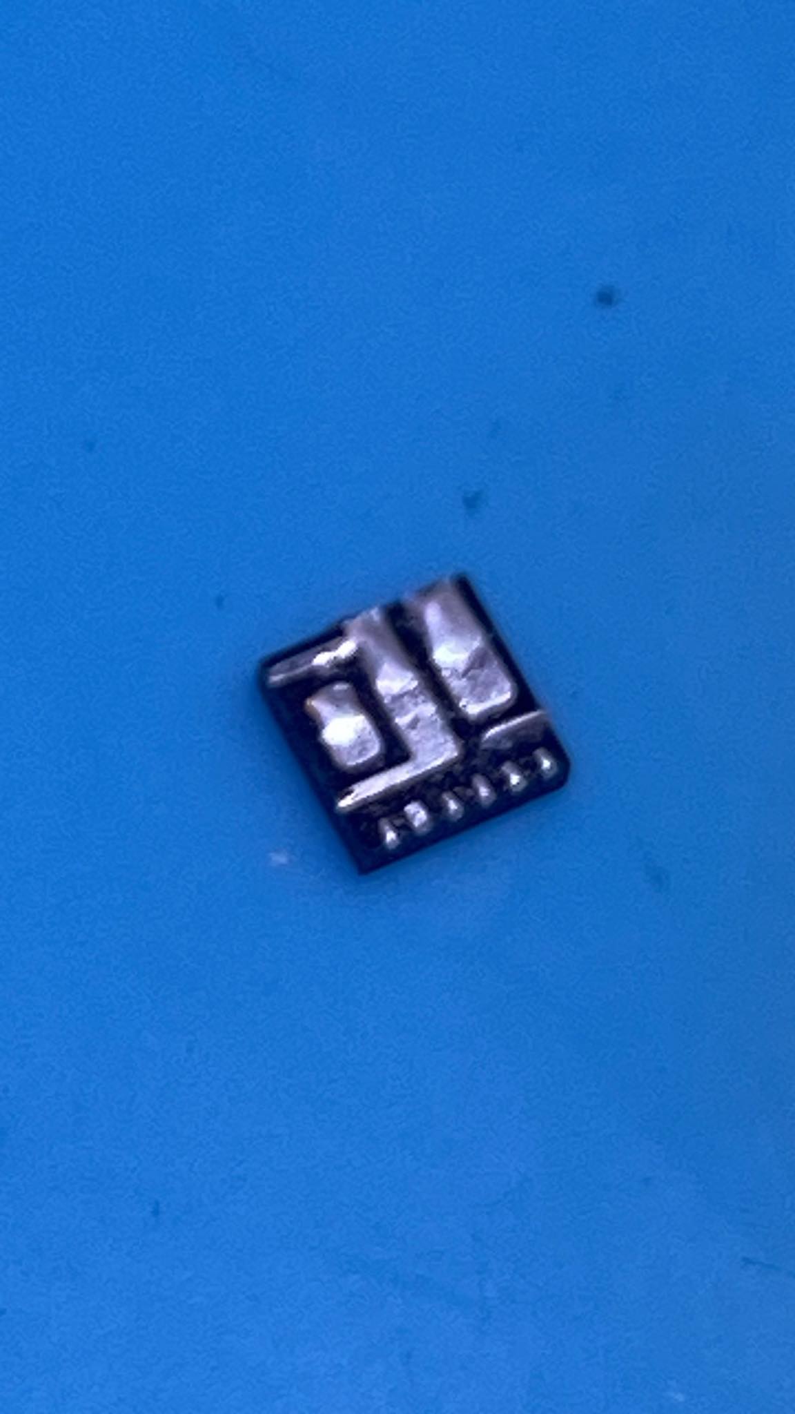

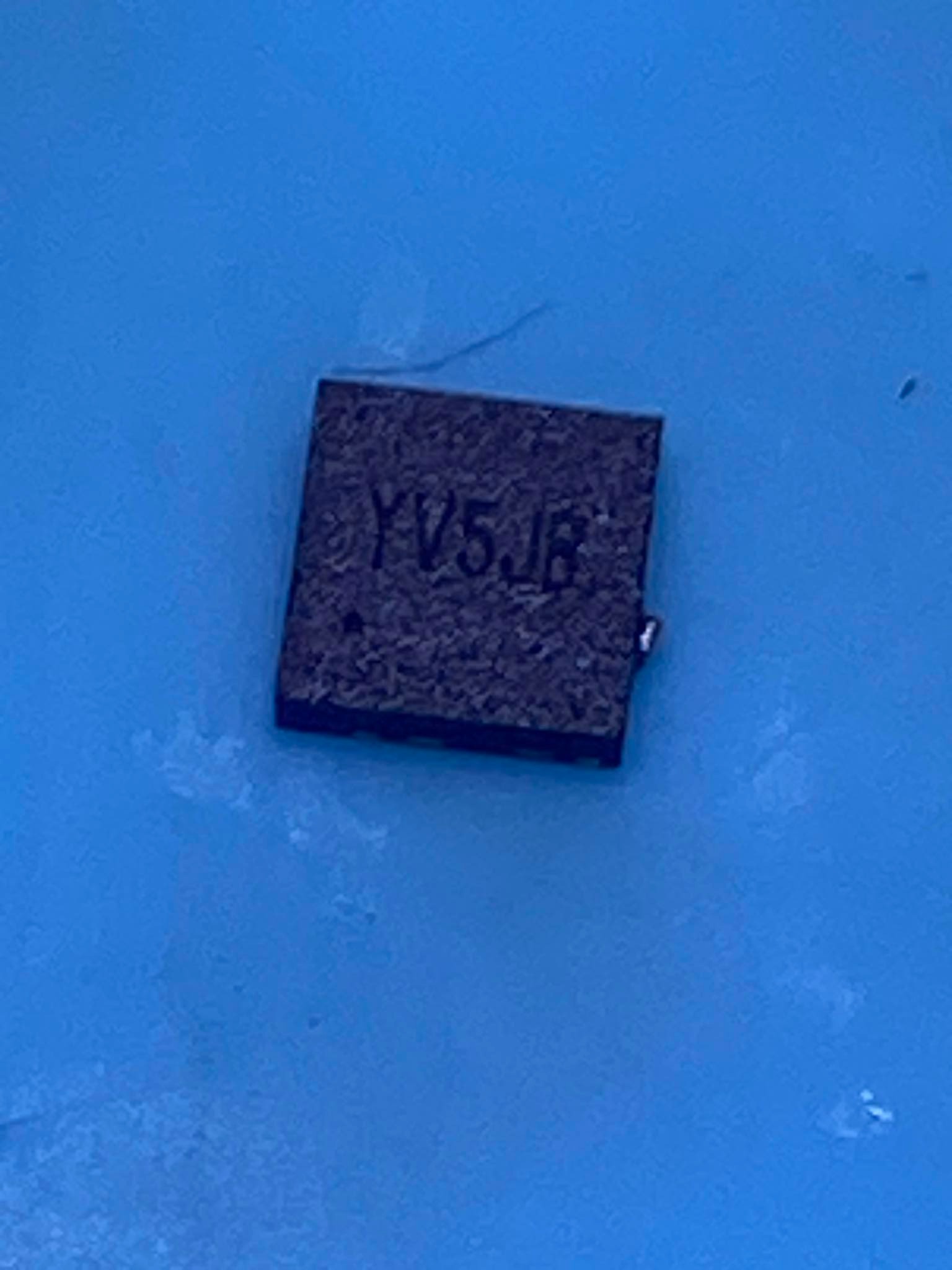

Anyone know this parts?
  • ambetz12
    • Jul 2011
    • 16
    • Philippines
    hello can some identified what part is this i cannot get any schematic for acer z35 lcd screen. thank you

    Re: Anyone know this parts?
    This is Synchronous Step-Down Regulator. Part number: SY8208
      I agree with above
        This is YVxxx - SY8366QNC. https://aliexpress.ru/item/100500134...00015769558204
        https://www.alibaba.com/product-deta...187248197.html
        https://www.ebay.com/itm/403518669814
          thank you so much for the reply
