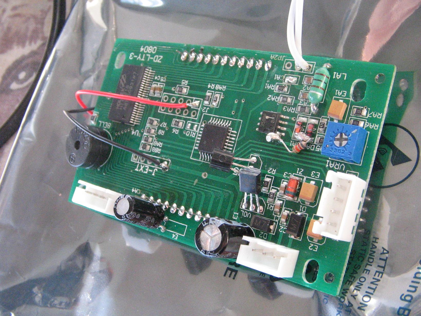

    I recently got up a Duratech TS-1574 quite cheap. Originally from Jaycar no doubt
    They sold it apparently because the iron was not working, but this does not matter as I already have 3 other irons anyway (I think the heater is stuffed but not 100% sure)
    The real issues is that is seems the LCDs have issues - some segments not displaying properly (see attached photo)
    This is only apparent on the "set temperature" part, not the "current temperature" readout.
    Also, the backlight of the left display is much dimmer than the other, though this is hardly much of an issue...
    Has anyone heard of this happening before, or is there any likely issue to cause this in LCDs?

    Re: Duratech TS-1574 hot air rework station - LCDs not working properly
    that stuff is also sold as "Duratool" and some other names,
    it's very good when it works, but the soldering isnt always the best.
    check the soldering.
      Dry joints you think? I guess it doesn't help that it was sitting around doing nothing for the last 6 months, I just discovered...
      -David VanHorn
        • 31260
        dry joints?
        more like crap joints!
        and dont dismiss the backlight issue - that's a big red flag that the power isnt getting where it should in that board!

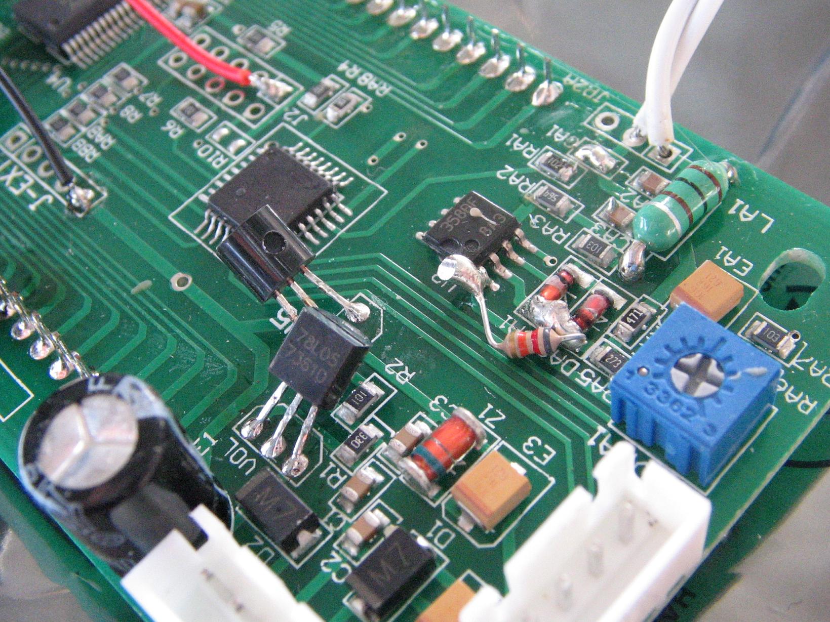

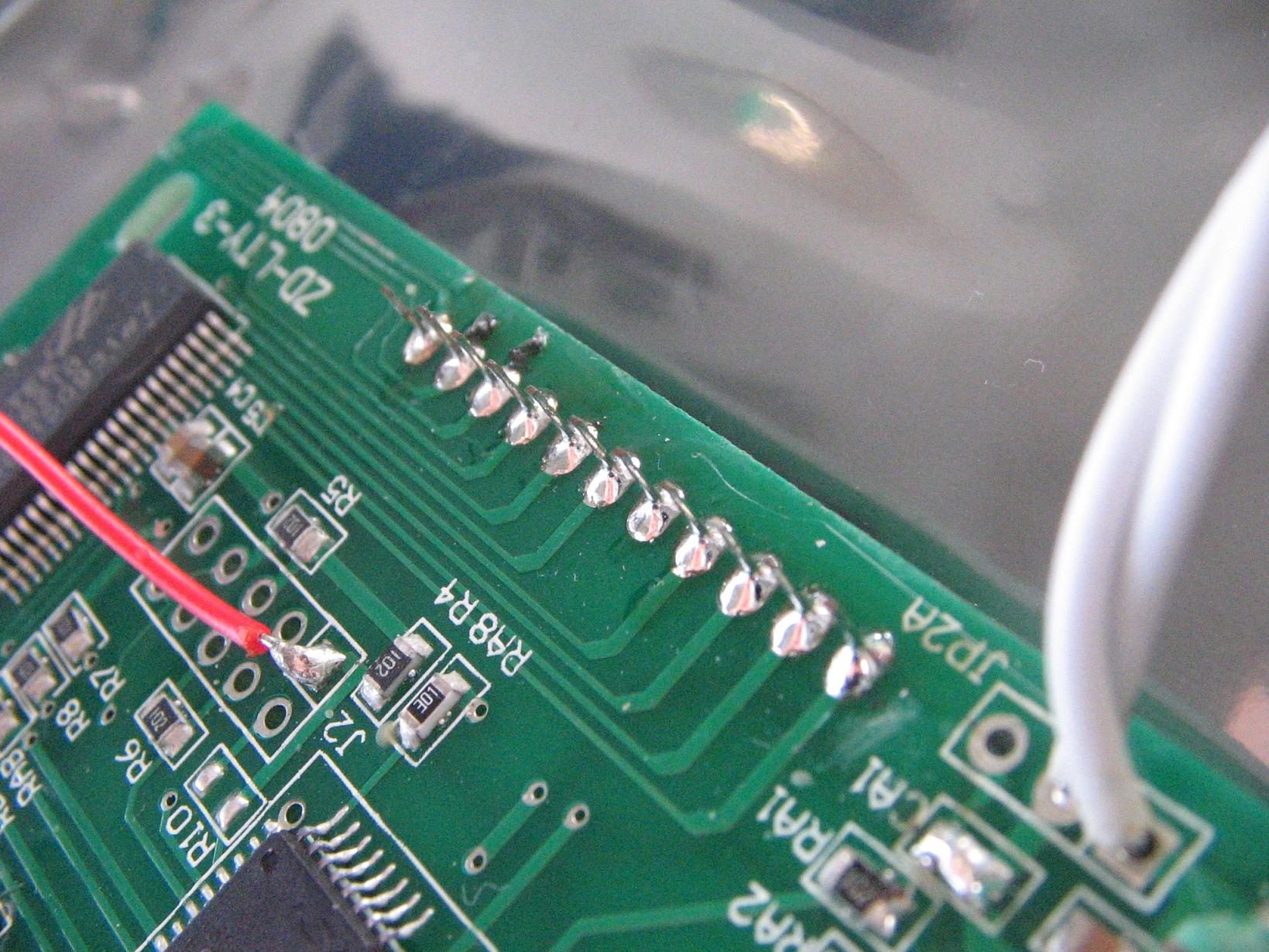

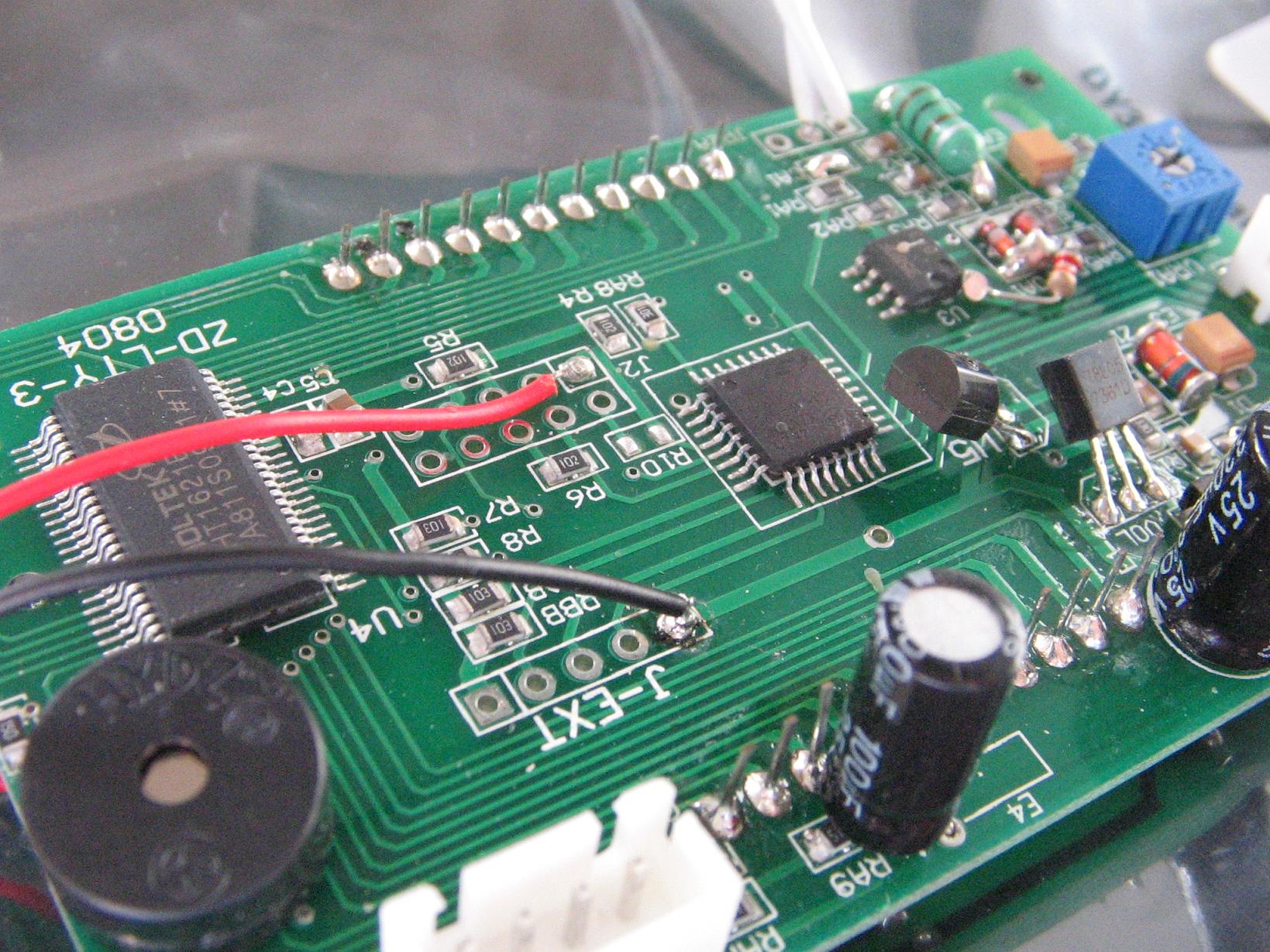

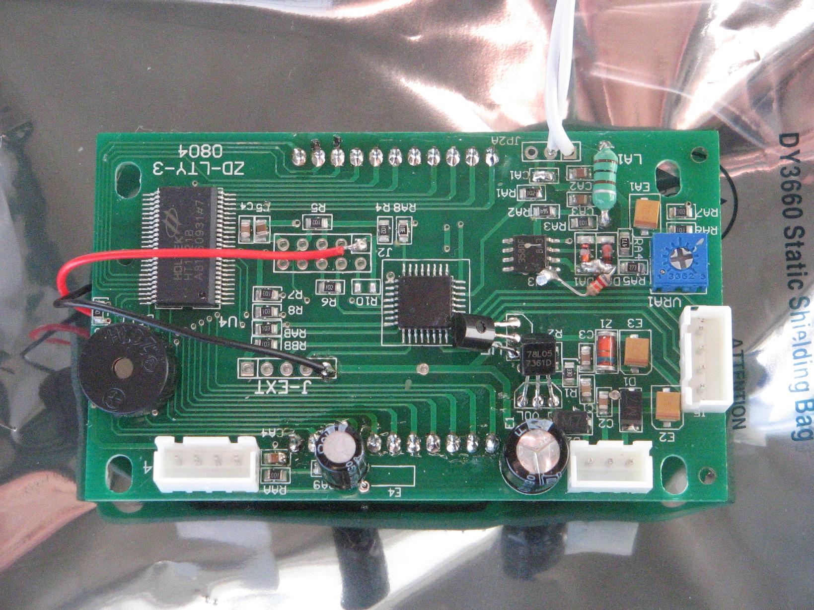

          I've opened it up and took some photos of one of the control boards.
          I had to shrink the photos to attach them so the full size originals are on Flickr as well
          http://www.flickr.com/photos/agent_2...7624328897833/
          I don't really have much experience in spotting crappy soldering, but to me these seem to look OK.
          What do you think?

            Also, checked voltage to the backlights: 3.04v on the good one and 2.96v on the bad. I'm guessing the light is either stuffed or there is something else wrong...

              Bad solder joints in a soldering station? That's like putting bad caps in an ESR meter.. Oh wait, that's been done...
                Looks like I missed what is probably a critical piece of information.
                When the iron or hot air is turned on, the LCD gets self-tested for about a second. During this time, all segments are turned on.
                On both LCDs, all segments are fine during this startup test. (can't believe I didn't notice this before!)
                I did try resoldering the connections on the LCD, but it didn't change anything.
                I guess the problem lies with the controller or LCD driver IC and\or connections rather than the LCD itself.
                What now?
