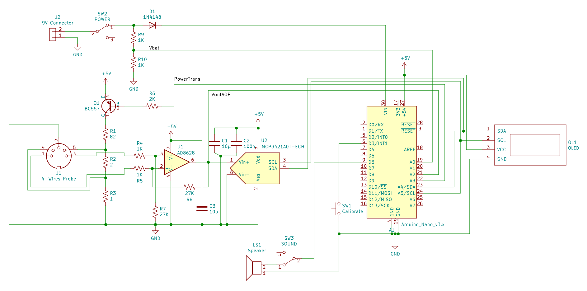

                  Re: Short finder
                  All that is missing is a PCB layout? It's not that complicated, it's just people wanting changes and complaining etc. that takes away all the fun.
                  http://kripton2035.free.fr/Projects/shorty-display.html
                    • 30979
                    Re: Short finder
                    no, we need the revised scematic with the new current-source
                    • megaraider
                      • Jul 2015
                      • 307
                      • Portugal
                      Re: Short finder
                      No need
                      The current source problem arises from using the 5V output line from the Arduino Nano.
                      As he wrote somewhere he couldn't figure out why the voltage (5V) dropped when the tips were connected. The LM1117IMPX-5.0 max. load current is 800mA.
                      While that might seem to be enough it's not: one must take in account the Arduino ICs, display, DAC, Op Amp and tips current source overall power consumption!
                      Therefore, replace that 5V line with a reliable 5V power supply.
                        Two things, the PCB layout is missing and kripton believes there's something wrong with the schematic.
                        So I think in the other thread people were discussing how to fix it. Also discussion of some features, true, but if you are doing a new layout, why not add some stuff if it's easy. Adding a regulator that supports battery use (not my thing, but I don't see a downside) and my personal one was upgrading the MCU. But I don't have pcb skills (yet) so I'd likely just take any board even with an arduino. But if someone with pcb design skills likes the idea of the rp2040 board, I can be point on the software...
