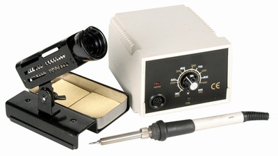

    A while back I was given a Jaycar "Duratech" TS-1560 soldering station (the Hakko clone) this one:
    The heater is rated at 50 watts, 24vAC.
    Bought some extra tips for it from eBay and recently decided to test it out on an old video card (Geforce 4 MX)
    Desoldering the capacitors (6 in total) proved difficult. I had to use the biggest tip I bought (3.2mm chisel) and set the temperature to maximum (480°C) before I could get anywhere.
    This was also after melting some new solder onto the joints (and I doubt this card is new enough to use lead-free either)
    The leads not on the ground plane were easy to get out and the solder sucker cleaned the holes perfectly.
    However the others it seemed only *just* came out, and I had to use the needle method to clean the holes (and that didn't go through easy either)
    I'm worried that soldering in the new capacitors won't work well or at all.
    Does this sound like I'm doing something wrong or does it sound like the iron isn't powerful enough?

      probably doesnt have the thermal mass to do the job on the power/ground planes.
      careful use of a heatgun on low to preheat will make things easier.remove heatsink pushpins so you dont melt them.

        Is the temperature calibration correct? Because my cheapo variable-power iron, when set to 50W (Kill-A-Watt says actual draw is 48W) has no trouble melting the solder of leads connected to ground planes, provided the tip is kept clean (oxidizes easily because lack of temperature control allows overheating), and it has a conical tip, which isn't the best for transferring maximum heat. OTOH to solder capacitors, I've found that 40W is enough.
        Goot has a temperature-controlled 70W iron, model PX-201, that's about $50 US.

          The tip I was using is pretty big (as recommended in the tutorial here) unless you mean the element?
          I don't have a heat gun of any kind - although I was thinking of getting one of those SMD rework stations from eBay some time, guess I could use that?

          Wouldn't know, and of course, nothing to check the temperature to calibrate it with
          Can't find that PX-201 here either. We don't get a good range of things here unfortunately (or I'm not looking in the right places)

            Until you get reflow station you can order Low Melt Solder.
            It melts on very low temp and stays melted for a long time.
            You can also remove chips whit this solder, just apply flux first.
            Also you can get some Industrial Heat Gun for cheap, to preheat on those big thermal parts and pcb pads.

              im agree
              got 2 station by hiyua
              the both are wrong
              normally works fine at 300 degres
