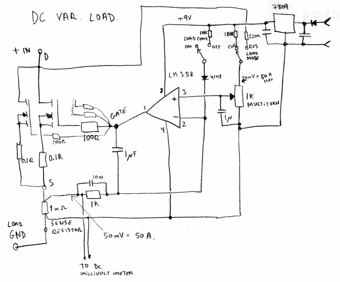

Hi Folks,
Just wanted to clear up a misunderstanding of mine (or what I expect is one). Isn't the 12V rail from the 24 pin, EPS and PCIE separated? IE if I put a power resistor on the ATX 12V pin that is not going to load, thus tell me if the EPS or PCIE rails are fine?
I was recently watching ArIs from Hardware Busters video on how to properly test ATX PSUs without using 5 figure Croma substations.
The PCB adapter he used breaks out the 12, 5 and 3.3V pins from the 24 pin and gives you banana plugs to connect to. That is a bit useless is it not? Aren't...
