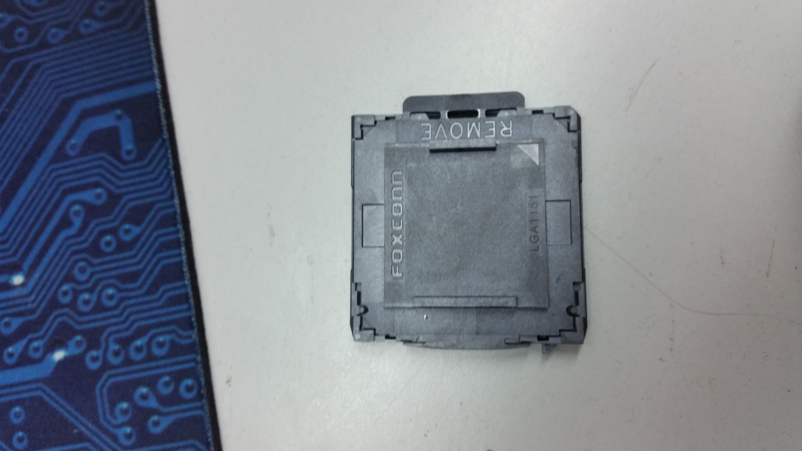

                OK so I got the alignment camera working again, though it is somewhat intermittent like before and may work for 20 mins then cut out
                As a first attempt of mounting a BGA I want to fit this LGA 1151 socket. I already successfully removed the old one with broken pins
                So I did ask this before - how to tell if the replacement part is leaded or unleaded solder as it did not say on the aliexpress listing.
                I took some pics, and because I didn't have anything to compare with I put a blob of leaded and unleaded solder onto an old bit of veroboard as a comparison (leaded 60/40 is the top blob). Looking at that, to my untrained eye, I have unleaded solder on the replacement LGA 1151?
                What would happen if I soldered an leaded part using an unleaded profile? The solder would still melt, though it would get hotter than necessary.
                Would there be any harm in doing that if I wasn't sure?

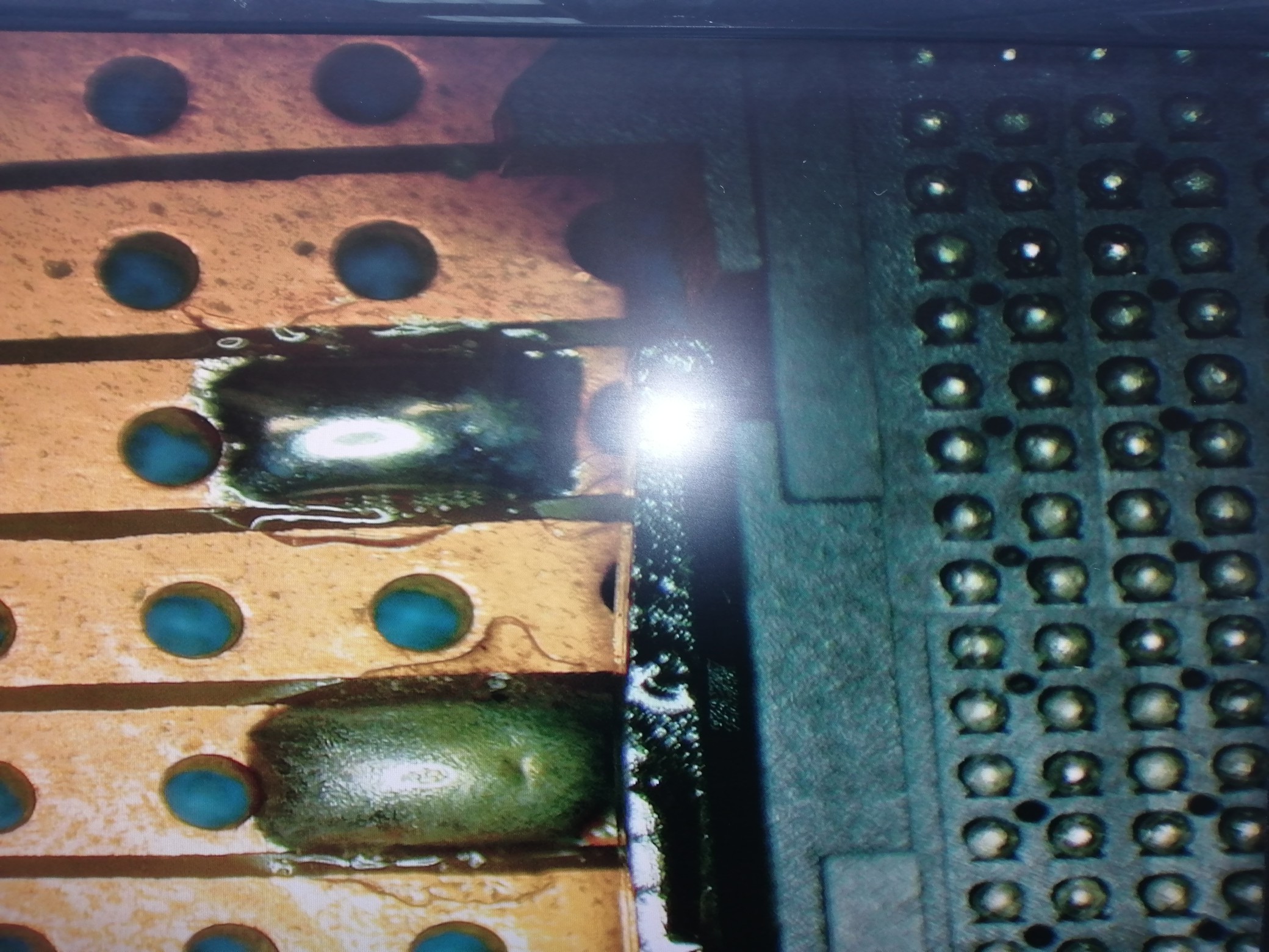

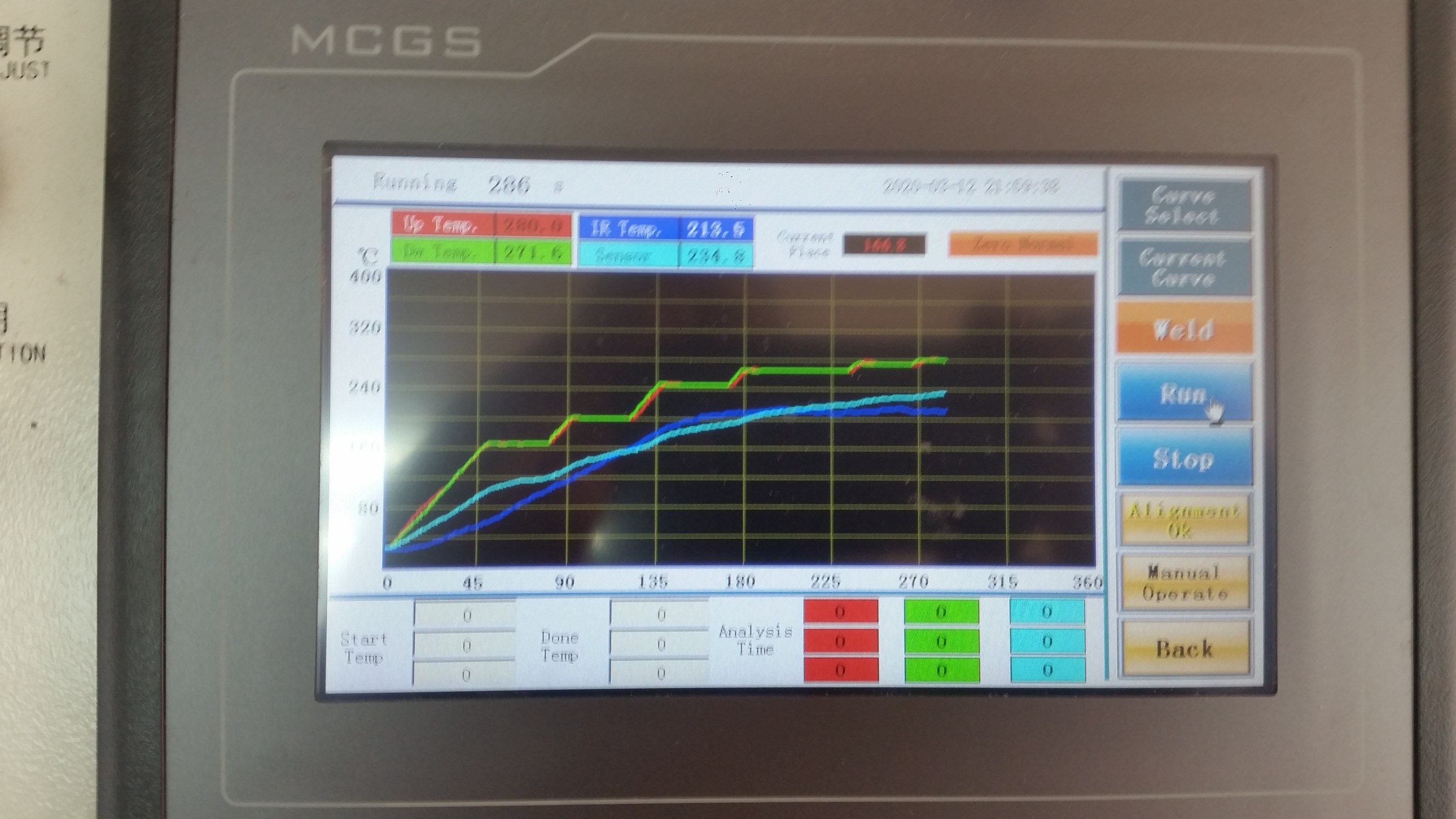

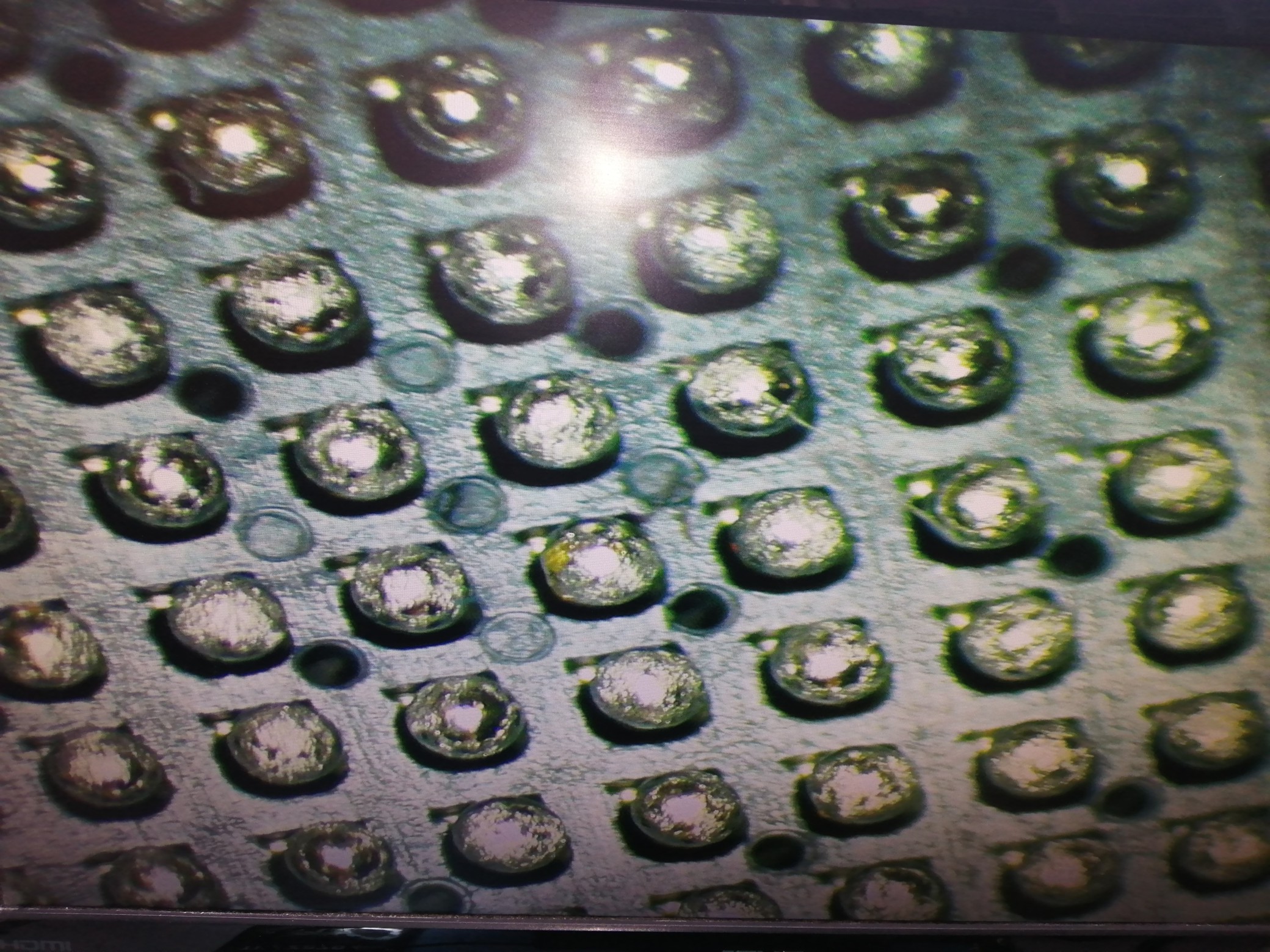

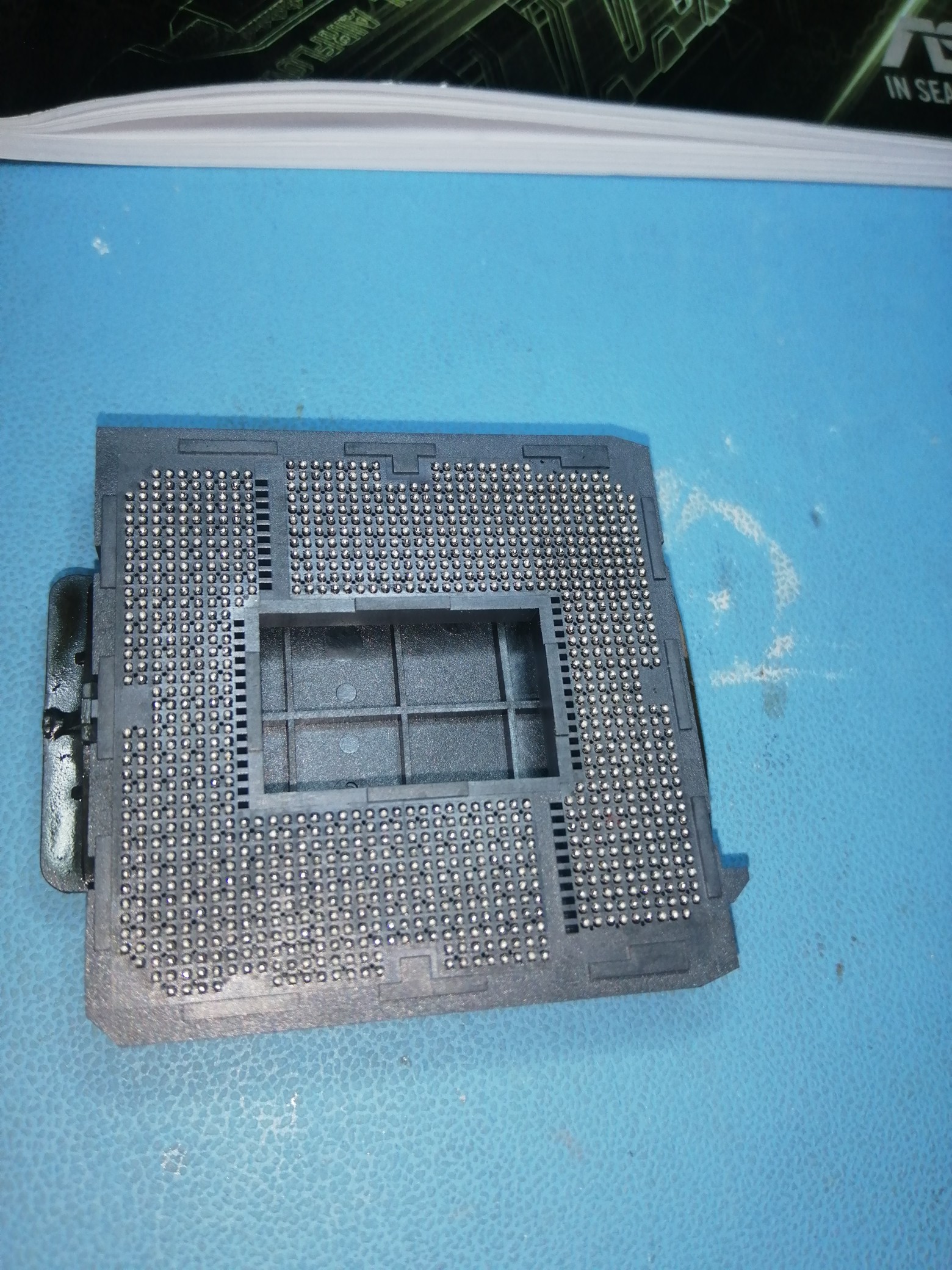

                  As no one seems to know, I decided the LGA 1151 was probably Lead free so I soldered it using the same profile that I used to remove the faulty socket from this motherboard.
                  it was a spectacular failure. It wasn't an actual disaster as I don't appear to have damaged the motherboard but I hoped for better results than this
                  So after soldering it looked like I may have teh LGA slightly skewed even though it looked good on the optical alignment. I checked this out by looking up the LGA1151 pinout and checking if I had Vcc and Vss connected to various pins in each corner - and I did not
                  I then noticed that the LGA wsa not firmly attached to the board. So I removed it using hte same profile which worked fine
                  On removal it was obvious that
                  A. My alignment was spot on
                  B. Most of the balls had not soldered. Some had towards the edges/corners and I had ones solder bridge.
                  Before soldering I gave the PCB a light coat of NC-559 flux with a paintbrush
                  I'm desoldering and soldering the LGA with the pin shield in place otherwise the vacuum can not pick it up
                  I attached a short video and some pics, sorry the one of the profile is not very good but you can read the temperatures. This was taken when I tried to solder the LGA. The video was taken after I removed the flux from the PCB
                  https://youtu.be/DG0rDZrVCfo
                  Where am I going wrong now?

                    You're measuring the temperature of the probe in an area exposed directly to the hot air.
                    I don't imagine the plastic is particularly good at transferring heat and with the pin shield on the hot air is blown around giving poor heat transfer.
                    Try again but without the pin shield. You might need to add longer dwell times between ramping up to allow the heat to get to the balls.
                      #70
                      Re: Advice for a new BGA rework station owner please
                      Hi diif
                      What I can't figure out is how to use the optical alignment) - which obviously worked perfectly according to the balls soldered in each corner - without the pin shield fitted.
                      Sure it is clear I didn't get enough heat in to melt the balls - but the same profile desoldered the old LGA from the same board with no problem. And I desoldered it with the pin shield fitted (took it from the new LGA socket).
                      That seems strange, to me.
                      I will try again with longer dwell times, like you say, rather than increasing the temperatures.
