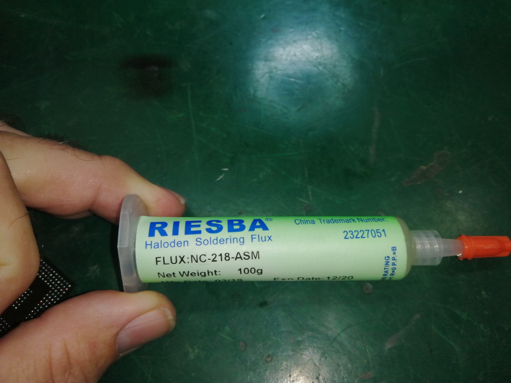

      I have a bottle of Topnik TK83 flux that I never used much. Is that any use for this sort of work?

        Tacky flux is advised to hold the balls in place.

          I will get the £30 Amtech flux you first advised.

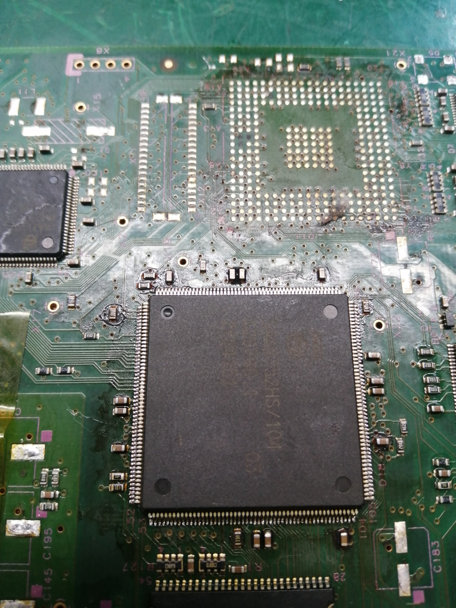

                    I've had the G720 for a few days now and I've been practicing a lot on scrap boards both with unsoldering BGA and QFP and also resoldering QFP
                    I haven't tried reballing BGAs yet but my reballing clamp/station and stencils arrived Monday so that's next.
                    I have to say that this machine is a dream to work with. The initial problem I had with profiles was my own stupid fault - there are switches at the side of the machine for the IR heaters (2 switches, for left and right heater) and I had them switched off!
                    It's now unsoldering BGA and QFP reliably, though i have one BGA that failed to desolder yesterday and I need to check if that is glued to the PCB. If it is then how do I deal with it?

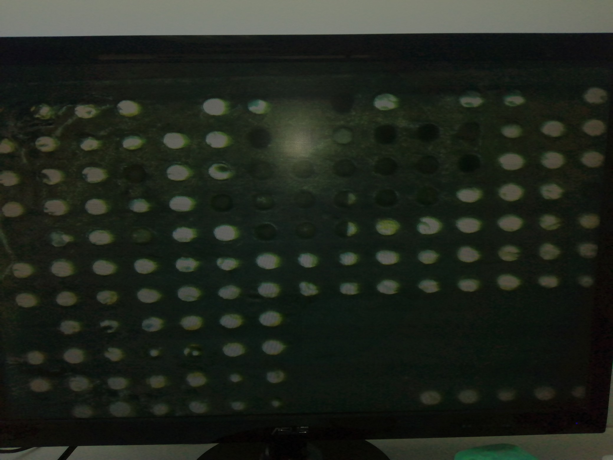

                    I've tried the optical alignment on a large QFP and it took me several attempts before I could get it to align properly. The first problem was that the QFP and the PCB pads were showing different sizes. After asking for some advice I was told to read the manual page 17 again!
                    It turned out that the joystick which zooms in and out also raises or lowers the QFP so you can get the size of the QFP in the camera to match properly with the PCB pads - but you have to select 'manual mode' on the touch screen before the joystick will actually control the up and down position of the top nozzle which is holding the chip by suction. The joystick controls the zoom anyway without selecting manual mode. This was not mentioned in the manual but I eventually figured it out by pressing buttons until it worked lol
                    Also getting the brightness of the QFP and PCB illumination set correct is important otherwise the image can be a bit blurry and chip can look like it is aligned correctly but it isn't. Once again a few trial and error attempts got that sorted.
                    The upshot of all this is that I ended up desoldering, aligning and resoldering the same QFP about 7 or 8 times until I got it right. However during all that rework the machine never lifted a pad and the PCB has not warped or burnt - see attached pic taken after 7 or 8 reworks
                    I think I have pretty much mastered this machine, and considering I only had 3 half days to really practice with it and I've never used a BGA station before, I think that is pretty good going and probably says more about the quality and design of G720 and the pre-programmed profiles than it does about my abilities!
                    So it seems the machine is not going to lift pads or warp PCBs but the problem I am having at the moment is lifting pads when cleaning the PCB once I removed the chip
                    On that QFP photo you may see that one pad is missing. That lifted when I tried to clean up the PCB the first time I removed the chip. All the other times I just resoldered with the existing solder, I didn't even add new flux though in reality I would do. I was trying to learn the alignment system rather than get good shiny solder joints
                    So.... Any advice on how not to lift pads when cleaning the PCB would be appreciated. I need to get that right.
                    I currently have my soldering station on 320C. Is that OK? I'm using Servisol braid dipped in Pasta de Lutovania Rosin. I'm cleaning afterwards with Isopropyl and a brush simialr to a toothbrush
                    Also how to deal with BGA that are glued to the board?

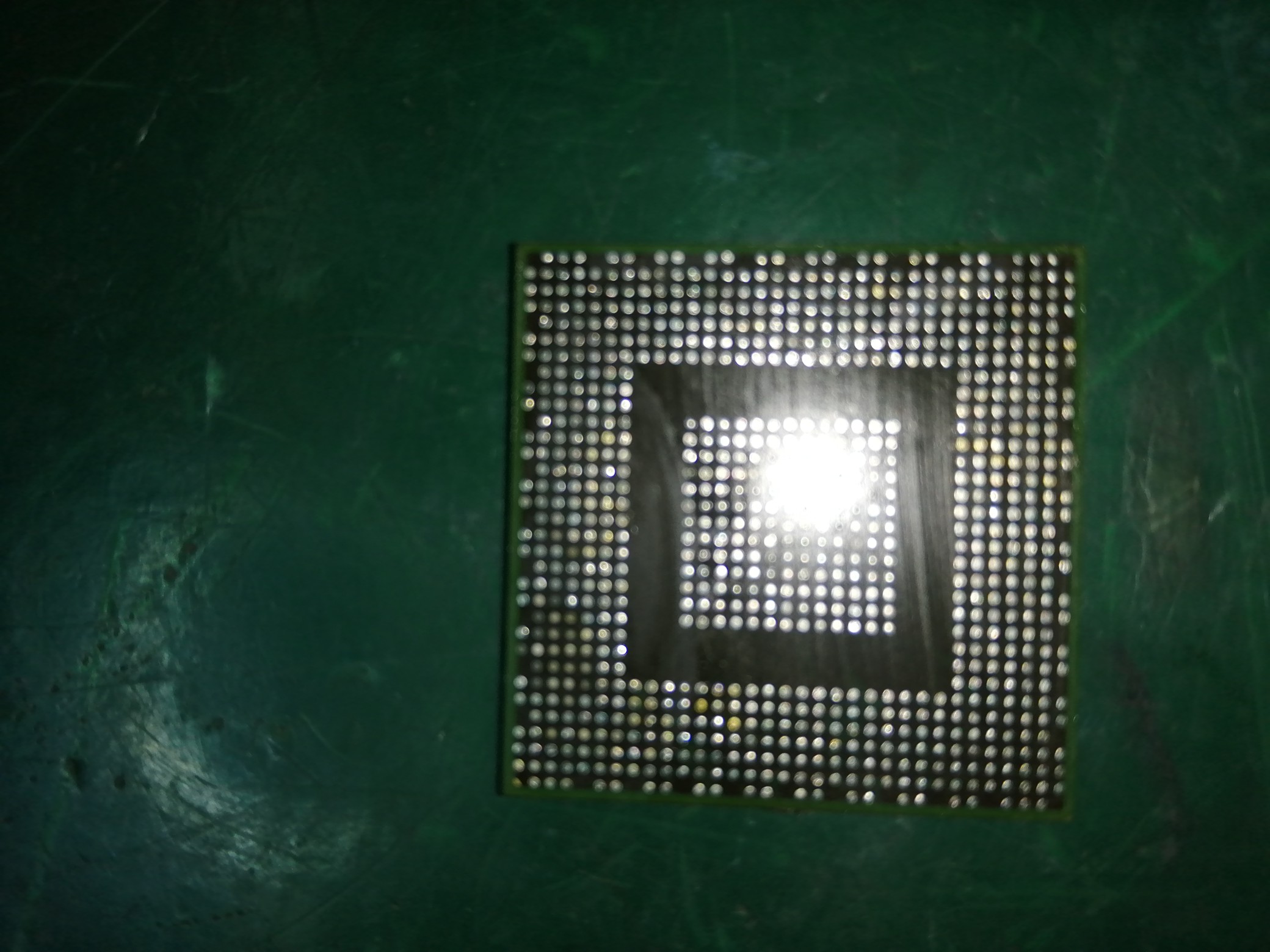

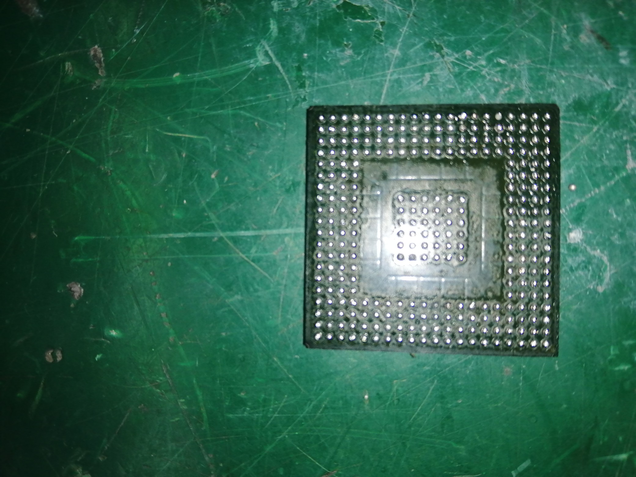

                        I had a go at reballing, I had to find a video to see how to use that magnetic reballing jig.
                        I used a standard 0.76mm stencil and used some kapton tape as suggested to create a custom stencil for my chip
                        All went rather well, and here's me thinking this is easier than I expeced. until I tried to melt the solder balls with my 858D on lowest air settings, and the tacky flux liquidised and lost it's tackyness so some of balls in one corner of the BGA moved around and clumped together.
                        Not to be deterred I removed the heat and I tried to manually place the balls back where they should go and this time used the Kada 853B with a metal plate (lid off an old satellite receiver) placed over the preheater and the BGA on top of that and heated it from below - then gave it a final heating from the 858D held above.
                        it worked OK...ish.... from a beginners point of view but I ended up with one pad lost and one donkey's bollock of a solder ball on the adjacent pin. I'm not too disheartened by this - it's gonna take a bit of practice, I'm sure, and maybe some different flux. I'm using the tube of NC-218 that came with the reballing kit. The Amtech NC-559 isn't here yet
                        Still I thought I would mention all that and give you all a laugh - see pics

                          You're mixing indirect heating stencils with direct heat, I'm surprised there aren't more big solder balls.

                            Probably......... as I am not sure what the difference is, but I'm determined to learn. It was my first attempt
                            Watched another video today that suggests what I did would have worked but for the fact I had too much flux on the BGA
                            Time to try again tomorrow
                            Also gotta find another BGA that the G720 will not remove - then i can mess around with profiles. I've got plenty of scrap PCBs to play with so hopefully I will find another good candidate

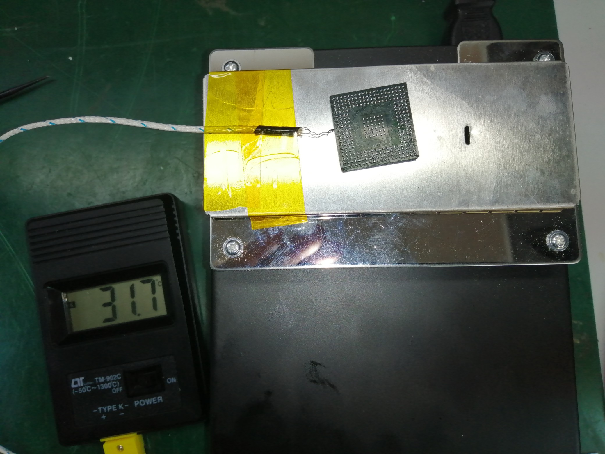

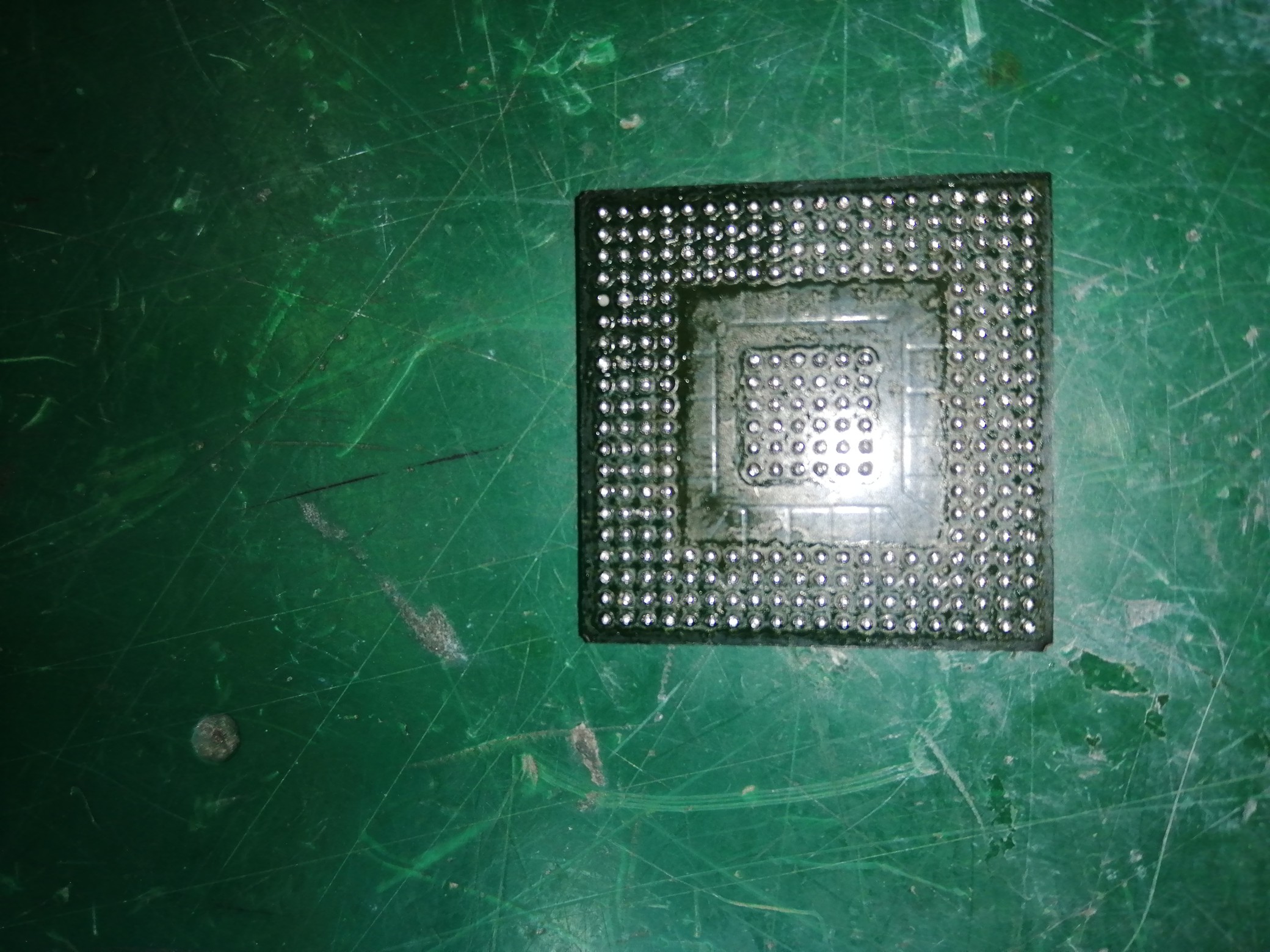

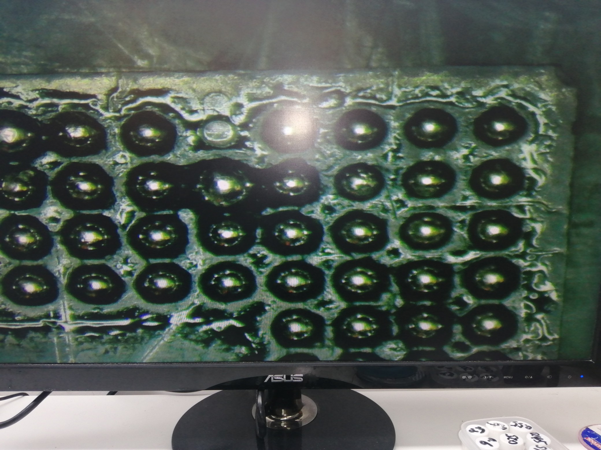

                              Reball attempt No 2. The main difference is I used a much thinner layer of flux.
                              No donkeys bollocks this time but I somehow got two balls with a solder bridge, even though they are correctly positioned on the pads,. See pics. Is that game over start again or can it be corrected?
                              Most of the balls are the same size this time though some look slightly larger than others
                              Also some of the balls are shiny but some seem to have collapsed in on themselves somehow and had a dimpled appearance
                              Is this normal, is this bad technique on my part or bad quality equipment (flux, balls)?
                              I read or saw a video somewhere that says if you rub the reballed BGA against a bit of paper it will level out all the balls so the BGA sits properly when it is resoldered to the PCB. is that good advice? I tried it on the BGA and I can see that some of the slightly larger balls have a flattened bottom now where the paper has rubbed them

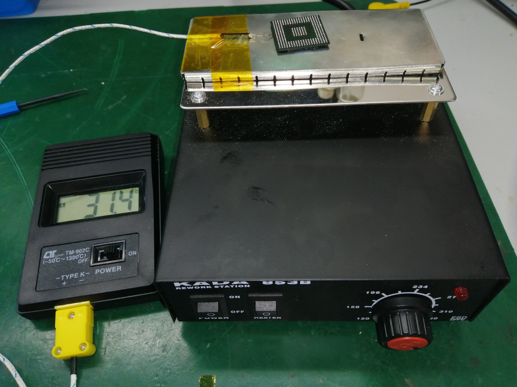

                              I found that using the Kada 853B with a small metal plate and a thermocouple attached to it is a pretty good way to melt the balls without them blowing around, then once they melt I give them a quick going over with my hot air station to be sure before turning the Kada 853B to cooling mode.. Is that good technique?

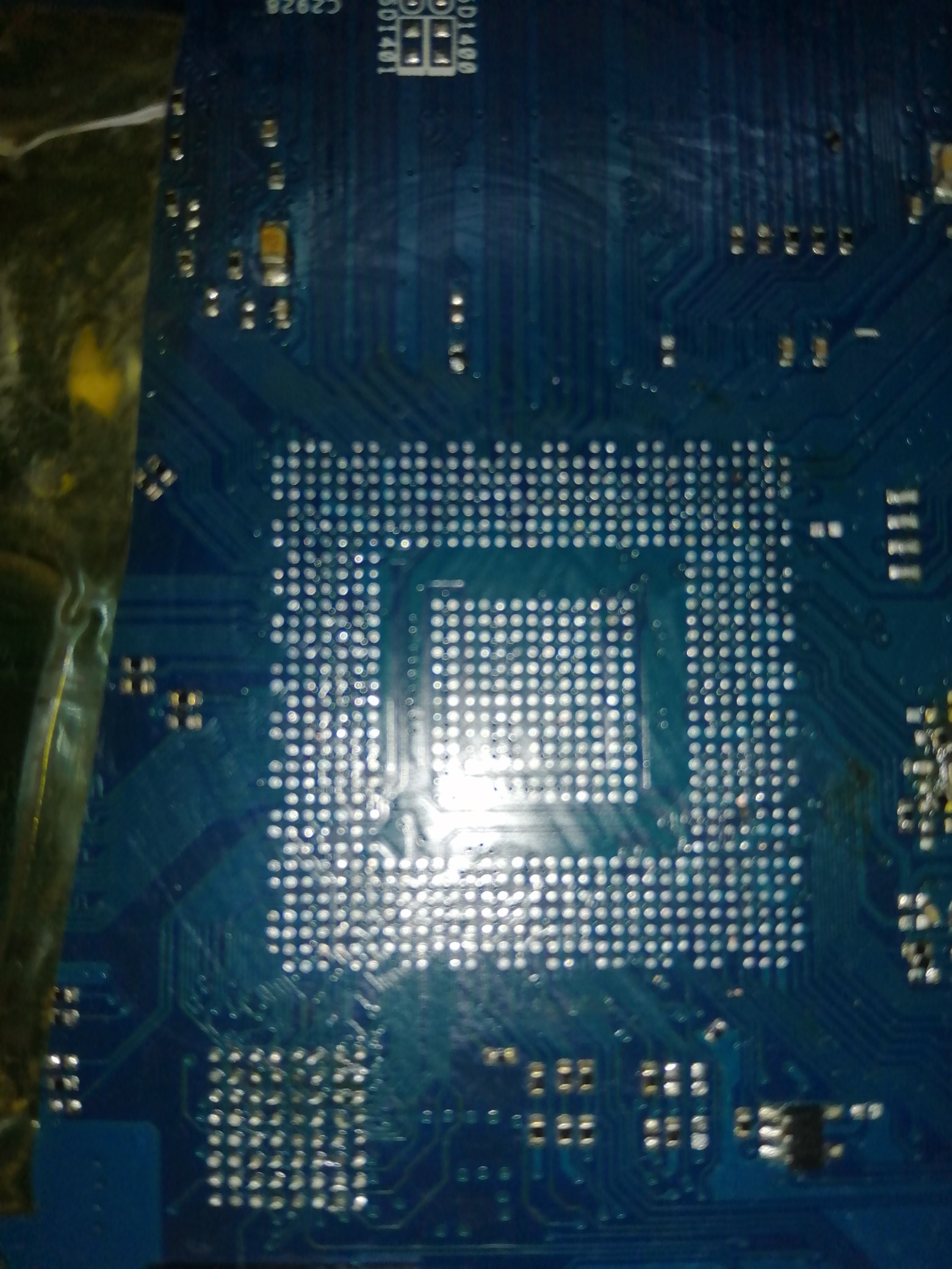

                                Hey diif, I got the Chemtronics braid a few weeks ago but I was busy so didn't have time to try it

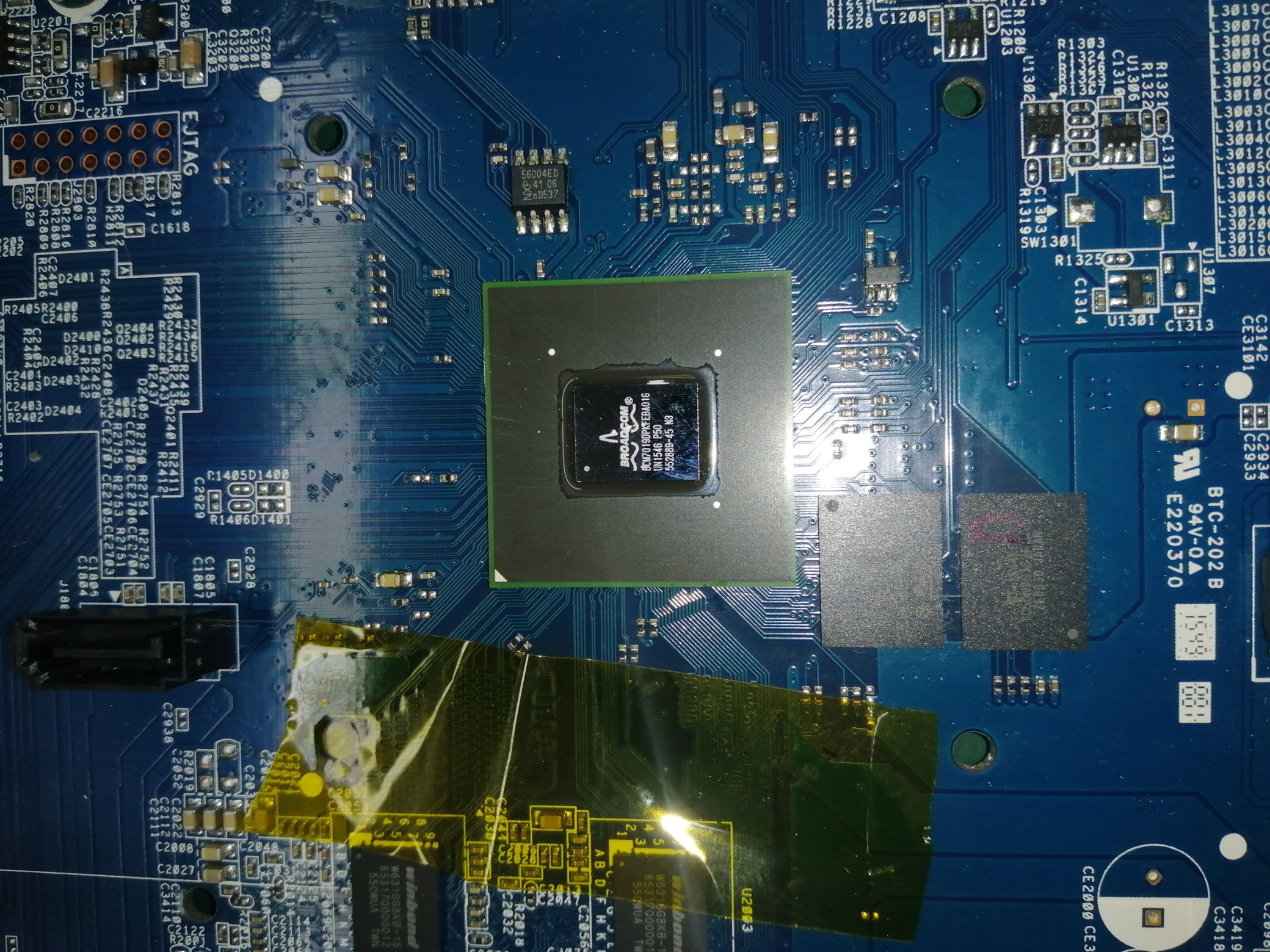

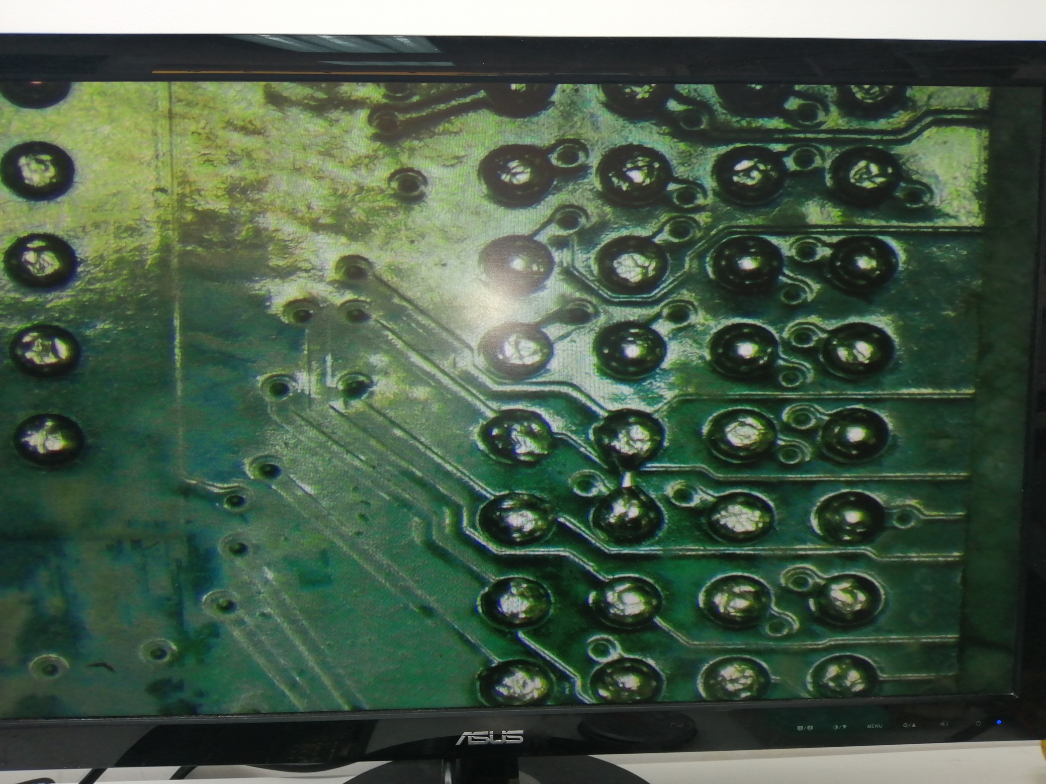

                                I had a play around with that today - I removed a BD82H61 BGA from a scrap LGA 1155 motherboard and then used the Chemtronics braid with Mechanix UV50 flux to clean everything up
                                https://www.aliexpress.com/item/3300...1e444c4dA70TjY
                                I have to say the Chemtronics braid was a really good recommendation from you. I had no problem cleaning up both BGA and PCB without any damage.
                                I'll definitely order some more of that braid now, I just got 2x 1.5m to test with but I suspect I will be using quite a bit of it.
