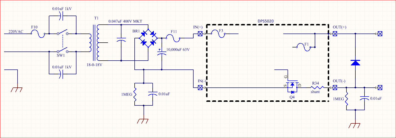

    Thank you redwire for the schematic. We'll stick with this I think.
    I need to scrounge up some Y caps (in parallel with the 1 meg resistors), though I believe they're misrepresented in the schematic as polarized ones.
    Also, what diode should go on the output there ? I have a P600K on my current supply just tied between the output terminals as an after-thought, simply because that's the only type I had which had long enough leads to go from one binding post to the other
    Wattevah...

      Re: DPS5020 dual power supply build
      diode should be schottky or very fast, with a nice safety area.
      if it's schottky - the highest voltage you can find.
              *ONLY* the hot side ground should be connected to earth ground (using either Y cap or RC)!
              The analog ground (i.e. to the power transformer right) should not!
              If you do connect them say goodbye to the 2 DPS working in series.
              Even worst:
              a human heavy electric static discharge on the analog terminal, i.e.: power supply analog ground output,
              will make the main power electric differential to actuate and cut the power
                So you're saying I should not use the 1 meg resistors +caps ?
                As for grounding the 230v input, the filter I showed in post #27 does that internally I believe.
                      It's good to have a reverse-diode across each output. P600 is good.
                      If you put the power supplies in series for more voltage, but something goes wrong (overload) the weaker PSU gets forced reverse voltage on its output.
                      The other reason is if you connect a battery backwards (smoke!) or connect an inductive load like motor, car coil etc there would be -ve voltage spikes.
                      Not having a 1MEG and Y-cap I disagree with megaraider, although I'm not clear what "hot side ground" and "analog ground" are.
                      For sure you don't want stray leakage currents lifting up the DPS voltages floating, so you need a path to earth ground. Prove it by measuring the AC leakage voltage and current (to PE, or between channels) without any 1MEG 10nF kind of thing. Or look at it with a scope.

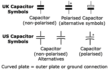

                      I've always drawn non-polarized capacitors with a curved plate.
                      Old film caps have polarity as an "outside foil wrap", which you want connected to GND for shielding or to the output of a stage. This is a very old reason for the curved (-) plate (stripe mark) on a non-polarized film cap.
                        I believe he's referring to the primary of the transformer (hot) and the secondary of the transformer ("analog") respectively, though I would like a confirmation indeed.
                        Sure sounds industry-standard to have a y-cap between your regulated ("cold") output and chassis (earth) GND....true, SMPSs are not designed with series-connection in mind, so I'm not sure how well the concept would transfer to our build here.

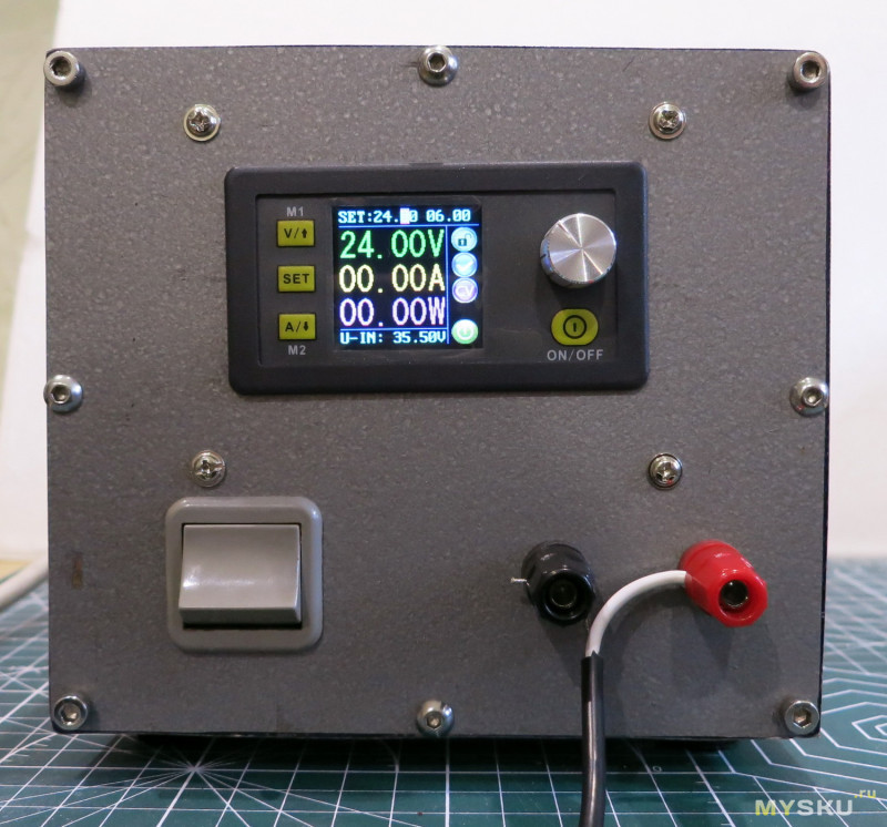

                          Does this bother anyone? Imagine looking at it every day.... every day...
                          • Dannyx
                            CertifiedAxhole
                            • Aug 2016
                            • 3912
                            • Romania
                            #53
                            Other than the DPS being ever so slightly crooked, it's decent
                            Wattevah...
                              Yes.
                              Being a consumer and industry standard it's also applied in electronic lab equipment (mainly due to EMI test compliant), but with a big twist:
                              With the electronic lab equipment design engineer wariness of demand for flexibility in lab environment the connection from PE to ground is done only to bypass the compliant tests.
                              Therefore if any qualified experienced user needs to break it it's easily spotted and undoable, i.e. PE to analog connection only (PE to chassis and to cold ground remains connected).
                              See schematic for the KSGER 96W 24V 5A Electric Power Supply Unit in this post
                              Note the remark: “Skinny trace for PE GND”
                              Why skinny? Good example for the above mentioned isn't it?
                                Btw, imo your're overdoing the filter stage leading me to believe you might have forgot the overall picture.
                                Voltage ripple before the DPS5020 stage is not a concern, but the inrush current value is!
                                Why isn't ripple a concern at that stage? Because that job is up to the next stage: the DPS5020 module.
                                The only thing you must ensure is that the input voltage never falls below the minimum threshold at maximum output power set (highest voltage and current values).
                                Within the expected ripple frequencies 100Hz (120Hz USA) it can be feed even with a saw tooth wave for that matter, because the DPS5020 module has a feedback sample frequency in the tens of KHz at least.
                                    maybe update your schematic and see if everyone likes.
                                    The small capacitors I'm suggesting are not for EMI or compliance, but are to swamp the power transformer's winding capacitance.
                                    You can measure it, pri-sec, sec-core (with windings shorted) and see how much it is.
