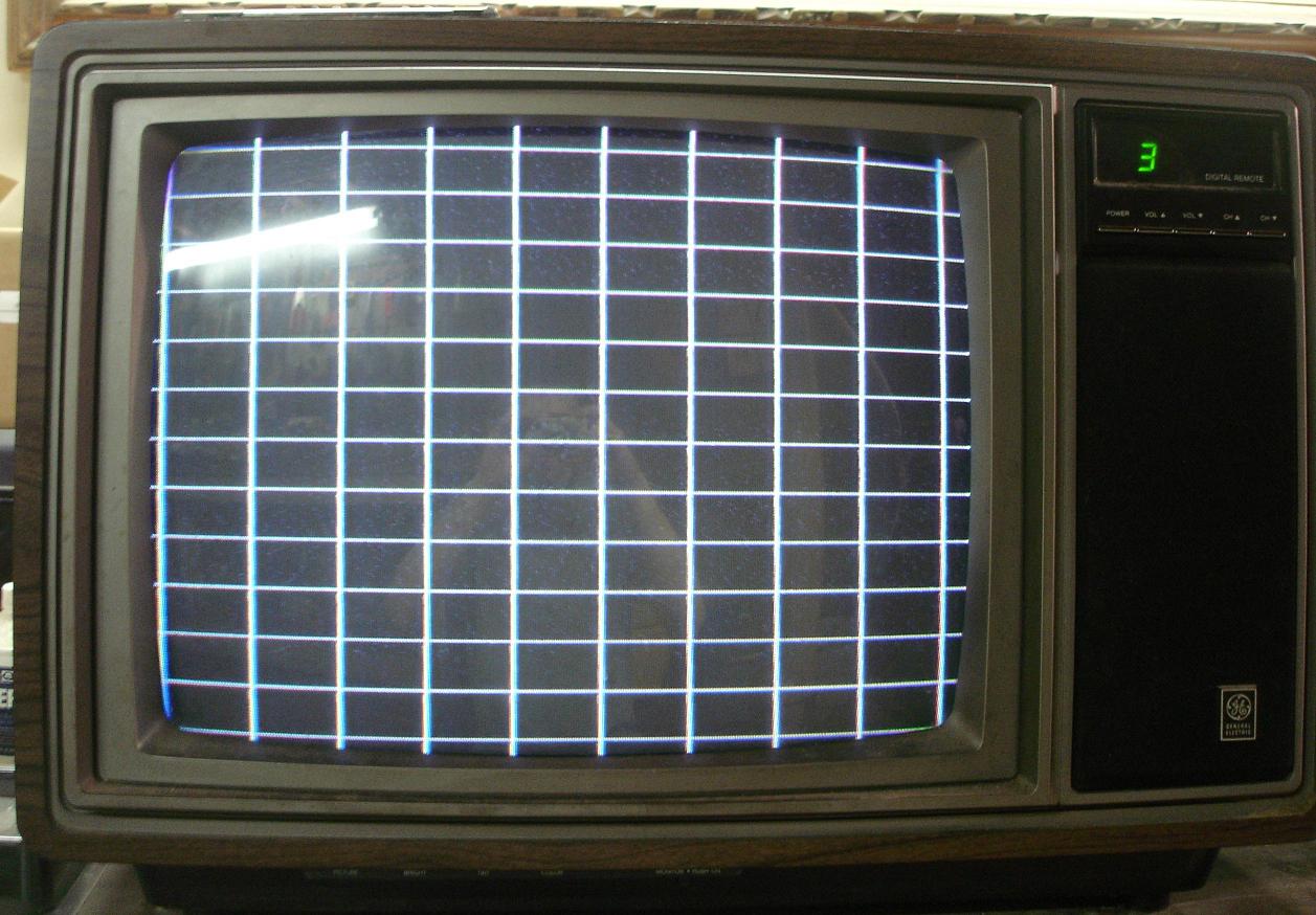

    I recently came into posession of a B&K 1245 Color Generator.
    So I hook the RF output to a 300 to 75 ohm matching transformer. Yes it's that old what is twinlead again ?

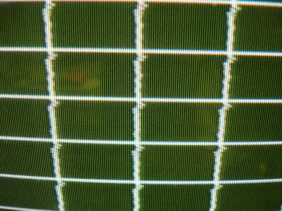

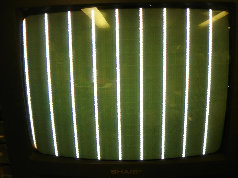

    Everything looked good the color bars and the dot pattern but the vertical lines have a jittering problem.
    You can really see it in the crosshatch pattern.
    So I check the alignment of the countdown circuits with my scope everythings spot on.
    So on a whim I try it on an older GE TV made around 1981 or so and the vertical lines are now solid.
    Is there some variable in more modern TVs that is causing the vertical line jitter?

    This is EXACTLY what macrovision works off this.
    Copyholders asked the TV makers to desensitive the lock in speed on TVs while leaving the sensitivity in VCRs high so it keep chasing the timings causing pic to go wavy/fading in and out on playback.
    Cheers, Wizard

        Re: TV Color Generator Problem
        >How do modern generators overcome this?
        by being more precise?
        btw. no, not v-sync, but h-sync...
        you have lines being shifted to left and right at certain places, which means h-sync is off...
        ie it's left-right distortion, not top-bottom...
        top-bottom(vertical sync) distortion would make some horizontal lines thicker, and squares would become rectangle etc.
