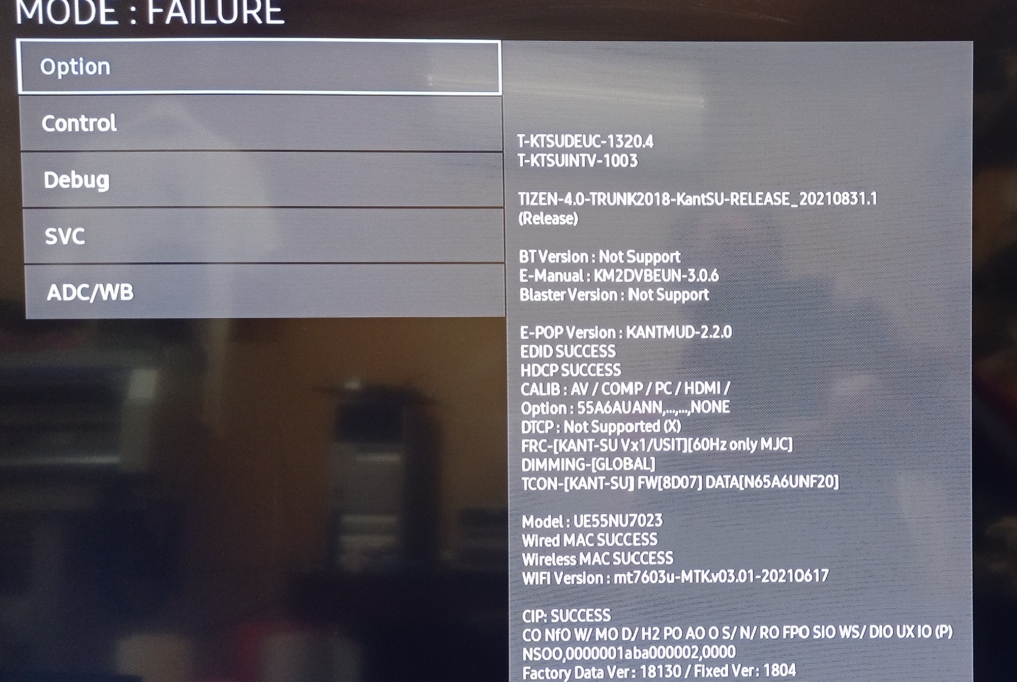

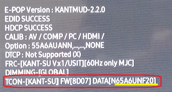

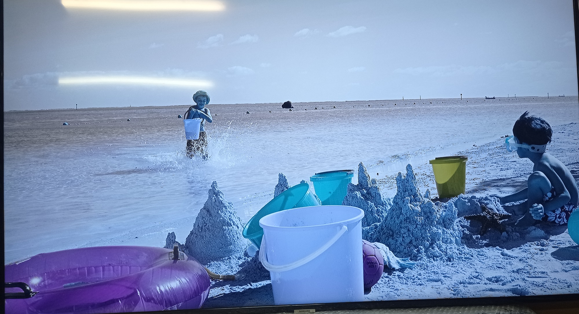

    Hi, i change mainboard for my TV samsung UE55NU7023 with another UE65NU7025 and have color problem. Everything else works great only color problem. Only change eprom 24512D. How can I change the T-con parameters from 65 "to 55". Im asking for help.

      Re: Change mainboard samsung UE55NU7023 with another UE65NU7025 and have color proble
      All t-con settings and matrix type are in spi flash IC501 W25Q80V.

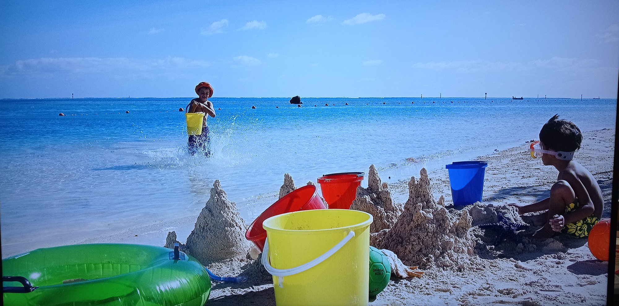

        Super now work fine. Thank you.

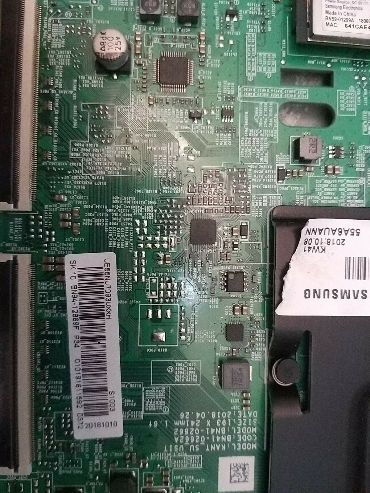

            SAMSUNG MAIN BOARD BN41-02662A,the board are identical to each other. The only difference is in the model and the screen.
            Difference sticker on the board.
