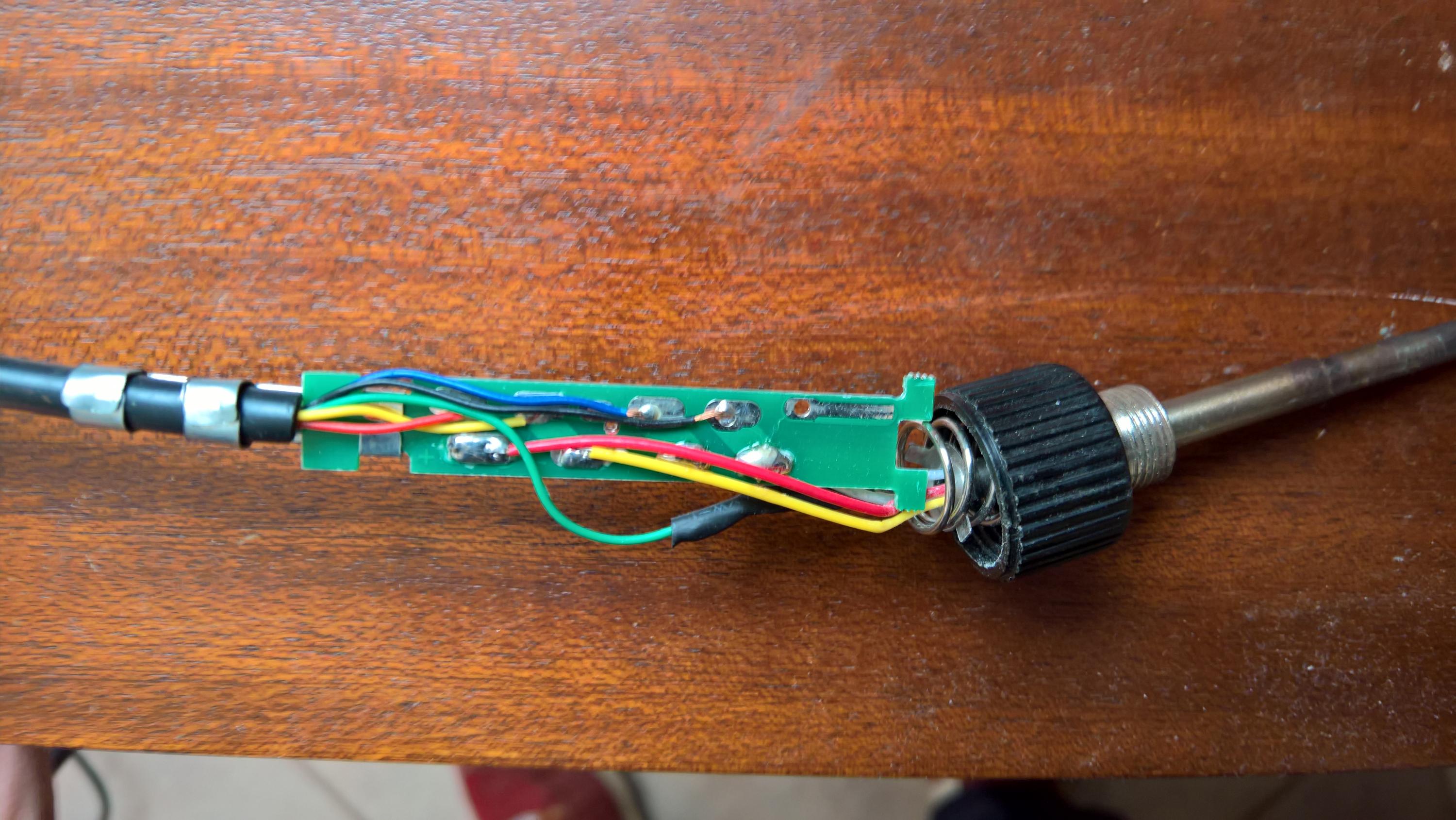

    I have an Atten 8586 soldering station at work. Unfortunately I dropped it today and the only part I managed to hold on to was the soldering wand. All the wires ripped out at the connector to the station. I was hoping someone could take a pic or tell me what wires go to which pins. I would really like to repair this unit since the company owner is kind of a penny pincher. Prefer not to buy shop tools out of my pocket. Thanks in advance

    foto's of the connector please.
    i have a lot of pinouts for those, but there are a few different connectors in use!

        The pins that had wires connected on this connector were 1,2,5,6,7

          Re: Atten 8586 Repair Help needed
          I found this video which might help identify the wires in the solder iron, I see hakko 907 and the atten 8586 seem to use the same replacement iron.
          https://www.youtube.com/watch?v=aVkXNvVu7EQ
          and I found this with a pinout for a atten 8502, maybe they are similar
          https://www.jackenhack.com/atten-850...-iron-element/
            ill disassembly mine and take picture.... wait a bit...
            edit1: ops i disassembled the solder station not iron... wait
            edit2: they are numbered:
            1 yellow
            2 red
            3 nothing
            4 nothing
            5 blu
            6 black
            7 green
            and here is a picture of the iron wires, as u have different color:
            green is gnd
              Thanks for all the help folks. I got it up and running again.
