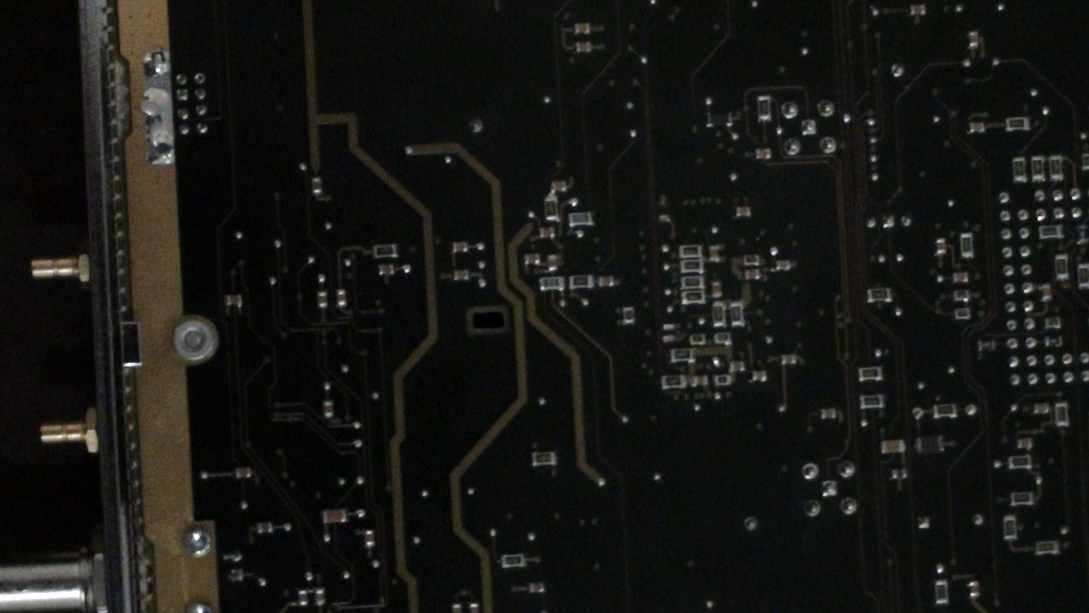

                        #51
                        Re: Considering purchasing a Logic Analyzer
                        Okay Stj. I just don't think the schematics were ever released to the public. I contacted a person who was working on these modules. He said he believed HP has these things called CLIPs (Component Level Information Packages) but he's never found one on the net or anything. I've got the service manuals for both the oscilloscope module and the logic analyzer but they just seem to tell you how to calibrate the equipment and gives part numbers for replacement parts. You know, real simple stuff for field workers or something. If the board fails the test, try this. If that doesn't work, replace the board with this part number. If the oscilloscope probe is bad, replace it with this part number, etc.
                        Anyway, here's the pictures I promised. Sorry that they're so dark. I had all the lights on in the house but it didn't do much good. DSC01507 shows a zoomed up picture where the two missing caps are. One has a missing pad but I think I can solder to the little bit of pad that's missing or solder to the via that it goes too. The circuitry in DSC01507 is on the back side of the board, same place where the AMCC chip is. Just on the back instead of the front. The AMCC chip had a heatsink that I removed. I hope these help.

                                  #56
                                  license servers will be for FLEXLM, seen SGI using that crap.
                                  btw, what's this part in red, a battery-backed ram?

                                    • Spork Schivago
                                      • Mar 2012
                                      • 4734
                                      • United States of America
                                      #58
                                      Wow, you are good! My crappy photo and you could tell! It probably needs replacing. It's:
                                      H990A9922
                                      M48Z18-100PCI
                                      ZEROPOWER RAM
                                      Lithium Battery
                                      Malaysia. Written sideways, there's also a W1749X on there. I planned on replacing it once I got the triggering fixed (or at least the IC and the two 10nF SMD caps).
                                      -- Law of Expanding Memory: Applications Will Also Expand Until RAM Is Full

                                          #60
                                          With capacitors, I can always go over, with the voltage, right? I have evidence to believe it's a 10nF. I can't prove it but someone who has them found two others that appear to be identical on the same circuit. I pulled those two others and measured them on my board and they were both 10nF. I figured if there's four caps in the same circuit that appear to be the same height / width / length, if I have no other ways to tell, it'd be okay with assuming at this point that they are the same caps.
                                          The package seems to be a 0805. I found some 0805 10nF 100V MLCC SMD caps at Mouser. If the real caps are only like 16v, would 100V do any damage? Or could I safely use them? I thought the voltage was just the maximum amount of voltage the cap could handle...
