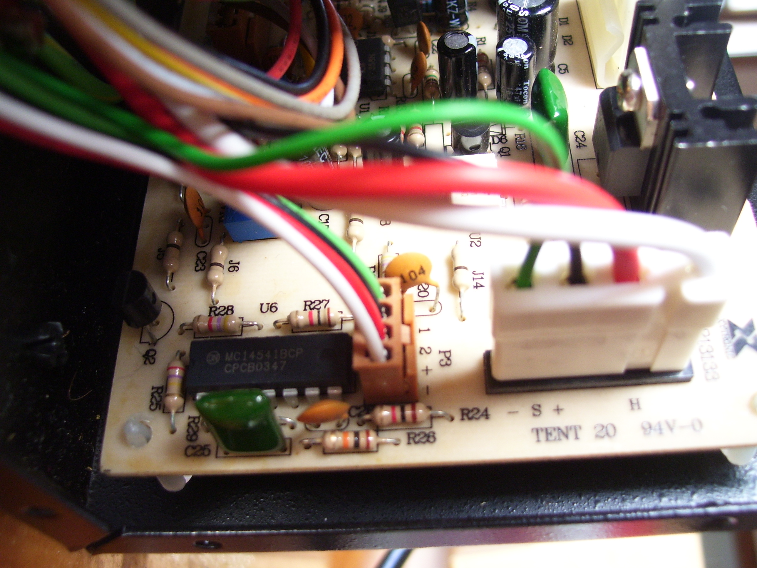

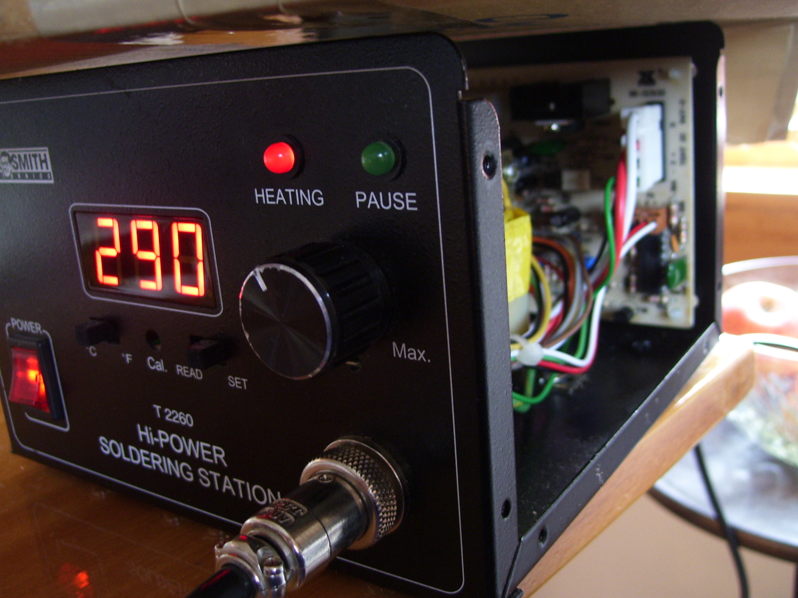

    Hi Peeps,
    Have recently acquired a soldering station.
    Seems to operate OK, except that the green pause LED does not appear to function.
    Am assuming that the pause LED indicates when the station is not heating the iron?
    Have let it sit for 5 mins, and the iron reaches the set temp, but the green LED doesn't even blink.
    Tested it with a 3v lithium and it turns on (better with 2 lithiums in series, to give 6V)
    The wires (red and white) from the green LED, plug into the circuit board, along with two other wires that come from the top two pins of the iron socket (black and green)
    Have taken a photo of the circuit board where this connector plugs into. (it's the smaller brown connector)
    Is this looking like a fault in the iron, or a problem with the circuitry?

    Re: Soldering station Pause LED
    it may work with a special stand.
      Hi again,
      Hope all is going swimingly
      Didn't think of that
      What difference would a stand make?
      Multimeter shows continuity from the metal of the iron to earth.
      And after your suggestion, tried pointing the iron downwards at all angles when the iron had reached the set temperature - but still no green LED light
        • 31267
        some irons from Hakko and JBC for example have optional special stands.
        the stand plugs into the controller, the iron plugs into the stand.
        some stands have a microwsitch on them, some just detect the shaft of the iron against the stand - because it's earthed.
        you should trace the pause wires into the iron handle and see if they actually connect to anything - they may not even be used on the iron plug - only the controller.
          Thanks bud, will bear that in mind if the following doesn't yield results
          Might have just found it after trying a different combo of wider search terms:
          From www.xytronic.com
          ENERGY SAVER: Automatically powers down after 15 minutes of idling indicated by the Pause LED-saving power while extending tip life.
          So will try it again for longer than 15 minutes
            http://sg.rs-online.com/web/p/solder...ories/0255067/
            notice the line
            Features selectable sleep function to prolong tip life and an energy saving automatic shut off function
