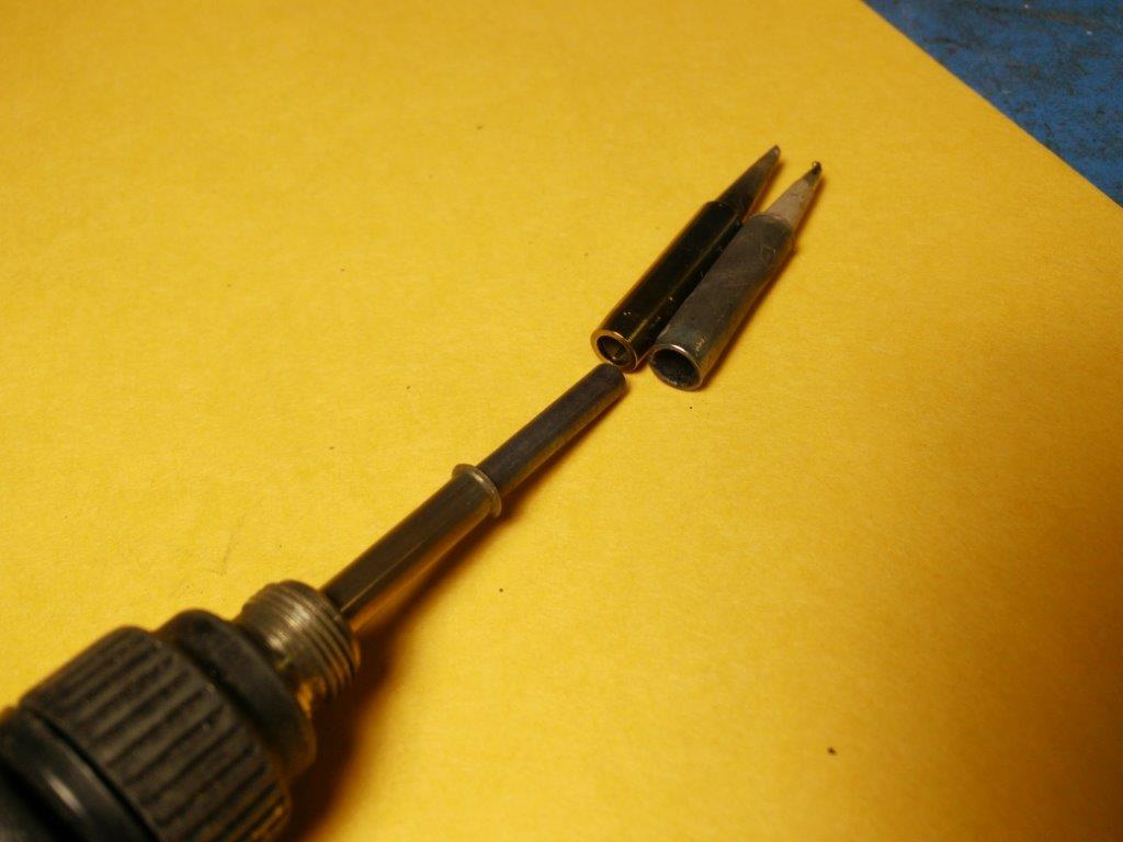

    I took apart a Hakko 907 wand on a 936 soldering station.
    Tip 900M-T-1 (on the left) is too small to fit on the heating element.
    Tip HAKKO-B (on the right) is too big and loose to fit over the heating element.
    I dunno what is messed up

    It looks like that the sleeve has slid out of the tip and has stayed on the heater.
      • 31043
      Re: Hakko 936 soldering iron - tips don't fit
      probably.
      the heater should be white ceramic, not metal-looking.

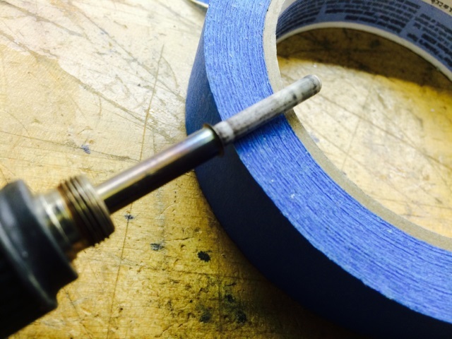

        Sorry the ceramic was white one day, but I think the above comments are exactly correct. If you look into the opening of a tip, you can see the inner sleeve or the lack of.

          I looked harder and it's an insert pipe stuck to the heating element. Gentle tug and it's off. The heater now fits into a normal 900M tip (4mm ID). Insert was 4.3mm OD.
          I don't know what Hakko tip has inserts, must be pretty old. I took the iron out of the garbage from Manufacturing dept.
          I could buy a new 907 wand (chinese) clone for $8 on eBay, but they are a lot of hassle. The heating elements are the wrong resistance, temp sensor different and can wreck your 936 station.
