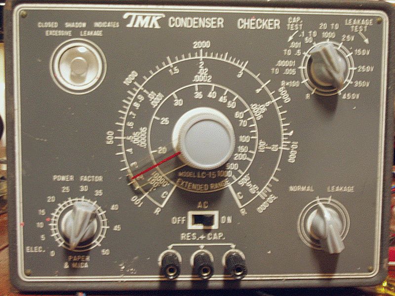

    Hi was wondering if anyone knew what voltage these are meant to run on?I replaced the 2 8mfd electros as they were leaky,fired up with variac when I turn up to about 150 volts Im getting nearly 300volts+ on the magic eye tube.I placed a 100k resistor across the 8mfd cap as per heathkit C3 circuit diagram ,that bought volts down to 200volts [bit better] but I think it would damage the tube if I wound variac upto 240volts[250 volts max to magic eye].Any help greatly apreciated or mods for this unit.

      replace all paper caps.
      btw never heard of that brand.
      post a pic of your antique.

          Thanks for that really appreciate any help.I think I bought my esr meter off you Bob,or the chip for it[you placed a $2.00 coin with my receipt saying I had overpaid you]Any way Ive taken a few photos of my dinosaur but not sure how to attach them to this,,I think i have.Another member has just got one of these checkers its on another thread 'testing oil caps' and I think his name was japolytic,but Idont know if Im allowed to contact him .Ive gotta read the instructions for this forum...THANKS AGAIN bob and kc8adu for your help will check the other caps out and get back to you. paul
            Re: Tmk caps checker LC-15
            G'day Paul,
            I remember sticking the coin to the receipt a long time ago. You might have been one of the victims of the Rod Irving Electronics ESR meter kits which didn't contain a microcontroller - only a piece of paper telling the buyer to get it from me. Of course they never told me about this bit of trickery and made it look like it was my idea. Grrrr.
            Anyway, I still can't find any mention of that condenser checker in Google. Unfortunately your photos don't appear to have attached.
            If you can e-mail them to me at <fox_duipbv@trashmail.net>, I'll put them here for everyone to look at.

              This is Paul's photo of his TMK Condenser Checker. Now that I've seen it, I remember seeing one before, somewhere. Surprising that it's hard to find any mention of them in Google.

                I think this is an oldschool equipment, which haven`t made it to the modern electronic repair tech`s desk and subsequently not into the .com world.
                The problem with tis very useful device is, that you need some knowledge to get the right presets and to interpret the values.
                Furthermore, i think such component level testing isn`t widely done anymore.

                    Reforming is required or at least recommended for any electrolytic cap, which was on the shelf or in equipment which was not used over a long period of time.
                    But sure, caps have been improved in this respect, that the initial leakage current does remain in safe regions and the caps may not blow that easily.
                    On the other hand, a cheap low voltage cap is not worth to much effort, compared with a more expensive high voltage cap in older equipment.

                      Thanks for your input Gonzo good to hear other ideas,my problem has been fixed,replaced the rest of the caps and shes a goer. Im wrapped thankyou to all who helped ..cheers Paul

                        this web site has a schematic of a heathkit C3 condenser checker.
                        you will need to clik on the second link
                        http://www.jvgavila.com/schem.htm
                        here is an Ebay auction of the Heathkit C3 (nice big photos of it)
                        here but ending 8 oct 2007
                        looks very similar in what it has to offer

                        Since the ebay link will die found this on the net here
