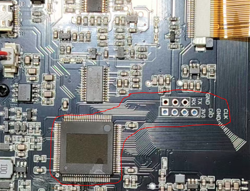

    here is another one with same problem found on Youtube:
    I have replaced the Winbond flash chip (I found a model with the same specifications), although it is not exactly the same.
    I flashed it, the device powers on, and after that I flashed both BIN files again — the process completed successfully, but unfortunately the problem remains the same.
    Is there anything else I can do? I would really like to repair this device.
    For now I know that Flash chip is not problem.

      The main firmware is located in the AT32F403AVGT7 controller.
        ok tnx, so this is unrepairable or ? this chip and its content is not public?
        any advice ?
        • lotas
          • Jan 2016
          • 4809
          • Russia
          It will be 100% locked from reading and you will not get its contents (dump) from it.
