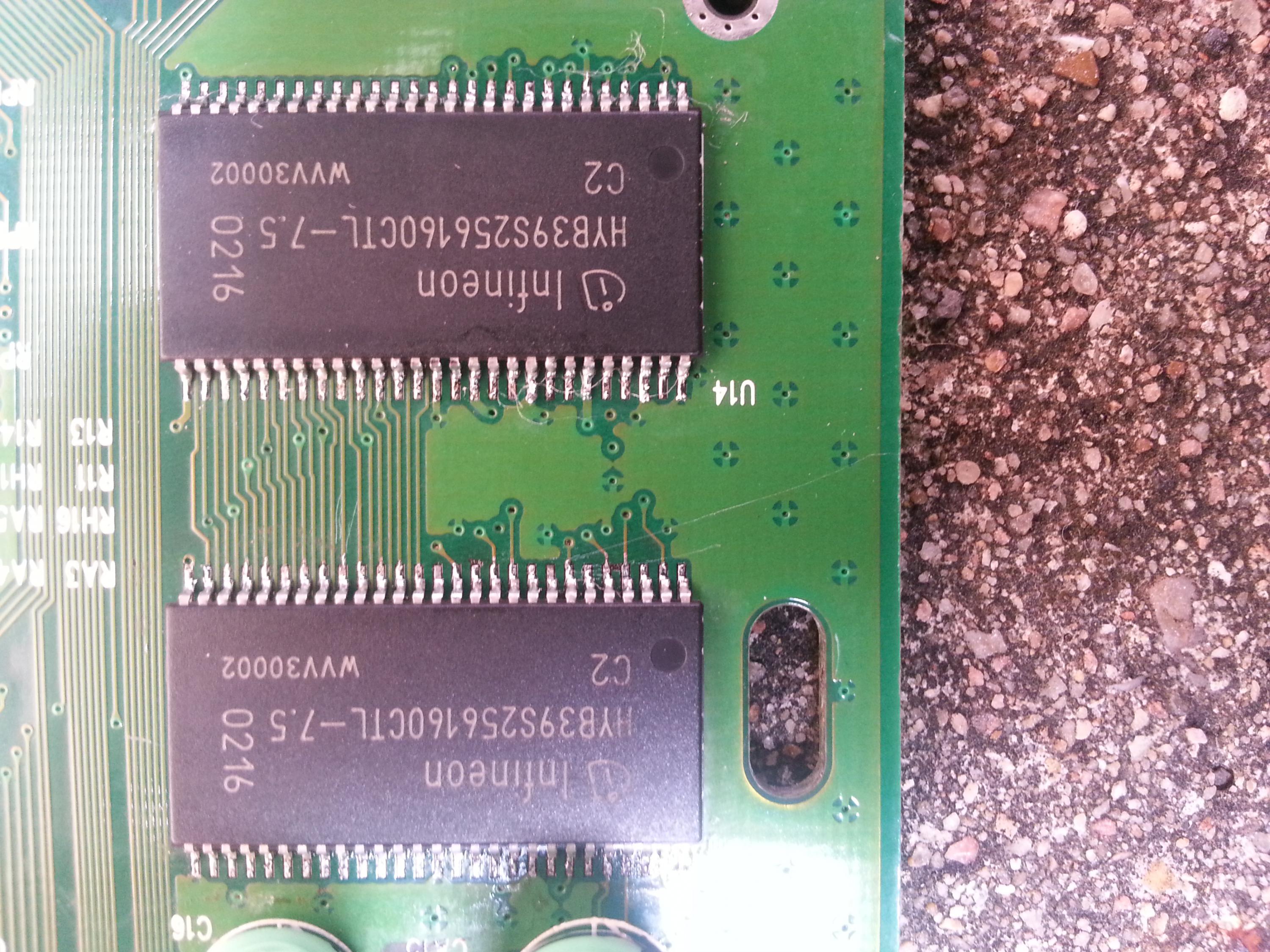

    Anyway, here are some pics of my bad soldering. Feel free to critique.
    First attempt. First chip was better, I used less paste.

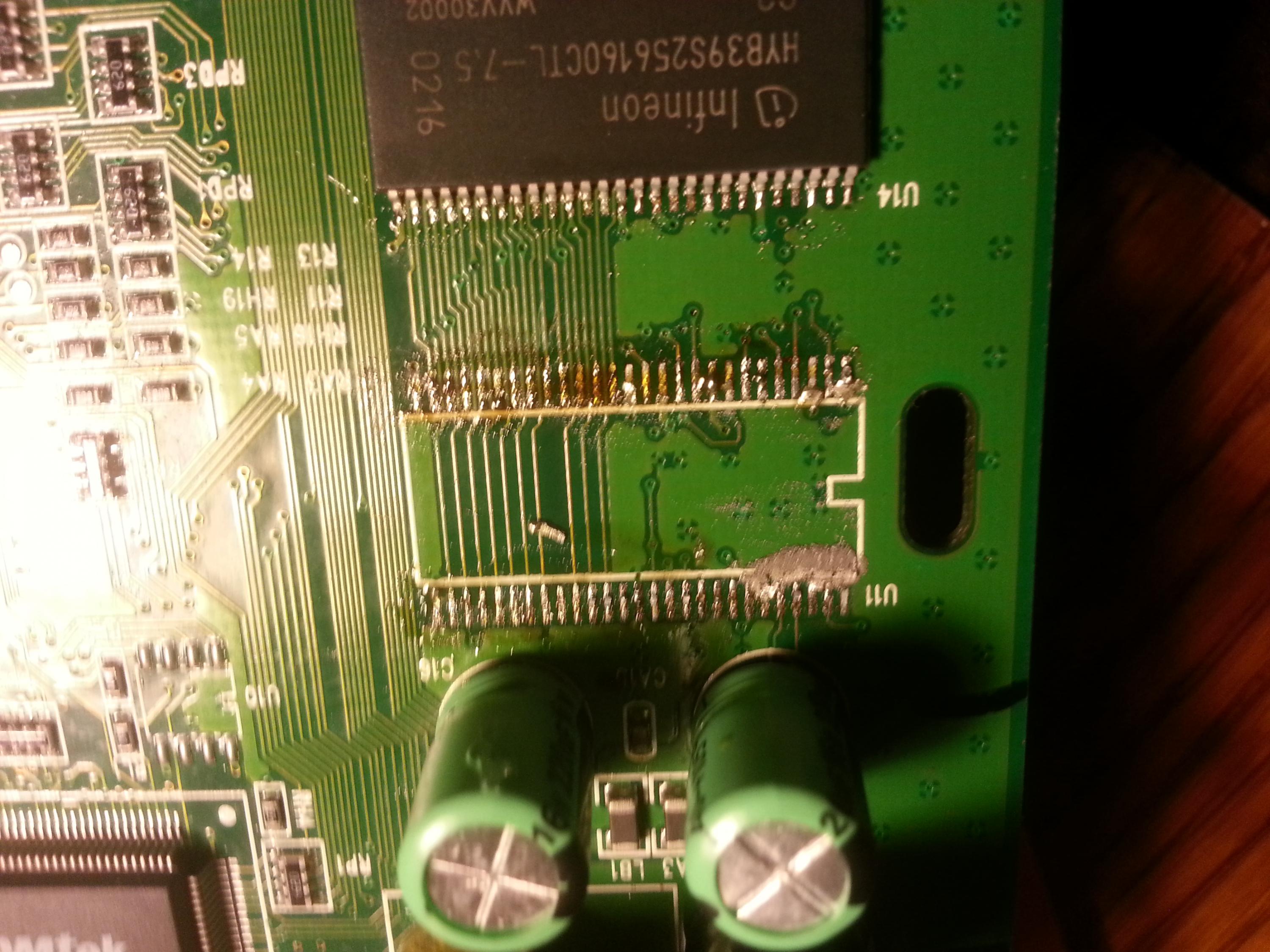

    I pulled off the second chip to see a smear of unmelted solder paste under the chip. I can see how paste masks could be useful.

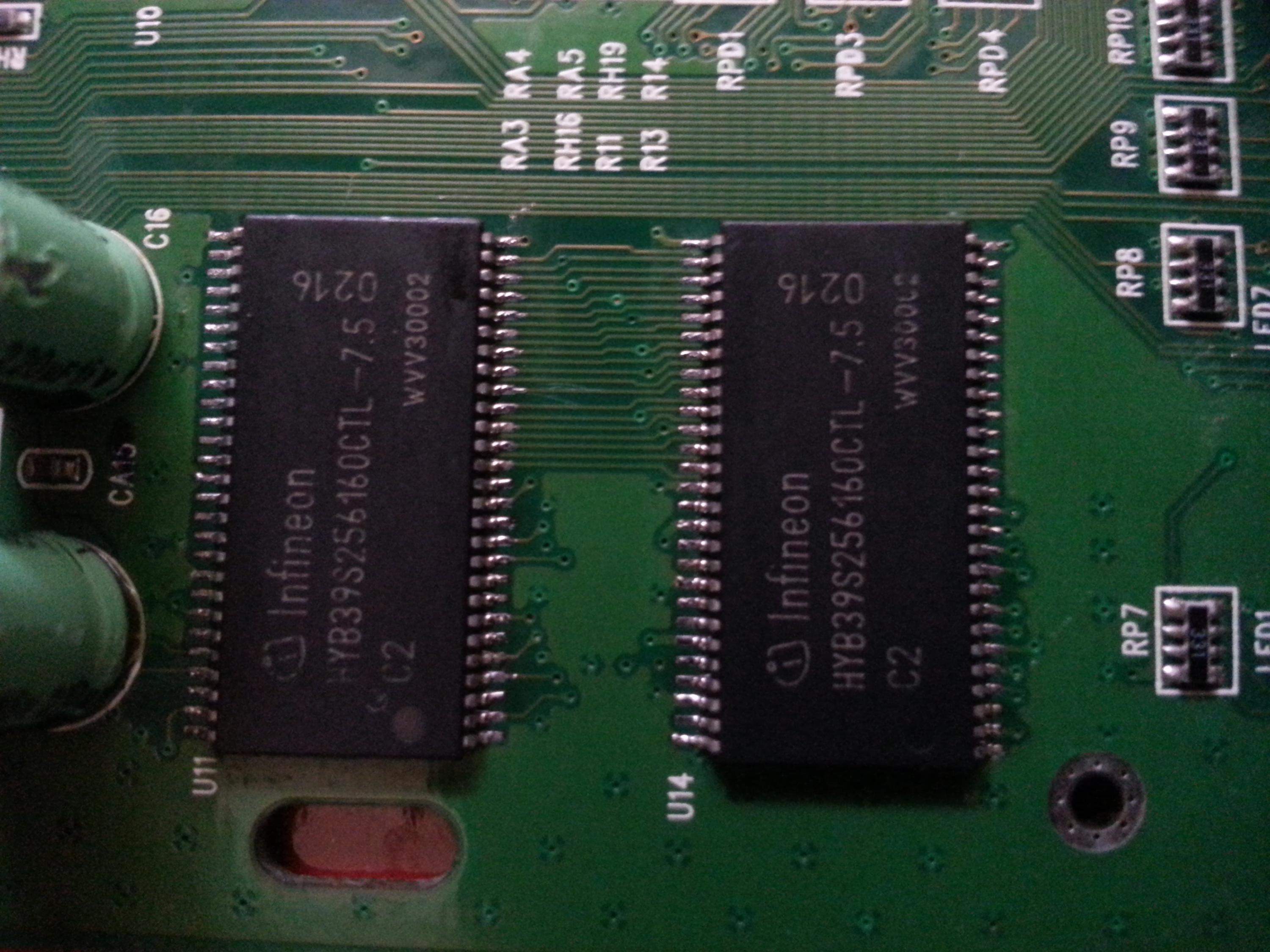

    Third attempt is looking much better I think. Do you guys see any dry joints? Everything look ok?

        I think you would get better results drag soldering those ICs with an iron, and less chance of getting solder balls under the chip.
        For hot air to work well there I'd say you need better paste with better flux and dispense it with a syringe. That cheap eBay stuff is junk.

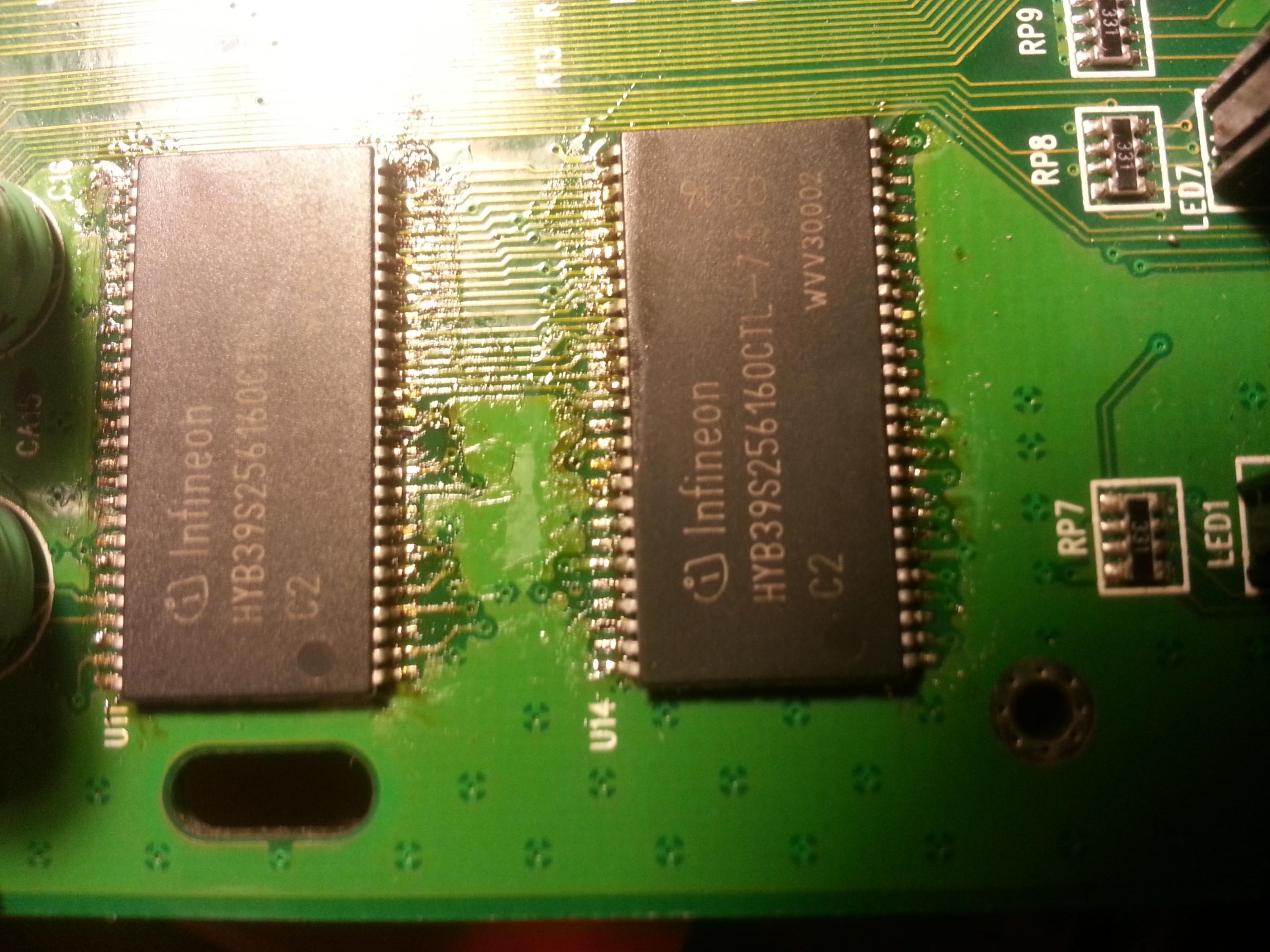

              Well, do my joints look horrible? Last pic was my latest attempt. It certainly doesn't look factory made, but I wouldn't expect that.

                Last pic isn't too bad, but you'd have to clean the flux off for us to see better.

                  It's hard to tell. Flux needs cleaning off as Th3_uN1Qu3 said, and the picture is not clear. But it looks like some leads are missing solder.
                  Check here: http://store.curiousinventor.com/gui...Soldering/QFP/ for examples of good joints on gull-wing SMD leads and inspect yours and compare.
                  The biggest factor with hot air\oven is the uniformity of the solder paste. Syringe is better, stencil is best.
                  Personally I don't use hot air for that kind of package. Doing it by hand is easier to get good results.
                  Another thing: With SMD you can never have too much flux, but it's always easy to add too much solder.

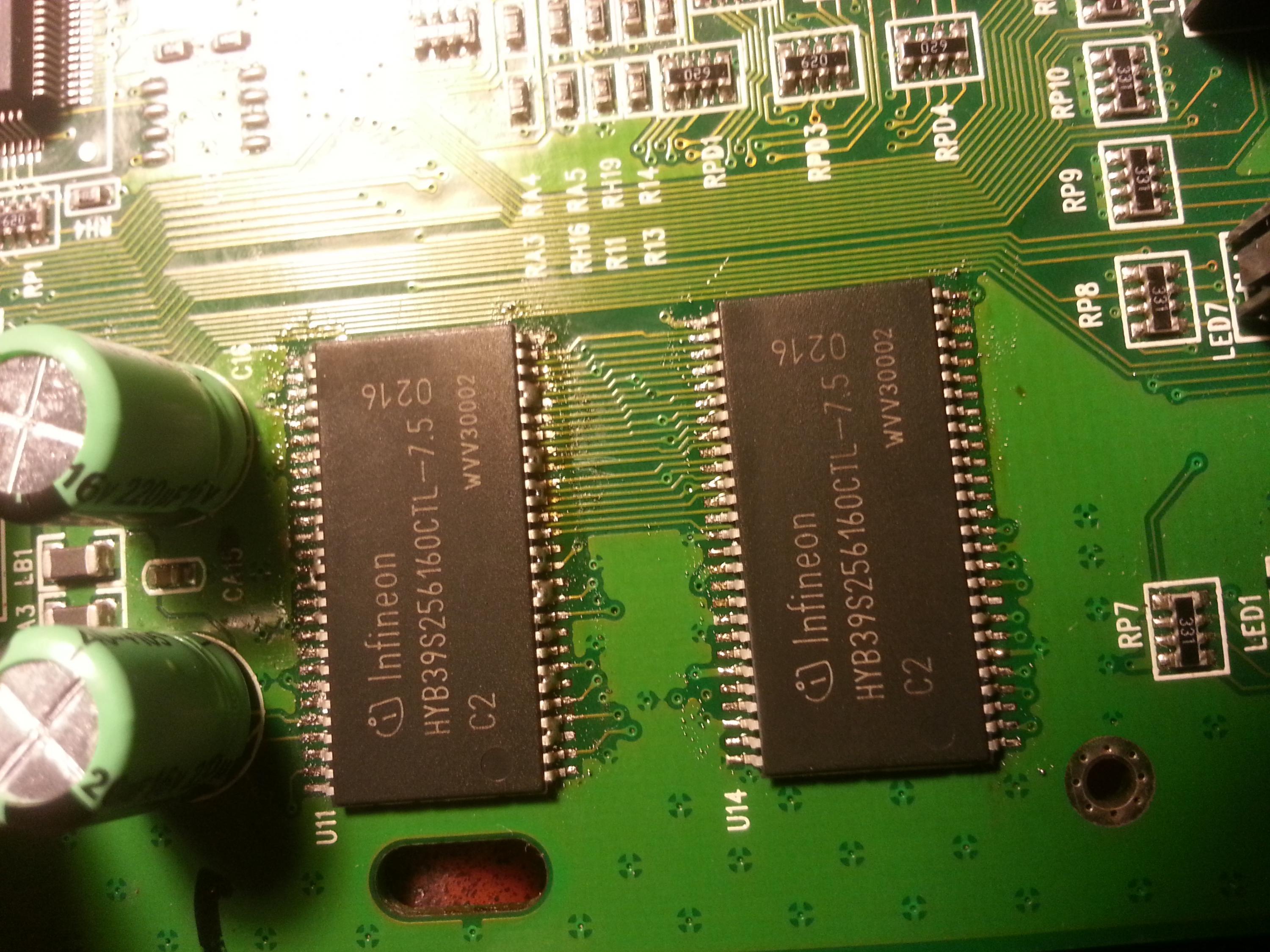

                    I finally got to the store to getbrake cleaner. Here is an updated pic, there are some strings from the cotton swab. I think I see a few dry joints, but overall not too bad.

                      Those do look pretty good compared to the previous ones

                        After tune up with a lot of flux and too much solder. Not quite flood and wick, but in some places, close.
                        In retrospect, a little more flux before application of paste may have helped. Also, the clone hakko tips have really awful recovery time. On the plus side, its a cheap way to try out some tips and figure what you would actually use.

                          They look real nice now - does it work?
