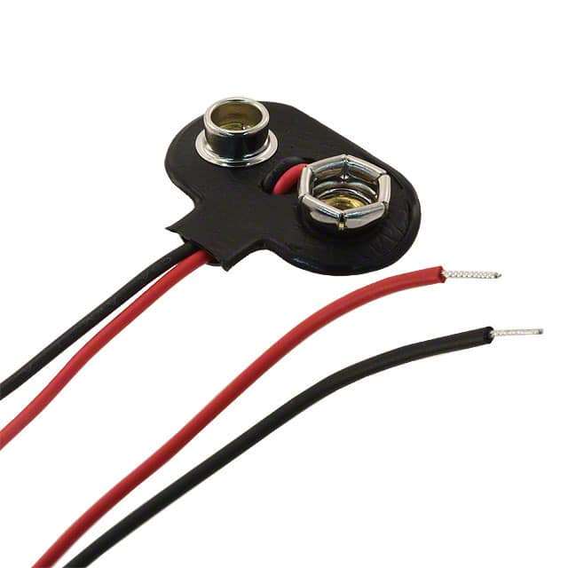

                        Let me say from the outset that you are correct in your conclusion that the battery is bigger.
                        However, the conclusion is incomplete, but the issue was finally resolved. Here's all the pix:
                        When I saw your response about battery size, I compared the Enercell battery with one of my Duracell batteries (just purchased a couple of days ago). As this pic shows, the Enercell is actually about a couple of millimeters taller than the Duracell. This, coupled with the wire bulge in the cell connector, is the reason for the difficulty. (BTW, as I write this, I noticed the Enercell is also thicker than the Duracell by a millimeter or two. The Duracell size would possibly mitigate the clearance problem I addressed earlier.)
                        But, without dealing with the cell connector, the battery still would not fall out, even while shaking the meter and banging it on the desk.
                        Taking the battery out and examining the bulging cell connector (as in the previous mechanical exam). (Yes, I had to use my angled pick to get it out, as indicated by the scratch on the Duracell but it was better and easier than removing the bigger Enercell.)
                        With a straight pick, I shoved aside the wire inside the insulated connector, away from the terminals.
                        With the batteries back in the compartment, finally, the Duracell began falling out, consistently.
                        Conclusion:
                        The battery removal issue was caused by not just the size of the battery, but also the bulge inside the insulated cell connector. A few millimeters matter a lot when it comes to tight spaces.
                        While it may be possible that some sold meters may not have this problem even at the outset, this mechanical design deficiency actually occurred even with the Duracell battery and, in my opinion, still must be dealt with.
                        So, if the battery clip could somehow be made to be slimmer, this would at least mitigate the problem. Use a film circuit with terminals or something with wires attached at the end of it instead of bringing it inside the insulation over the terminals, that would be my suggestion.

                            A better parts selection would have avoided this issue. Well, it's not really an "issue", some people may actually prefer a "snug fit" not having the battery rattle inside.
                            For example using this instead: http://www.digikey.com/product-detai...235K-ND/303806
                            PS. The battery standard size is H: 48.5 L: 26.5 W: 17.5 .. you might find out both are within standard.
