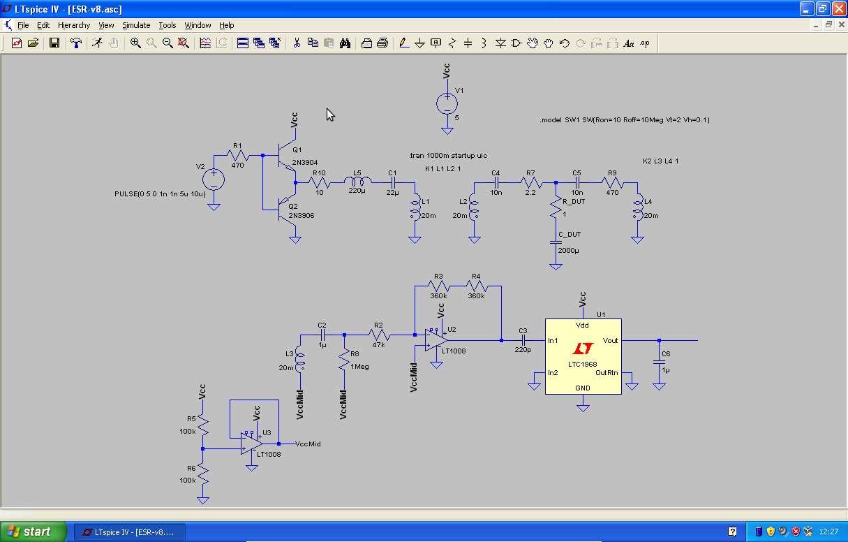

                                Re: My new "Blue" ESR tester
                                I haven't tried to build one myself but I have designed one and simulated it in LTspice. But the real world is the only true test. There are obviously lots of differences when it comes to making something in LTspice actually work - as I have learned myself.
                                There are millivolt potentials which are very sensitive to things like mains hum and offset errors of op-amps so it's pretty precise work.
                                I think Bob's meter uses a completely different design, though I don't understand it myself. The one I have designed uses a true 100kHz (well, 96kHz) sine wave, at +/-100mA (about 71mArms.) The penalty you pay though is the battery consumption is about 90mA, so the meter should use AA's for long life. But if you need 5V, that means you need at least 4xAA (6.4V max), but then you only get down to 1.3V/cell (assuming a 5.2V cut out) so most of the energy in the cells is wasted. More cells, lower cut out per cell, but 6xAA takes up a lot of space.
                                The idea of this design was to measure as low as 1mOhm with 0.1mOhm resolution, with a good meter (not a crappy DT830B, but any meter with a 40mV DC scale or >=10,000 counts on DC mV) it should be possible.
                                Also it's AC coupled, so you can touch a charged cap across the terminals (up to 800V) without fear of blowing up the meter.
                                  That is cool. Why don't you market it? We can never have enough test equipment.

                                      #38
                                      Not enough time, money, motivation. Pick any two.
                                      I may do it as a project at a local Hackspace if I get some time. I can build it on a PCB.
