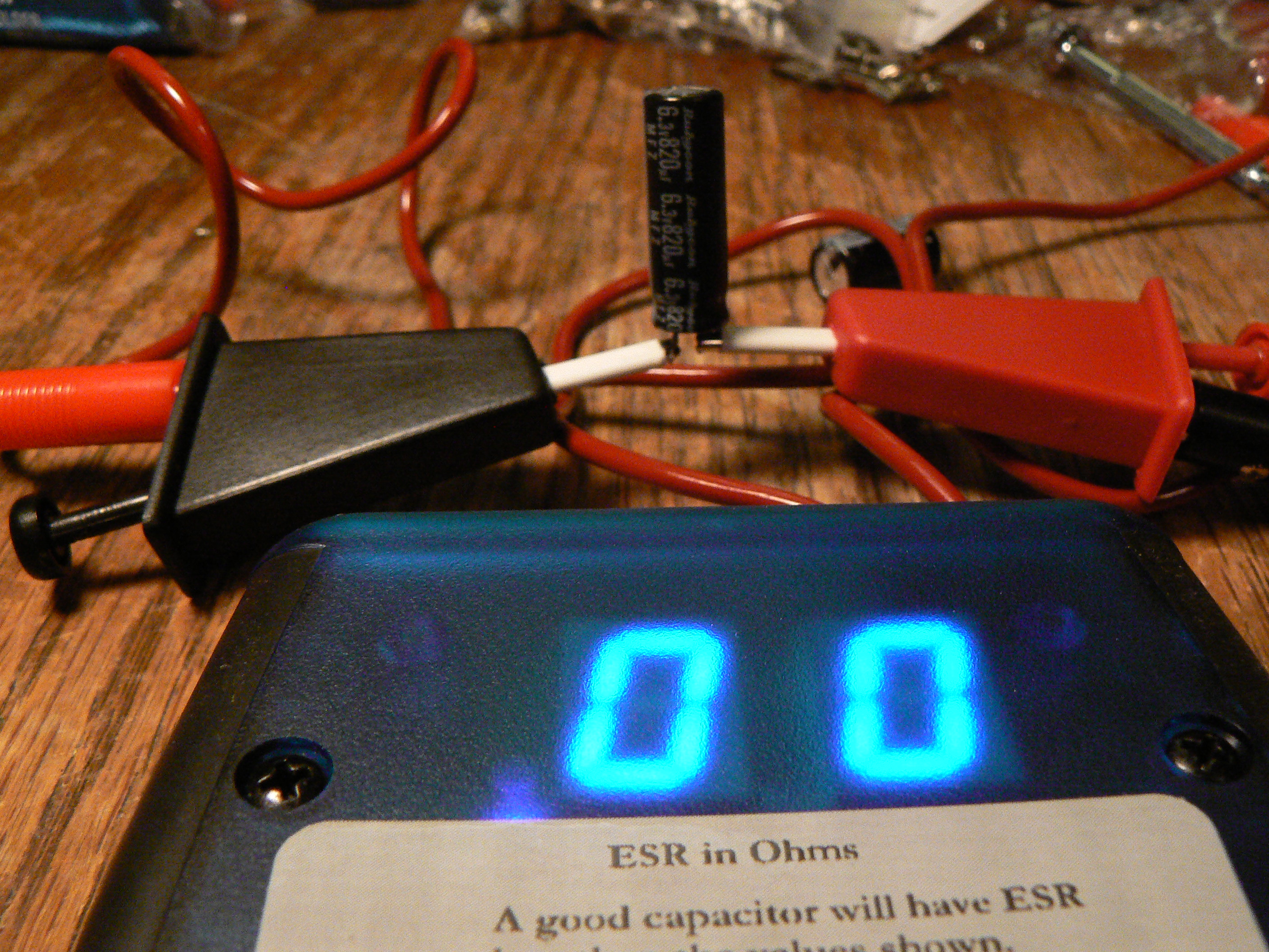

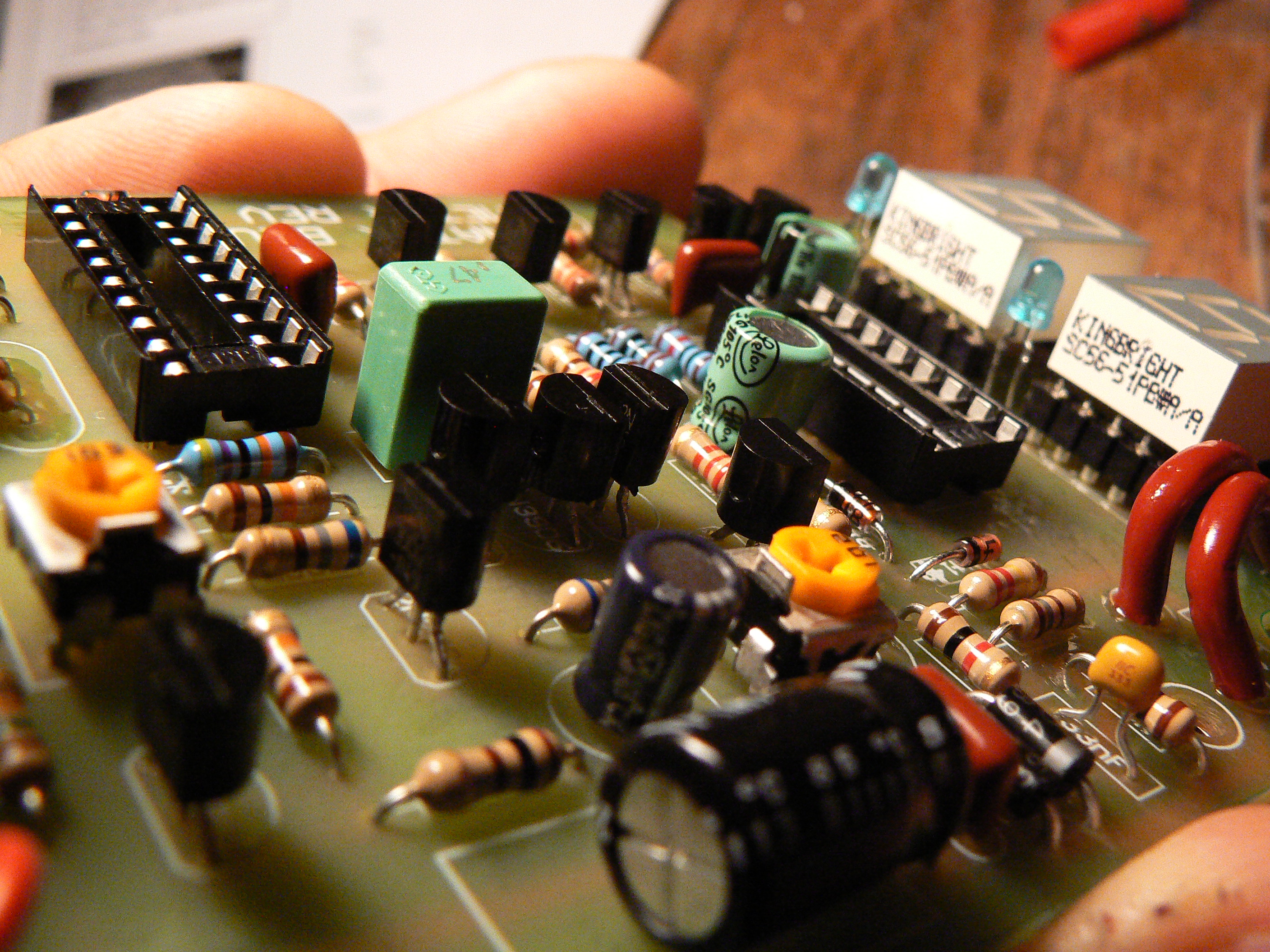

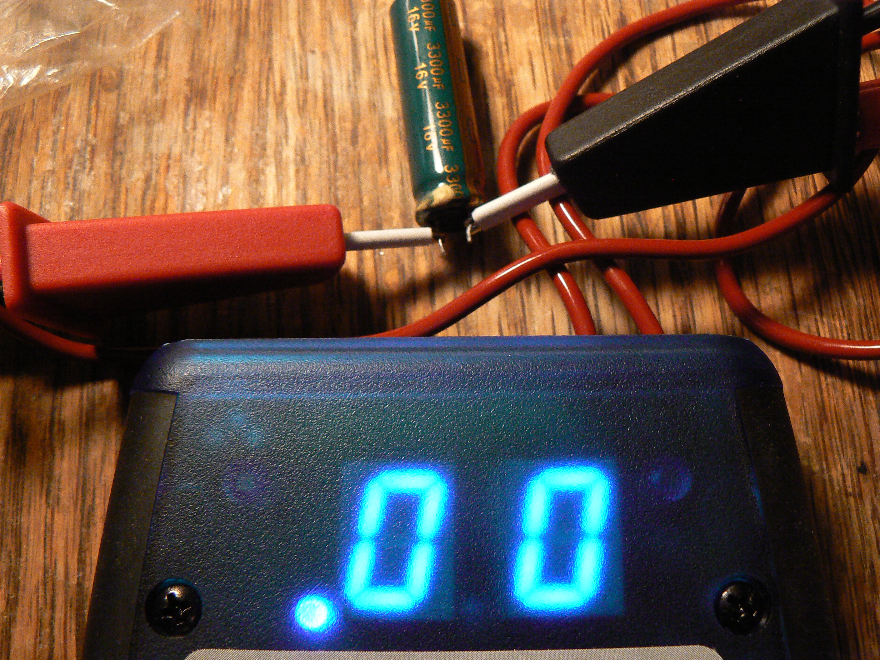

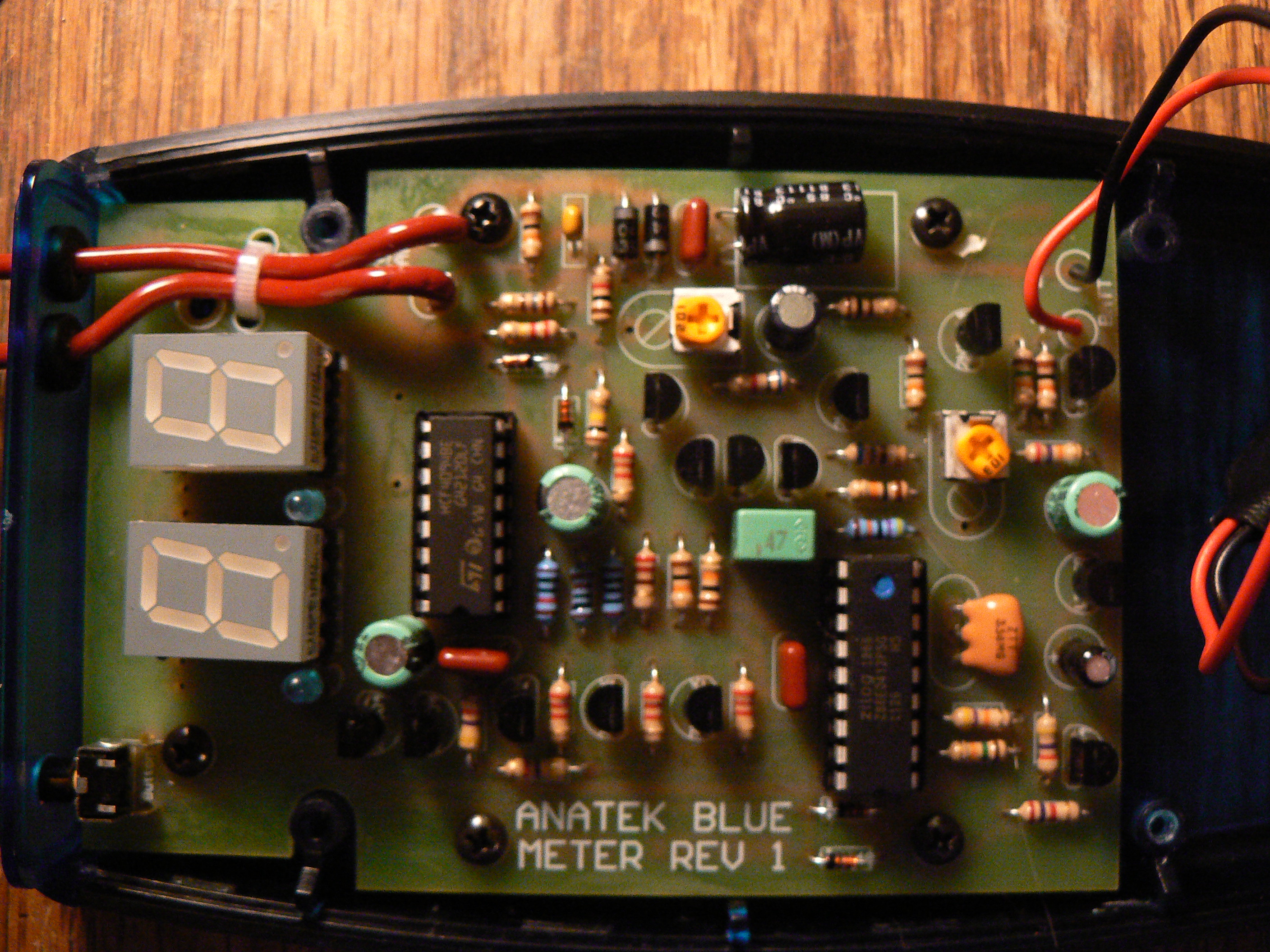

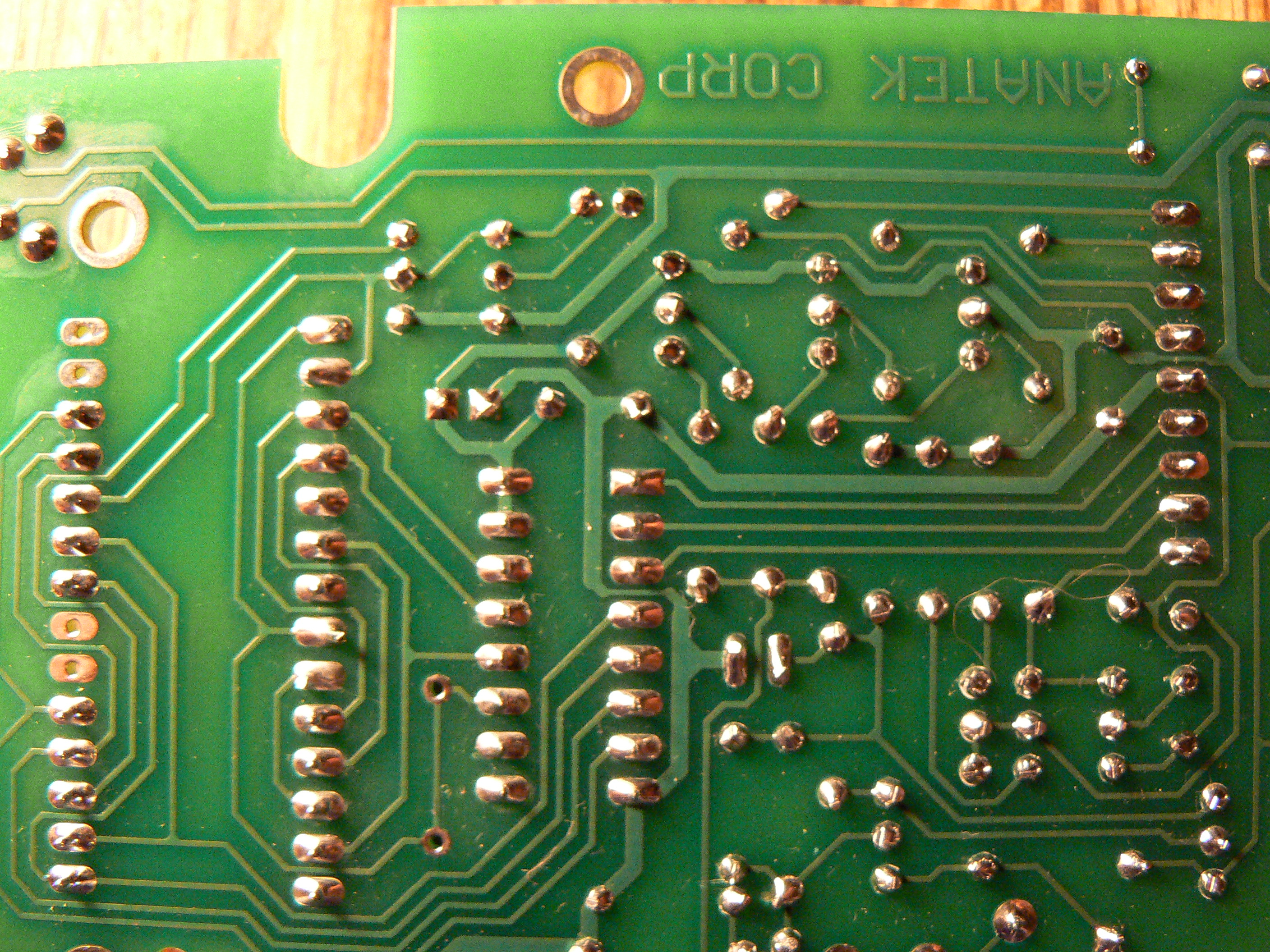

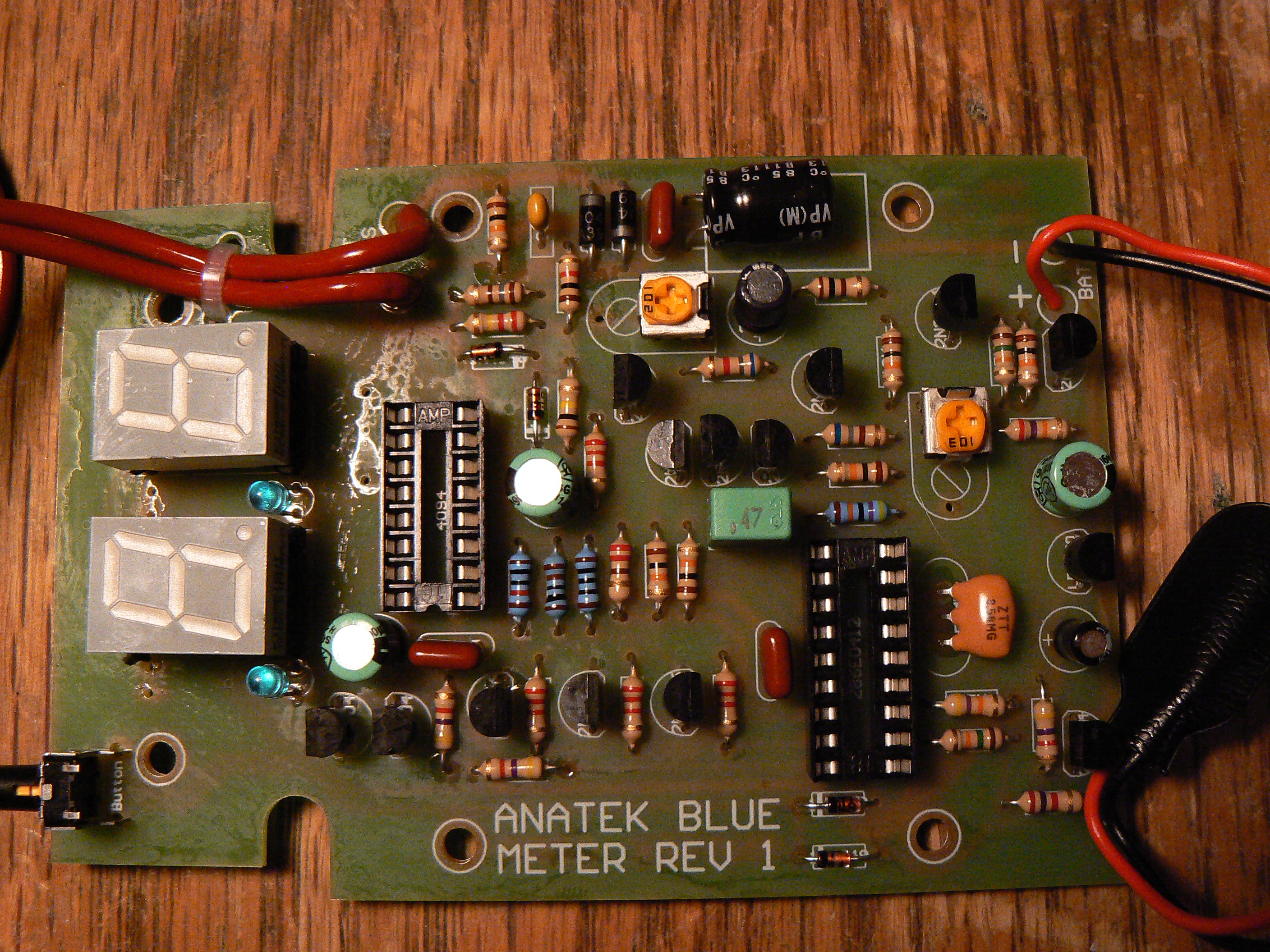

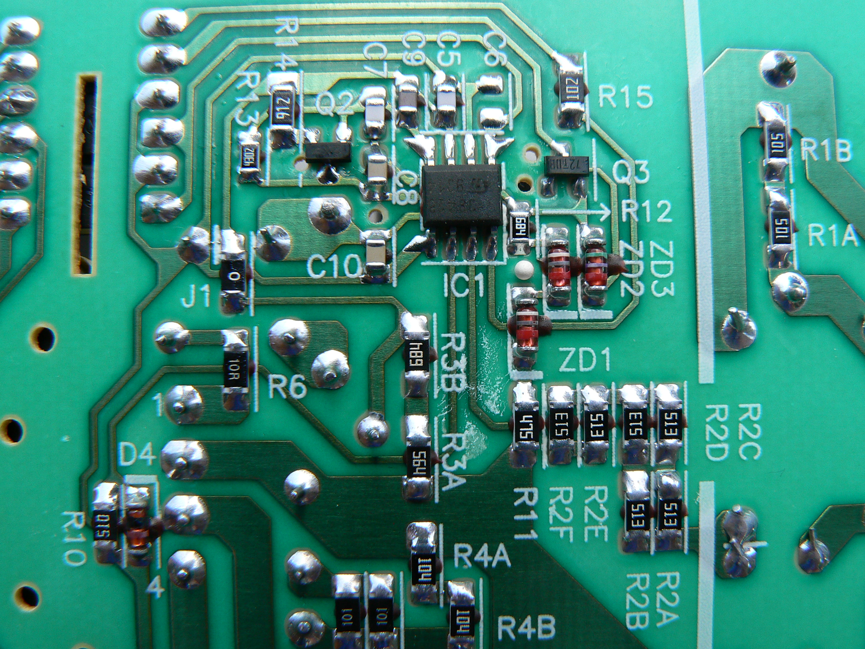

    I have just finished building my “Blue” ESR tester. I had read some of the threads here about it before purchasing and I was not sure what to expect. Apparently someone paid attention to the complaints that I had read about and corrected them. Mine seems to have good capacitors not real sure about the “Lelon” brand but they had good bungs, Nichicon and Panasonic were the other brands. My casing screws, not snaps together and has a battery compartment door so you do not have to take it apart to replace the battery. It passed the calibration test without me having to adjust the calibration trim-pot. I was really impressed by PCB, the components were well spaced and the silkscreen was crisp and legible. You may notice in my pictures that I managed to mount the PCB to the wrong side of the housing. I have since corrected it but my sticker is now on the back.
    I have been saving some capacitors to test for when I got a meter, and I have to say that some of the results surprised and confused me. Most of the tests came out as expected. The swelled Rubycon that read .00 seems strange. The big 3300uF 16V Teapo looks fine, and tests .00 Ohms. I had read these are junk so I just expected it to be bad. The Fuhjyyu are just bad, bad, bad.
    Anyhow, I thought I would share my experience and see what kind of advice or pointers I could get about using an ESR tester. I also am trying out a loaner camera that I may purchase, so respectful feedback on picture quality would be appreciated. I know my lighting needs work but there was no sunlight at the time.
    Thanks.

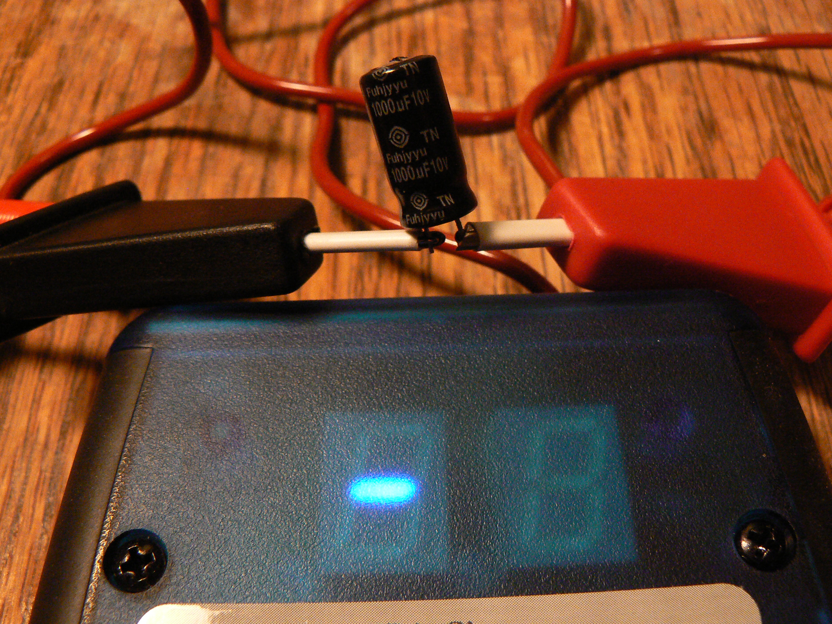

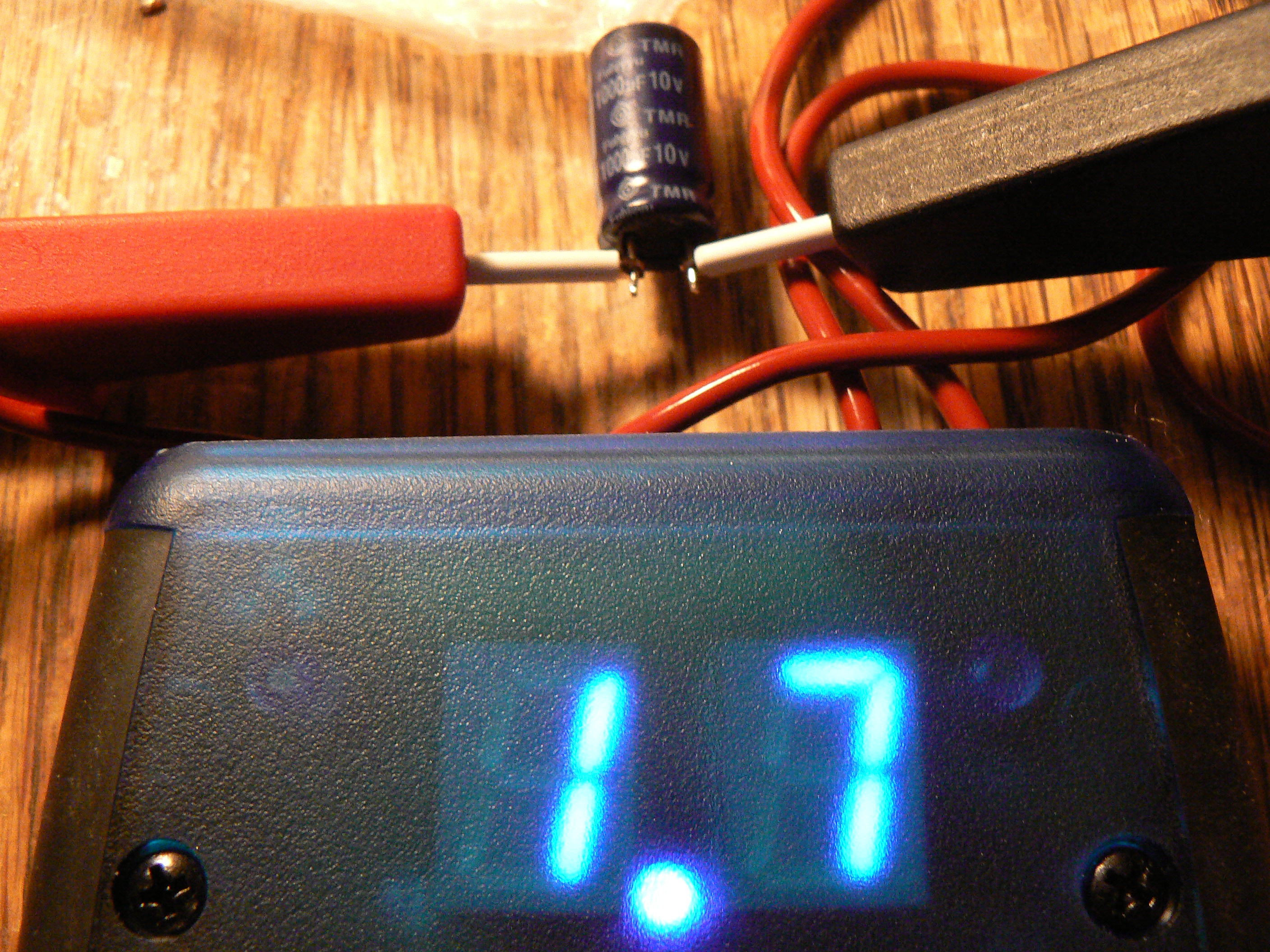

    This meter can do .xx Ohm (two decimal points) resolution?

      Too grainy for my taste. For our purposes, you want a camera with good macro mode.
      I have an old Canon A80 (taken probably over 30,000 shots) and you can see a sample of my shots.
      https://www.badcaps.net/forum/attach...8&d=1334360320
      What is make and model that you are evaluating?

        Feedback on the camera... Panasonic DMC-F27.... see a review here if you want to know the (more or less) expert's oppinion : http://www.dpreview.com/reviews/panasonicfz7
        Yeah, a bit too grainy. Might be because you didn't use the macro mode (if it has any)
        In regard to blue esr... it's a good meter but I sort of dislike that they still rely on old zilog microcontrollers and architecture as a simple reverse engineering block.
        Also, for a commercial product the pcb is sort of... meh. Looks like a FR2, the resistors and other parts are not aligned properly on the pcb, sort of sends me the "lack of attention" or carelessness feeling. Considering it's also targeted to do it yourself, they also could have done the pads a tad larger, there's plenty of room.
        On the other hand, I saw the documentation and I remember it was very nice, with plenty of detail.

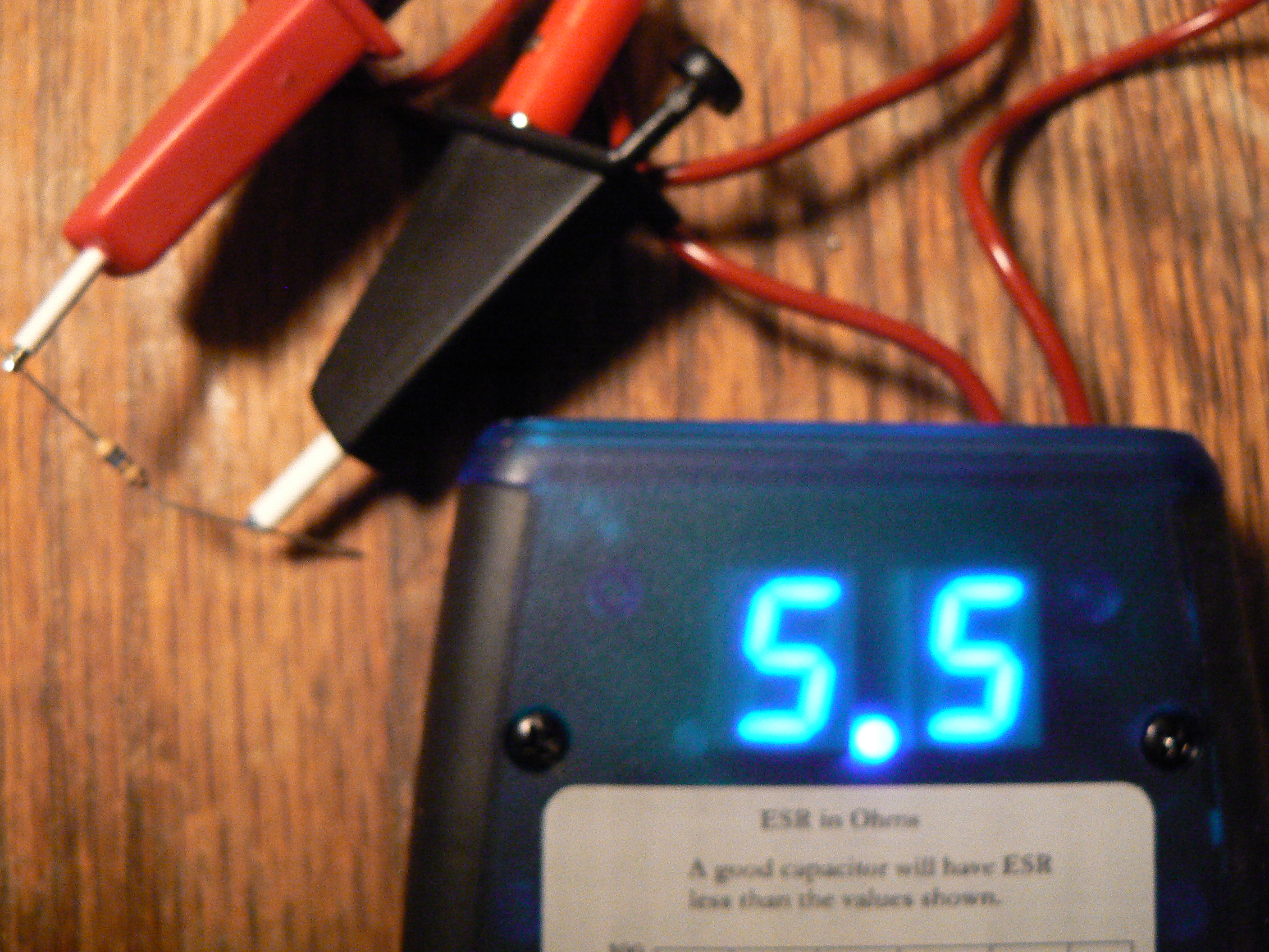

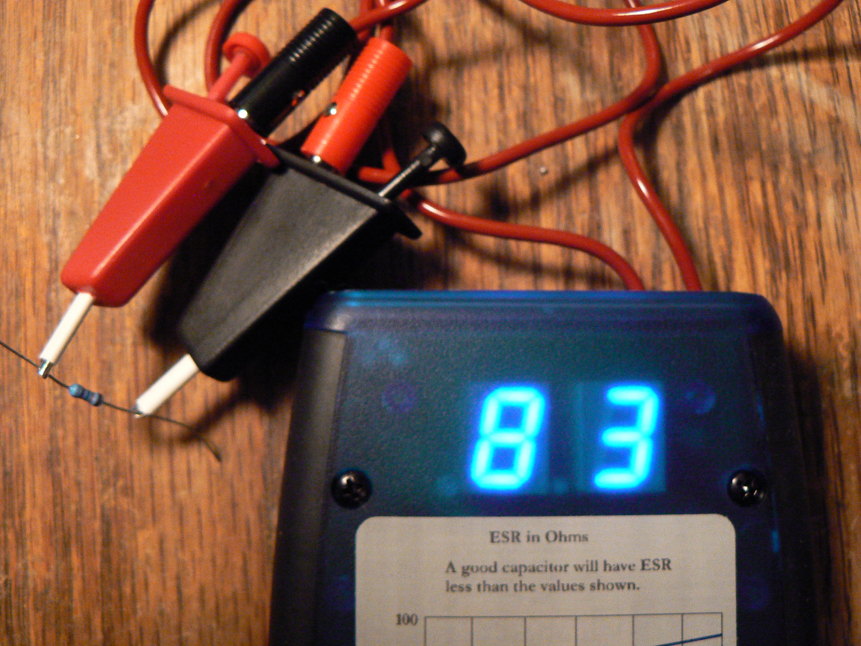

          I cannot attest to the accuracy of the readings, I am only going by what the display shows.

            To reduce the grainy appearance you will need to switch to a lower ISO sensitivity value, take it off auto and set it to 400 or lower. The downside is that you'll need more light to take good photos. Auto focus will likely work fine, you don't need manual.

              To reduce the grainy appearance you will need to switch to a lower ISO sensitivity value, take it off auto and set it to 400 or lower..
              The ISO was set to 400, but I will have to try the auto-focus. The owner was demonstrating his much higher-end model to me using manual focus, so I was just playing, monkey see monkey do.
              I am currently reading the link provided by mariushm, which is proving quite informative. I would like to know how he knew the camera model before I posted it.
                      Ok ,you spent 88$ at anatekcorp for it, for 99$ looks to come assembled.
                      Either way as the others commented all ready, it is very basic design with poor resolution.
                      You should do a better research prion getting it.
                      Do not get me wrong, but this looks as waste of cash to me.

                          Tom, I talked the RusMike here on the forum and got his ESRMicro 4.0 for a very good price.
                          It was 50 (dollars or euro, I don't remember now) without the case, but with a baggie full of spare parts.
                          The Blue ESR banks on Bob Parker's reputation to sell - the most expensive stuff on that meter is probably 3-5$ for the case, overall all the parts aren't more than 10$.
                          To sell it for 88$ in kit form is just... I mean they probably just bought everything in volume to get low prices, otherwise I can't explain why they'd still use such old mcu.
                          Why use a 1$ Z8 18 pin mcu when they could just as well used a 1.5$ 28 pin PIC or AVR and drive the display straight from the mcu (saving on an ic and socket and a few transistors) and make the design simpler, possibly by using 2-3AA batteries with a regulator down to 1.8-3.3v for the mcu, instead of 9v dropped to 5v.
                          It's old and complex for today's standards and too expensive for what it brings.
                              For a while now I have been drawing and etching my own PCB boards so compared to what that involves, having a pre-made, silk-screened, and solder masked board was a luxury. I usually use much smaller pads, pack my boards denser, and I probably break every engineering rule known to man in the process. From my home hobbyist perspective it was better quality than I was expecting,

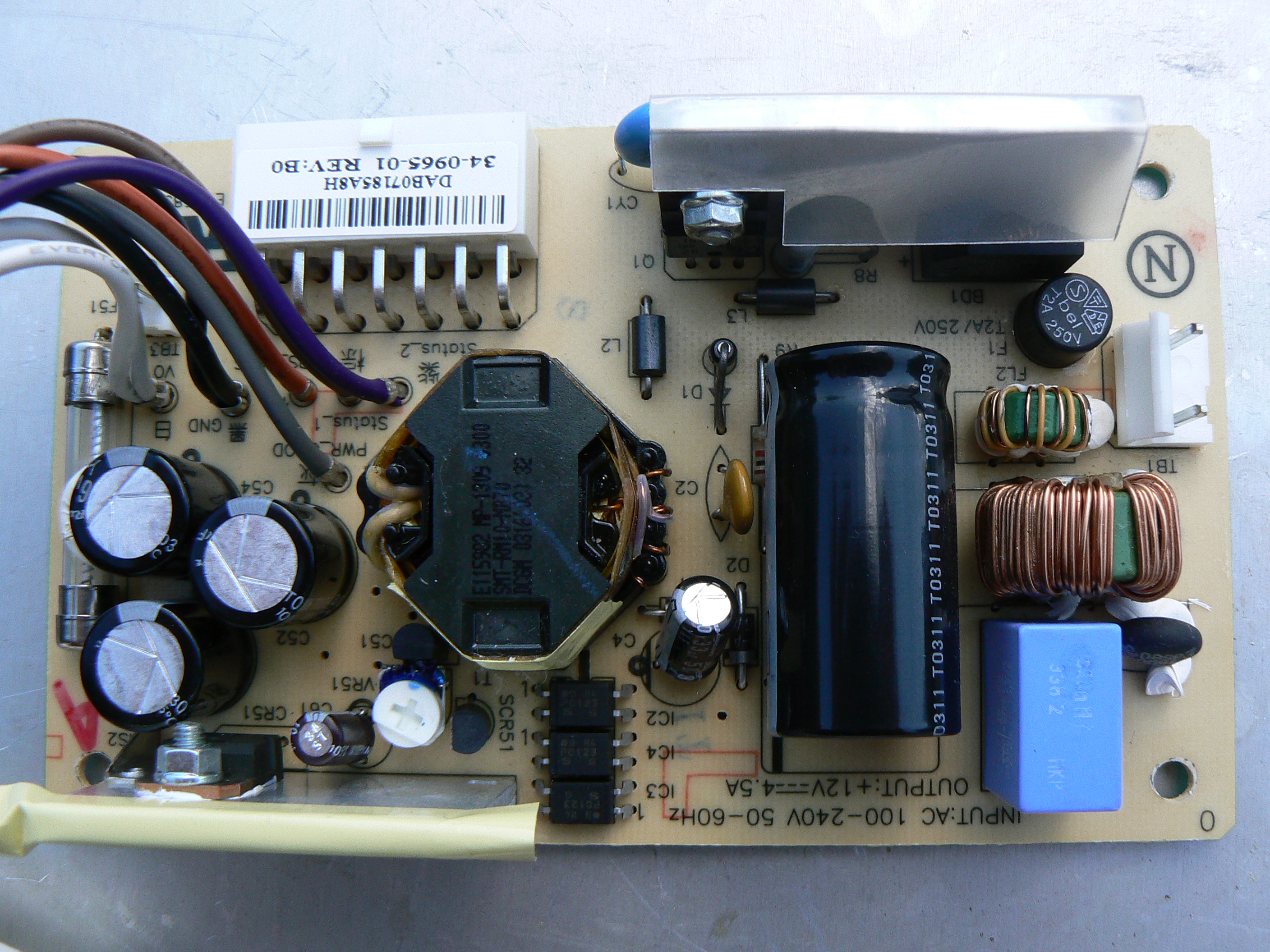

                                Originally posted by LDSisHere

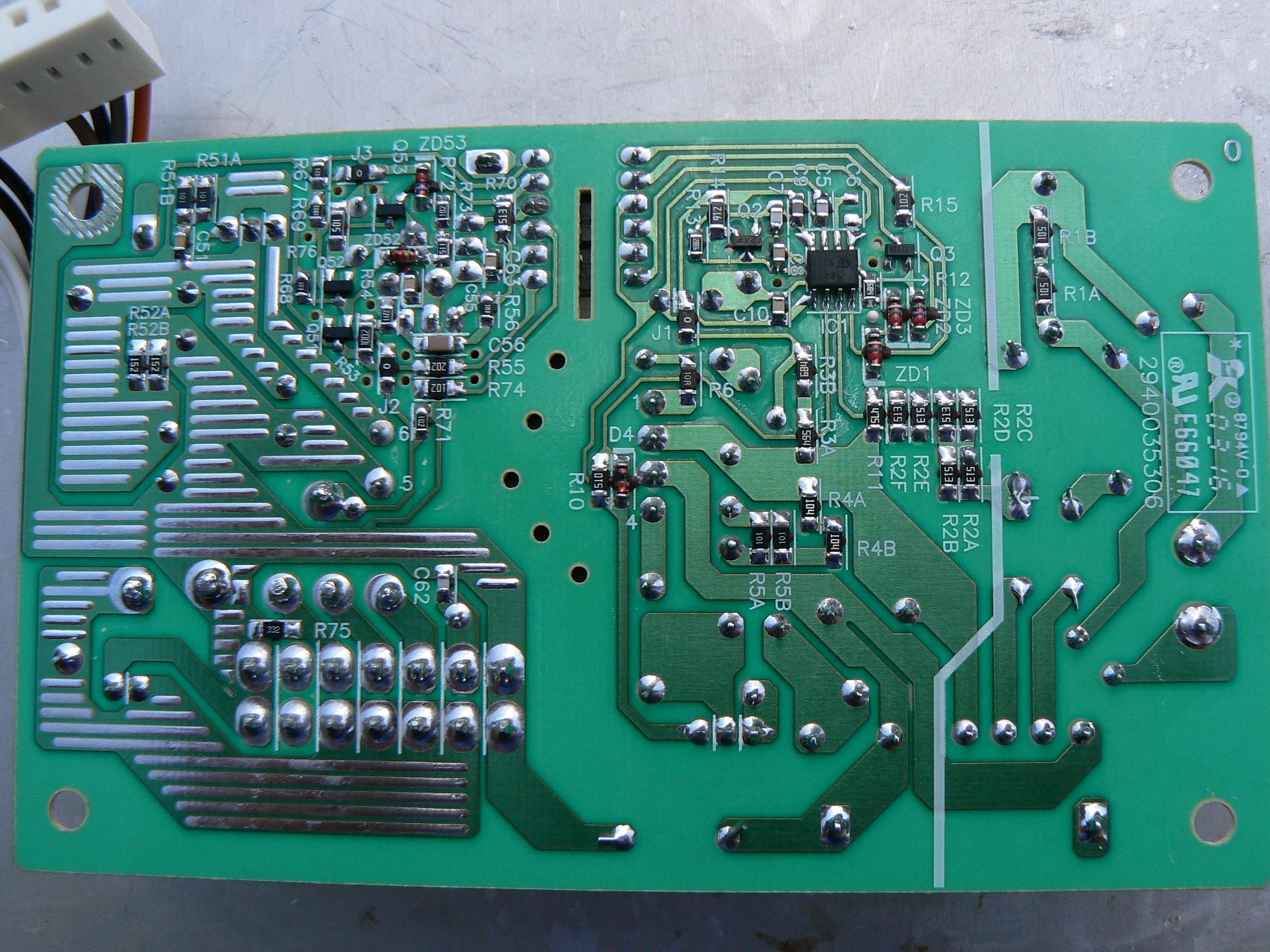

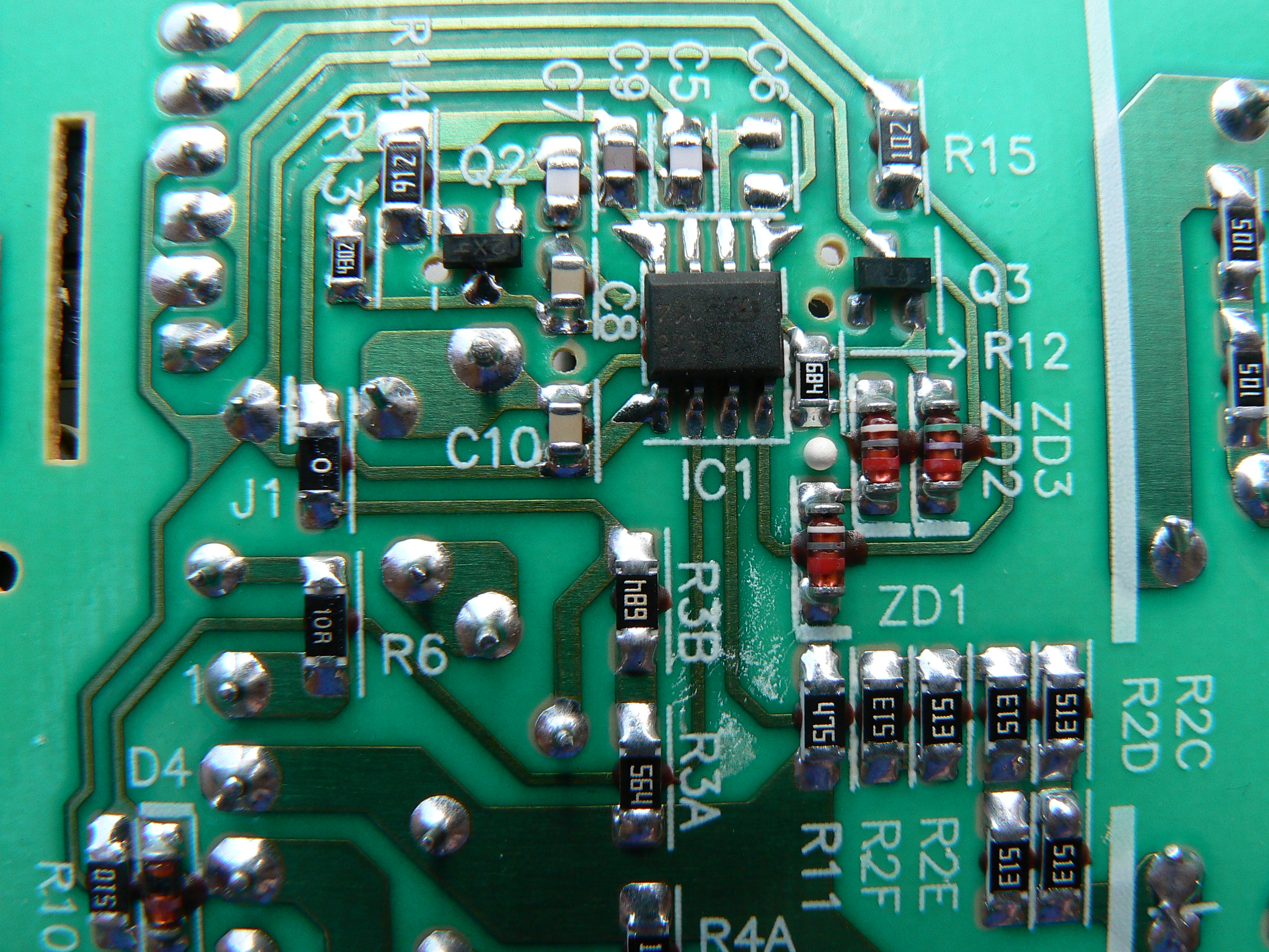

                                To that end I am posting some pictures using 100 ISO and auto-focus of a Cisco power supply. (It was handy.)
                                The ISO 100 makes a huge difference. If selldoor were not on vacation, I think he would approve.
                                My own A80 is set to 50 ISO so I'm used to seeing something slightly sharper.
                                One retiredcaps bonus point for a picture of the Cisco power supply out of a Catalyst 2950. Nice to see Rubycon caps in the enterprise class workgroup switch.
                                  Thank you, thank you, thank you. This is what I was wanting to hear.
                                  This one has an 80 ISO setting but the review I read had some negative things to say about it so I just tried the 100 ISO setting. I will do more experimentation as I get time, at least I know it is worth keeping for now.
                                  The mainboard has good caps also, this device is from the early to mid 2000's. I actually intend on starting a thread on it very soon, I just was not going to bother until I could get decent pictures to post.
                                        I have the same meter. Yes, lowest readout resolution is .01 ohm.
